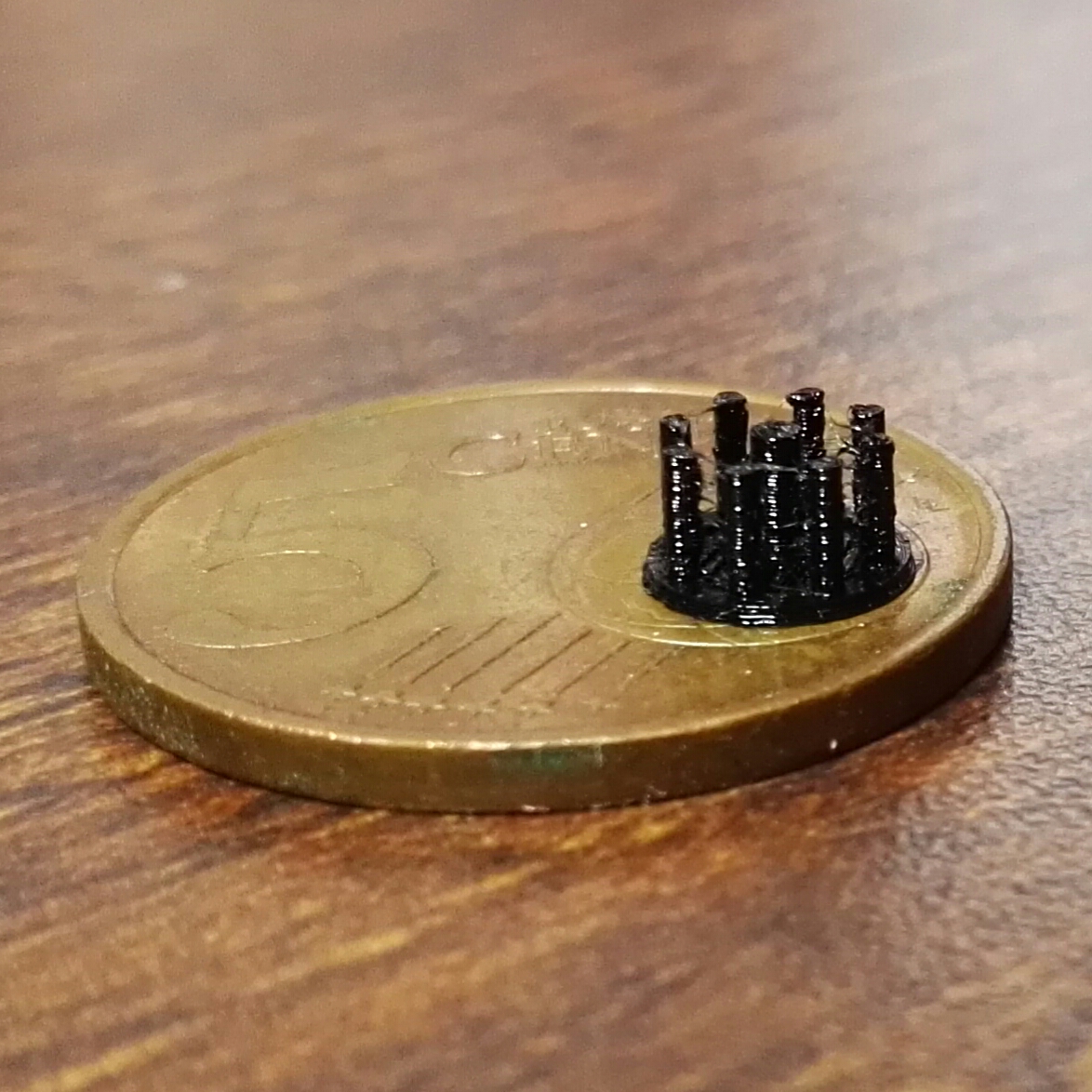

I wanted to start printing smaller parts for one of my projects, so I ordered 0.25mm nozzle from E3D(I designed my hot end so that I can use them). It’s right in the picture. Left is one I made by myself and it’s 0.45mm.
I ran about ten calibration prints and was able to print with pretty good results. I was curious about how small parts I could really print, and scaled down my retraction test.
This part you can see does have bottom diameter of 6mm, 3.5mm height, and small piles are 0.75mm in diameter. This was first try to print parts this small, so I really didn’t tune it till the end and I was still very impressed to the result. It would be better with more cooling etc.
I ran to few problems with nozzle this small. Filament flow is so low that at first it jammed several times. I increased temperature and speed so jamming went away. Also bed needs to be exactly at correct place when print is starting. Print is PLA, 0.1mm layer height and printed at 215 degrees of celcius.
