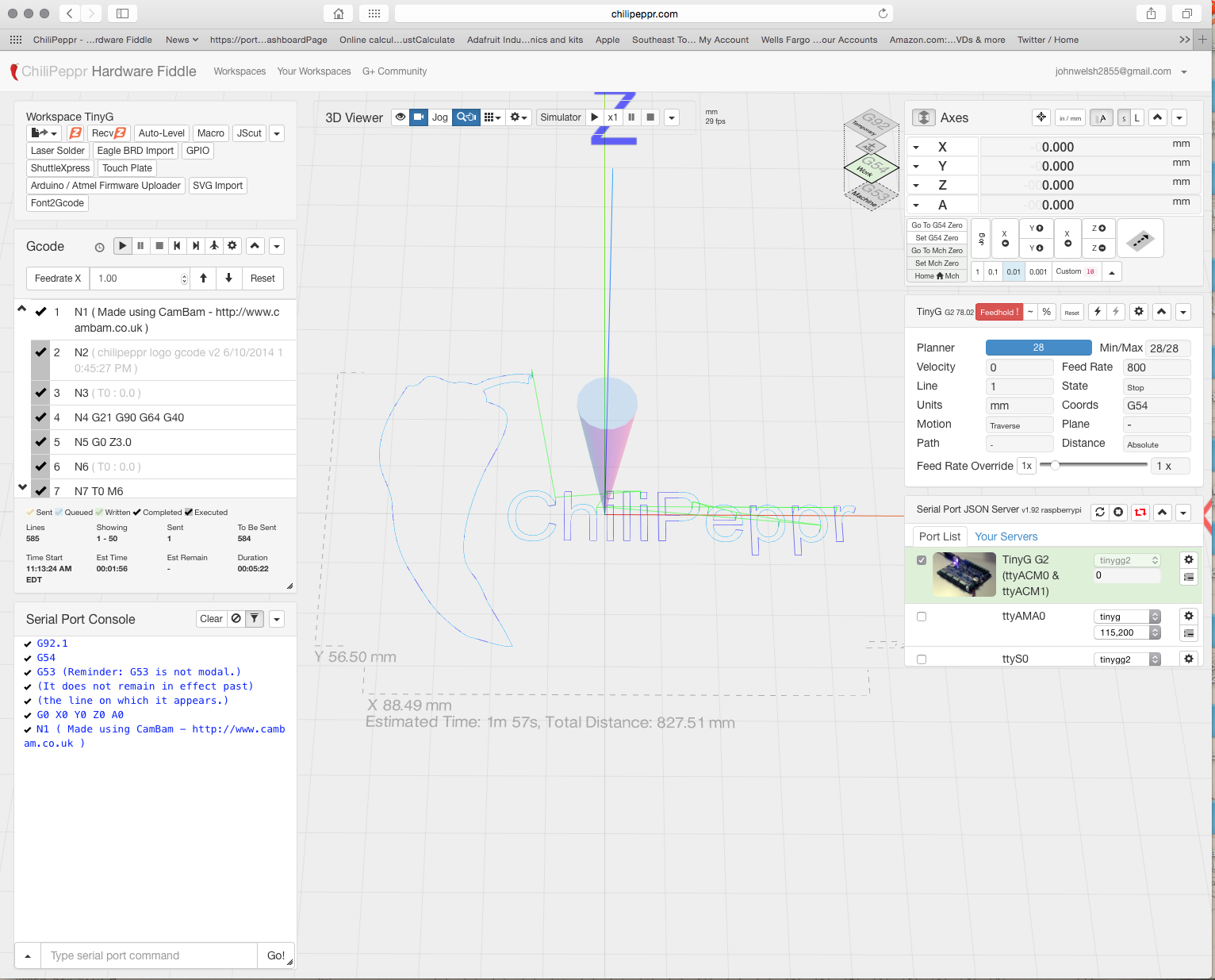

I was able to get everything working properly to the best of my knowledge. Thanks to all those suggestions. In the end I loaded serial-json-server on a pi 3 and connected the DUE to that. I still use my MAC as the Chilipeppr machine connected through wifi to pi 3. I re flashed the code connected and everything seems to work as it should. I have to build a machine now so I can see some motors move. Many thanks to the community.

I was watching the processor load on the pi 3 when it was running your sample g code and it barely cracked 2%. I think when I make my control box I will just include a Pi3. I am guessing some other handy tools may pop up to run on that pi.
