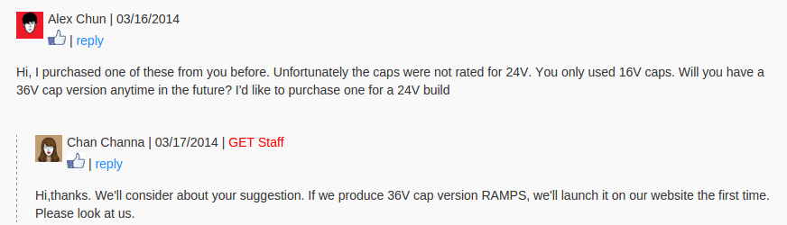

I was about to purchase the Ramps 1.4 board from Geeetech but then I read a comment that said the capacitors are not rated for 24 volts. Is this true and if so are there any cheap ramps boards that can be upgraded to 24v.
Some cheap ramps boards come with 36 volt caps on them.
