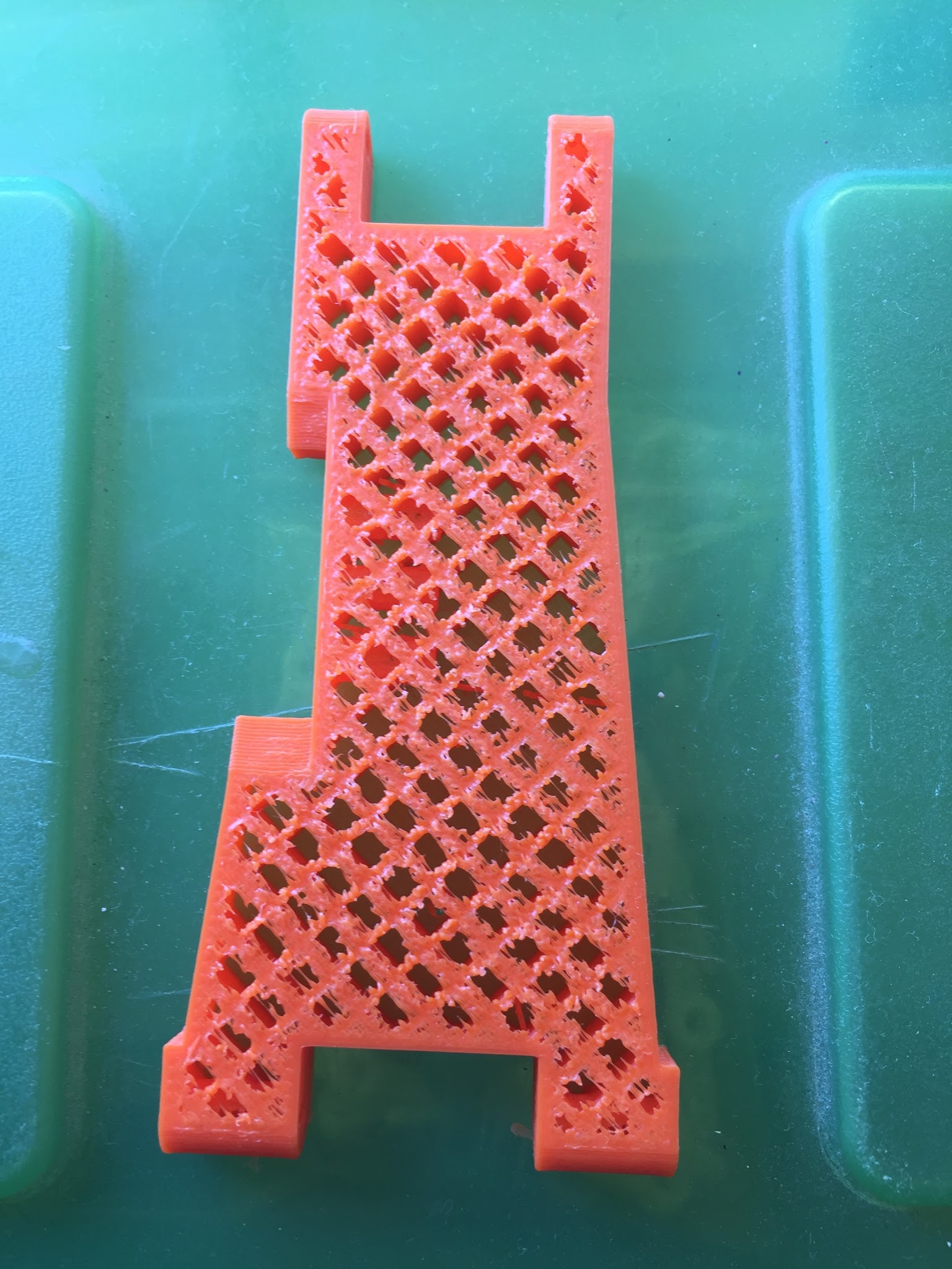

I was getting ready to start printing tons of parts for my SCT i’m working on, but i’ve run into a big problem. The top layer is pretty much non existent, and the bottom layer is very thin. The print settings where 20% infill/speed 60mms/.1layer height/ .2 bottom-top layer height. It has been happening frequently when using a lower infill percentage and i don’t get why?
PLEASE HELP…
How many top/bottom layers? What slicer/printer are you using?
The .1mm layer height is so thin, it struggles to bridge the tiny gaps on top. Double or triple the top layers and you will be fine.
On structural prints, you might stick to .2 layers all around but go with 3 layers on top and bottom at least. I recommend at least two perimeter walls.

I’m using cura and its on my wanhao duplicator i3. In cura i don’t see any options for changing how many top and bottom layers there are. Just how thick they are.
@Brook_Drumm So you’re saying i should increase the overall layer height to .2 and the top bottom thickness to .3?
In Cura, if you are using 0.1 layer height and you’re top and bottom layers are 0.2 thick that is 2 layers. I suggest you increase layer height to 0.2 and top and bottom layers to 0.8 thick (i.e. 4 layers) and use 3 perimeters. If that doesn’t improve things you may be under extruding, probably because the nozzle is blocked. I normally find poor print quality is due to under extrusion. A good resource is the Simplify3D trouble shooting page. Just google simplify3d and navigate to troubleshooting. It is written for the simplify3d slicer, but most of the solutions can be applied in Cura.

Thanks allot you guys! I’ll try out the new settings that you recommended, and hopefully I get something good:)
I tried printing the part at .2 layer height and .8 top and bottom, and it turned out beautifully!I have not had a print this great in a long time!

@Panayiotis_Savva I already fixed the problem, it didn’t have enough top/bottom layers. But thanks anyway
