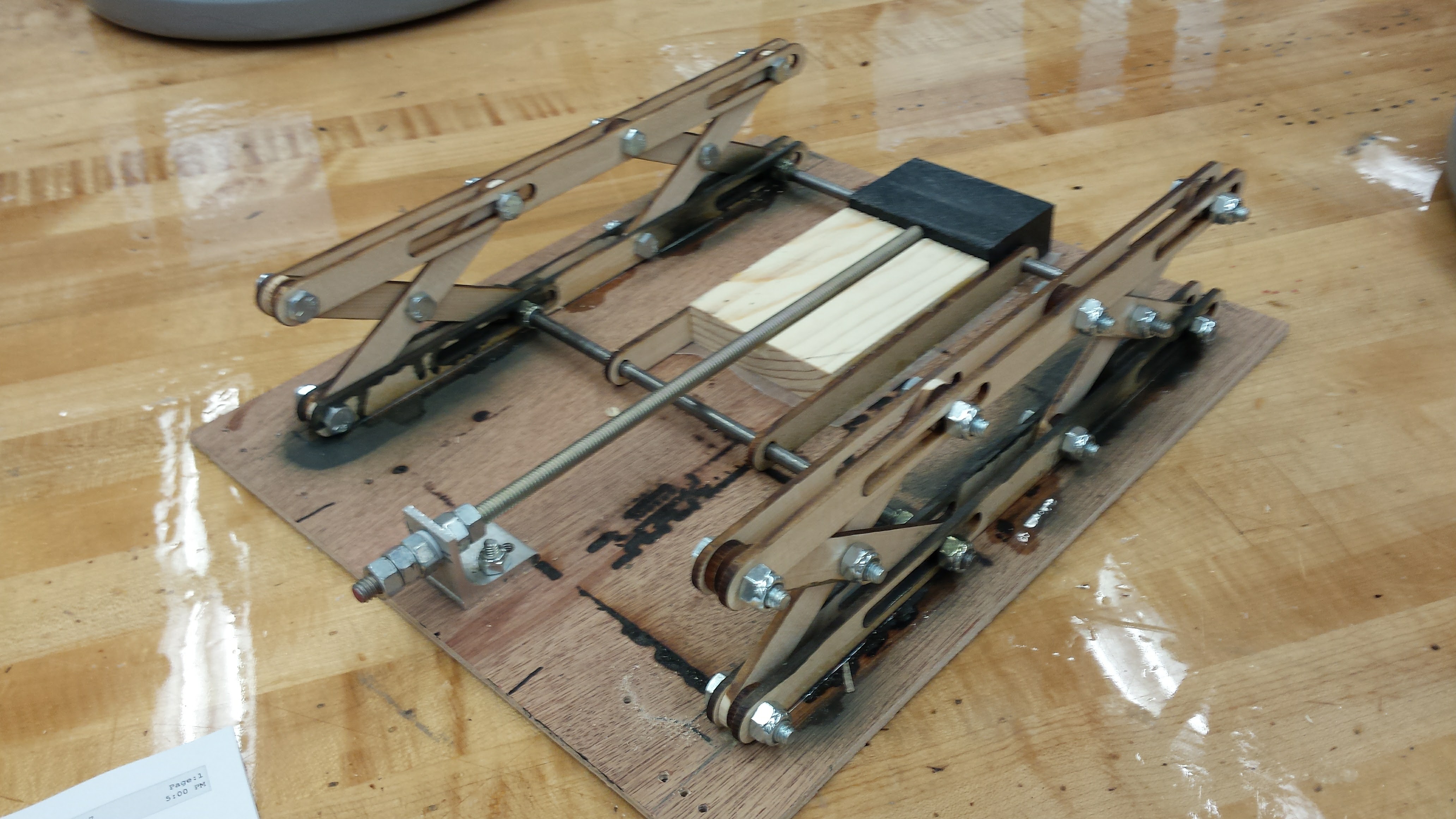

I was glad to find you guys n gals, I want to ask a question here that I also asked somewhere also. I have the K40 it arrived about 1 1/2 weeks ago but have not fired it yet as I knew that I would be making mods to it before using it. I have already installed a 3d printed air nozzle and now need to move the cutting table and that is going to be replaced with an expanded metal, I understand that the table cannot go more than 2 inches below the bottom of the nozzle what have some of you found to be a good way of remounting the table at the correct height?
most people make/buy some sort of adjustable table. Here is a picture of mine. I then mounted a piece of honeycomb on top of the scissor table. You will find many other examples in the forum if you search.
I just searched the community for “table” and came up with many examples. I really like @Ulf_Stahmer table design for simplicity
There is a company that makes them called LightObject. They have good and bad points but if installed correctly work well. Do a search here and on google or other for more info on like and dislikes.
