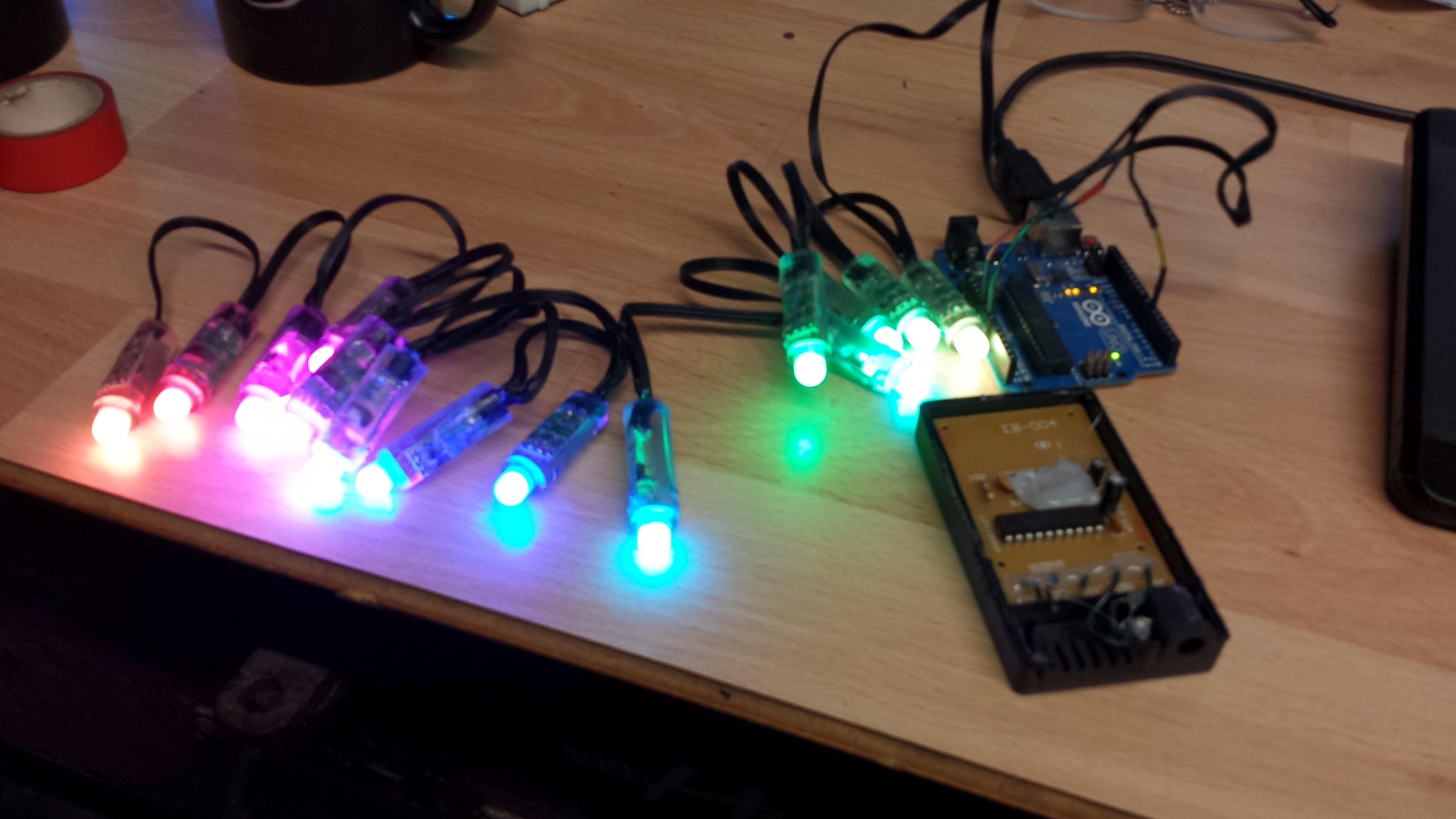

I was in town yesterday doing some Christmas shopping, and I stumbled across these Christmas LED lights in one of those temporary Christmas shops. £3.99 for a string of 15, 3 strings for £10, and they looked like the ones you can get on eBay for a lot more. So, I took a gamble and bought 9 of them! Got them home, and after some work getting the glue off the control box, found that it was quite straightforward. I couldn’t see the chips inside each pixel clearly, but a process of elimination and a hunch told me they were likely WS2811 based. Now I’ve cut the wires, wired them up to an Arduino UNO, and with some testing I’ve found that they are WS2811 running at 400Khz, so now I’m in possession of some nice and cheap strings, very happy :slight_smile:

How long were the strings? How many pixels?

There are 15 pixels in each one, but if you open up the last pixel you can string them together to any length. They came from Basildon, Essex, UK. The Christmas shop near Toys R Us for those who know the area. Funnily enough, they weren’t that popular with the “normal” shoppers! They had about 100 of them left on Saturday…
