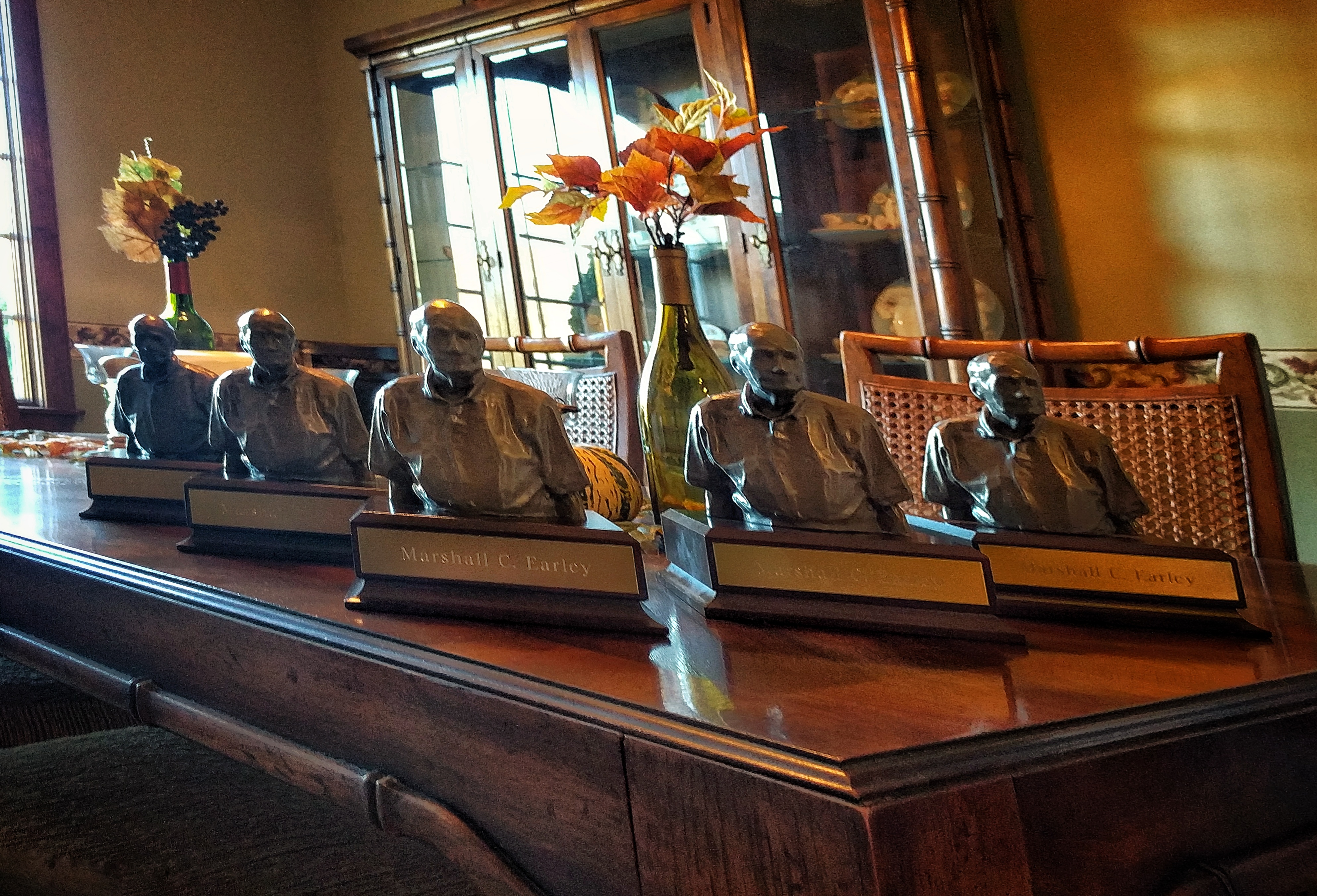

I was lucky enough to 3D-scan my grandfather before he passed away earlier this year. As a tribute and gift for my mother, aunt’s and uncles. I 3D printed the scan and then molded the print. From the molds, I created cold-casted bronze statues and trophy mounted them. Here’s the end results

@James_Nelson The scanner was a prime sense… Very similar to a Microsoft Kinect
Wow cool. I’ve used a Kinect, never been able to get that kind of feature resolution. great job. any details on software or settings/setup would be great. Awesome job.

How did you made the molds?
@Luis_Diaz I used a 2-part (A/B) silicon mold. There are a ton of you tube videos
@Loren_Brandenburg thanks! I want to make a necklace for my gf and didn’t know how to get started with this!
@Luis_Diaz http://makezine.com/2016/03/08/silicone-casting-molds/
