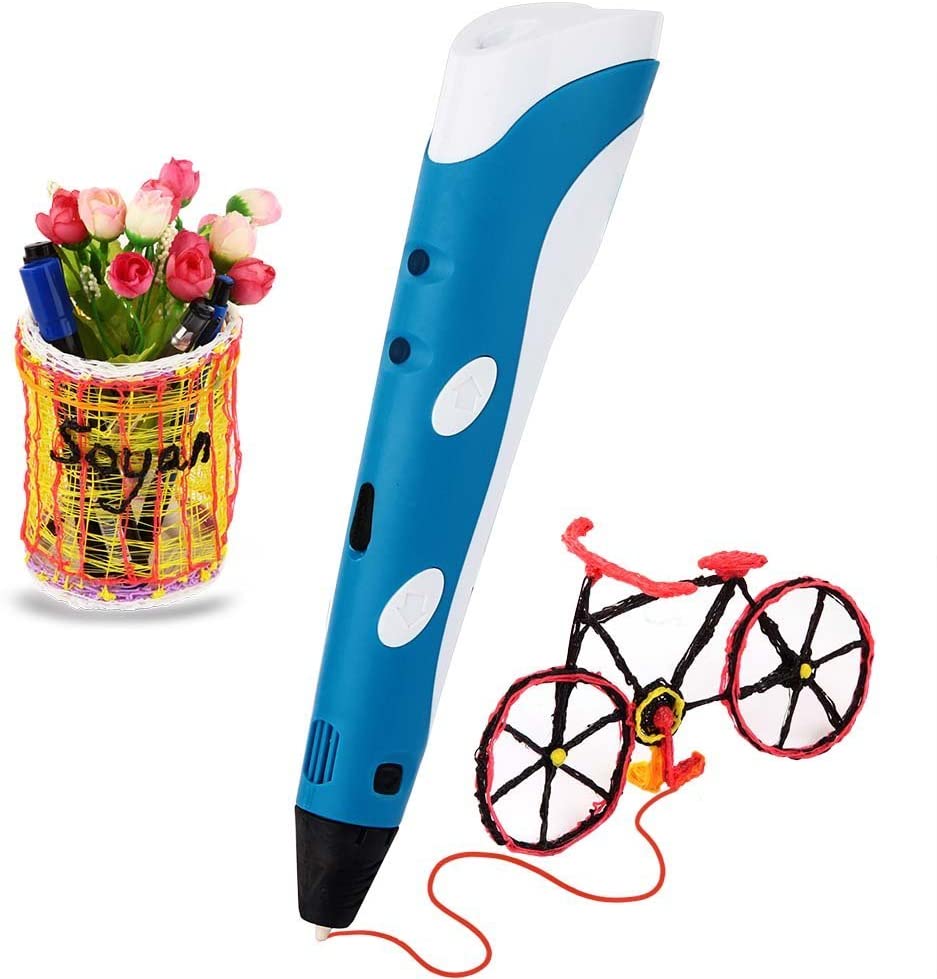

I got this one. Works great with abs. I just save the ends of the spools to use for welding and patching.
