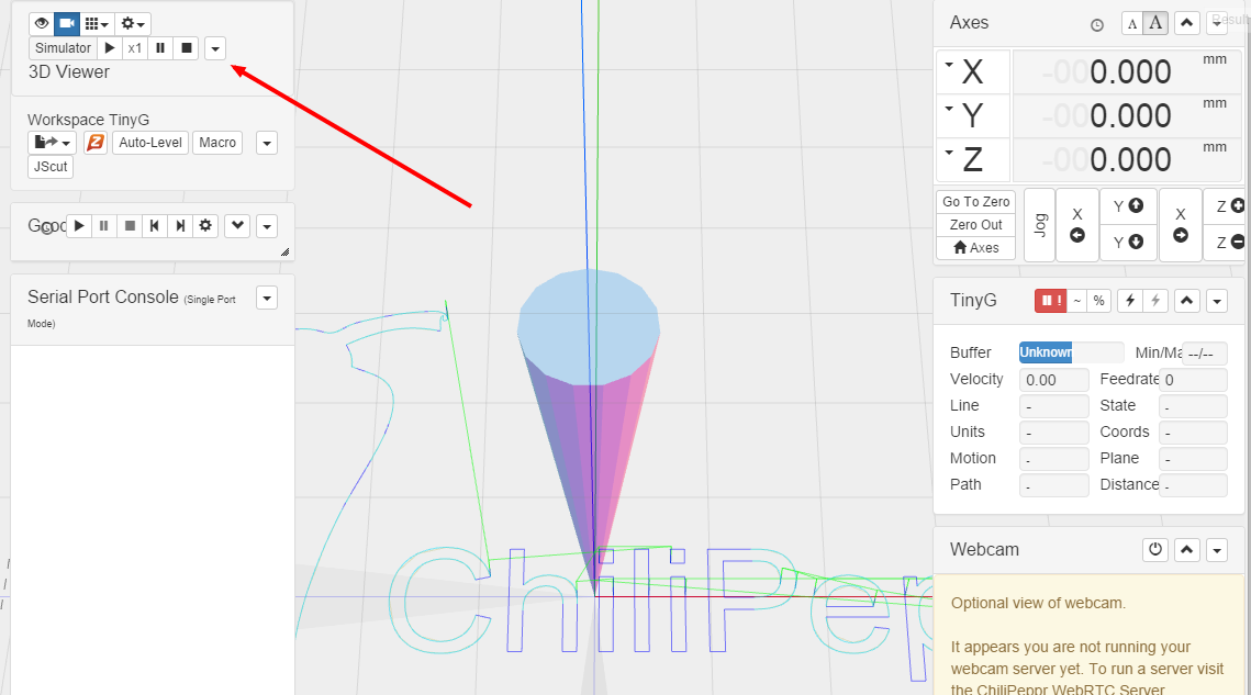

I was trying to switch back to the head version of 3dviewer widget when
I was trying to switch back to the head version of 3dviewer widget when I discovered something rather strange.
The 3dviewer widget control sticks to the top left of my workspace widget instead of staying in the normal position in the middle along with the Three.js visualization. I can reproduce this problem when trying to fork the tinyG workspace or the grbl workspace. The issue doesn’t exist in a normal view, only through the view provided by jsfiddle.
If jsfiddle mess up the output view some how, then it would explain why when I use its generated source for my workspace, that I get a weird placement of the 3d viewer widget on mine.
Hmm, I have that exact same code copied from grbl workspace. I put in some console.log but it doesn’t get onto the console. Strange.
Hmm, it never dawns on me that the half finished widget causes the previously loaded widget to fail. Thank you for the help @Jarret_Luft . I will give it a try in a bit.
@Jarret_Luft , that was indeed the error. I feel so newbie right now :(. Webstorm JSHint and JSLint doesn’t bat an eye either. What JSHint do you use?
