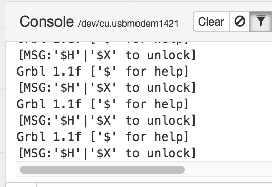

I was using CP in probably the best form it’s been in months last night and this afternoon. About 20 minutes ago it just seems to have totally lost it’s mind (I am in jpadie). I have restarted CP, JSON, and all equipment to no avail. It started by alarming and not letting go even when clicked. I figured something got stupid I started resetting things one by one. Now it’s acting like it’s auto connecting when I restart it but the ‘State’ shows it as offline. I can’t connect.

I have had luck all yesterday and today. The last few hours have been a nightmare trying to make things work. Now when I move the readout does not update similar to the issues we were having several months back.
That message in the serial console is a statement that the alarm was triggered at initiation of the session. So a door or limit issue or similar. Follow Sebastian’s advice. If you are getting persistent errors then check the voltage on each of the switch pins to determine what is causing the alarm state.
Also it looks like the controller is either continually being disconnected and reconnected at the sjps level or at the firmware level.
Take the controller out of wherever it is and disconnect from everything. Plug into a serial terminal and see what is coming back. If you’re still getting alarm messages then get a loupe and check the terminals very carefully. If you’ve got a multimeter look for shorts between the switch terminals and ground and between the switch terminals and vcc (depending whether they are active high/low - typically low).
Gut feel is that you’ve got a short circuit somewhere.

About a month ago I pretty much finished a complete rewiring of the whole system. While I agree with you about it being a short somewhere, I had put heat shrinking on pretty much everything. I built everything into a box, so I sort of shudder at the idea of pulling everything back out. The only thing that has changed was that I finally wired up the LEDs to my dust shoe (12v). I ran a temporary line until something more permanent could be added. While I doubt that this would be the issue, while I was troubleshooting everything else yesterday, I ran the new line for these LEDs. Afterwards, I was having some issues with CP* which I will mention a little later, but the alarms were not present. I suppose it’s possible that it was something in the temporary run, but… that just doesn’t seem like something that would trip the rest of the system.

How about to undo your last mod and disconnect dust shoe LEDs? Just try to return to last working setup and see if that helps.
Is there a chance that controller board doesn’t get enough power? Do you use same PSU for the controller and other parts of the system?
