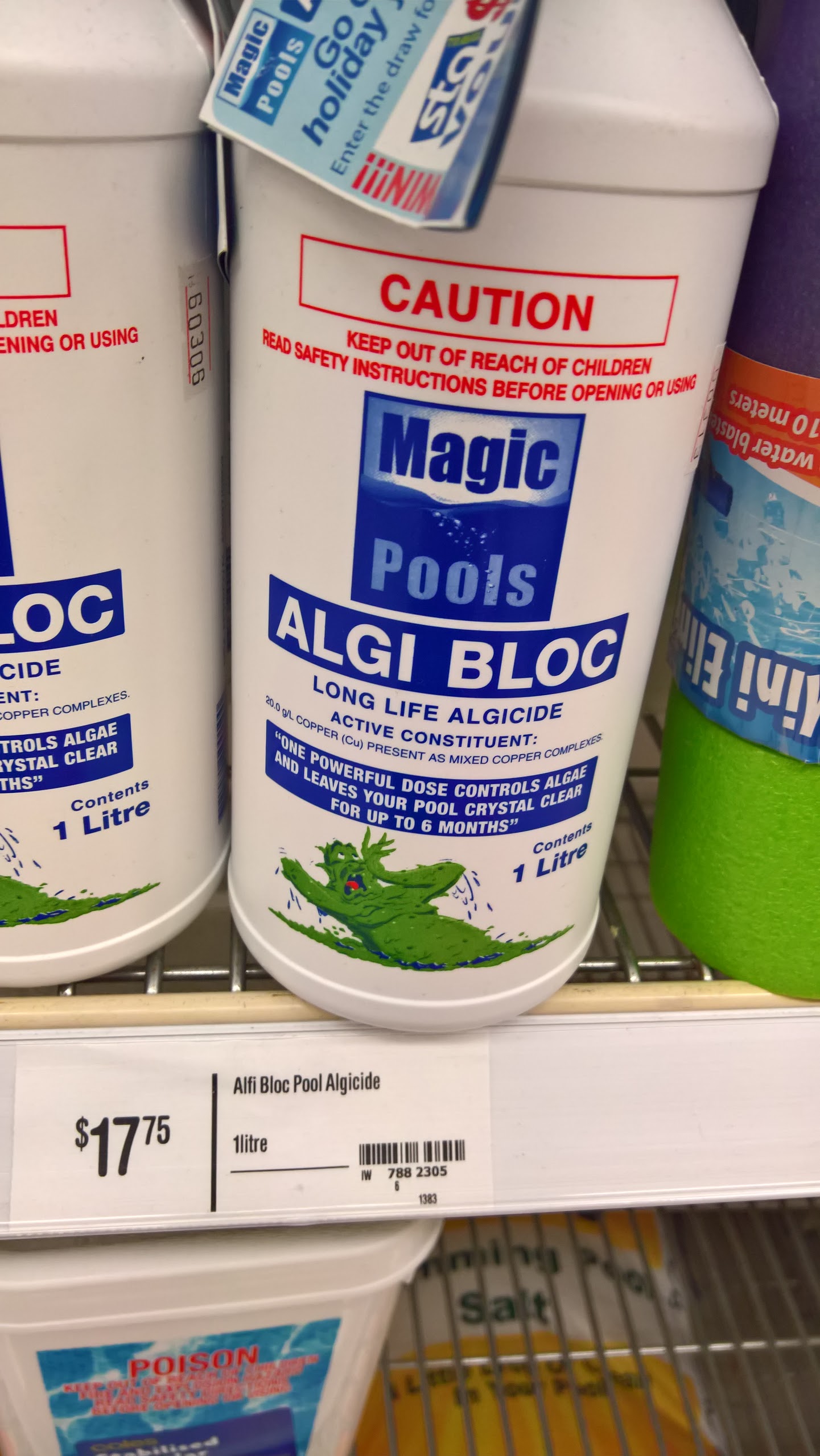

I was walking around my local supermarket the other day & just randomly looking
I was walking around my local supermarket the other day & just randomly looking at products in some of the aisles when I spotted this & had a thought about the discussions we’ve all shared here regarding algae build up in our coolants.
It got me to thinking about the Oligodynamic effect (https://en.wikipedia.org/wiki/Oligodynamic_effect), where certain metals have a biocidal effect. According to this article (& the bottle of algae killer) Copper seems to be a substance which kills algae (specifically copper sulfate according to the article, see: https://en.wikipedia.org/wiki/Oligodynamic_effect#Copper).
What I’m wondering is could we place some copper pipe into our coolant reservoirs to prevent the buildup of algae? Secondly, if so, does this increase/decrease the conductivity of the water?
I’m looking to @donkjr & @HP_Persson since you’ve both done extensive tests on this matter.
First thing i see on the bottle is the copper added, not something you want in a coolant. Does it say 30g per litre ?
Probably don´t need the whole bottle, and diluted with distilled it depends on the conductivity you get if it makes any problem or not :slight_smile:
@HP_Persson I was thinking more along the lines of placing a piece of copper pipe in the liquid just for the biocidal effect. I have no idea the electrical concerns however, so was just curious if it’s a viable idea.
Yeah stay away from the copper based algaecide. I appreciate the thinking on the pipe, but I"m not sure it would really be a good idea either. @donkjr could always setup an experiment to see how much leaching occurs by monitoring the conductivity.

@Nedman Thanks for the advice to stay away from it. Would be interesting to see if there are issues via an experiment, but I’ll take yours & HP’s advice regarding it.
