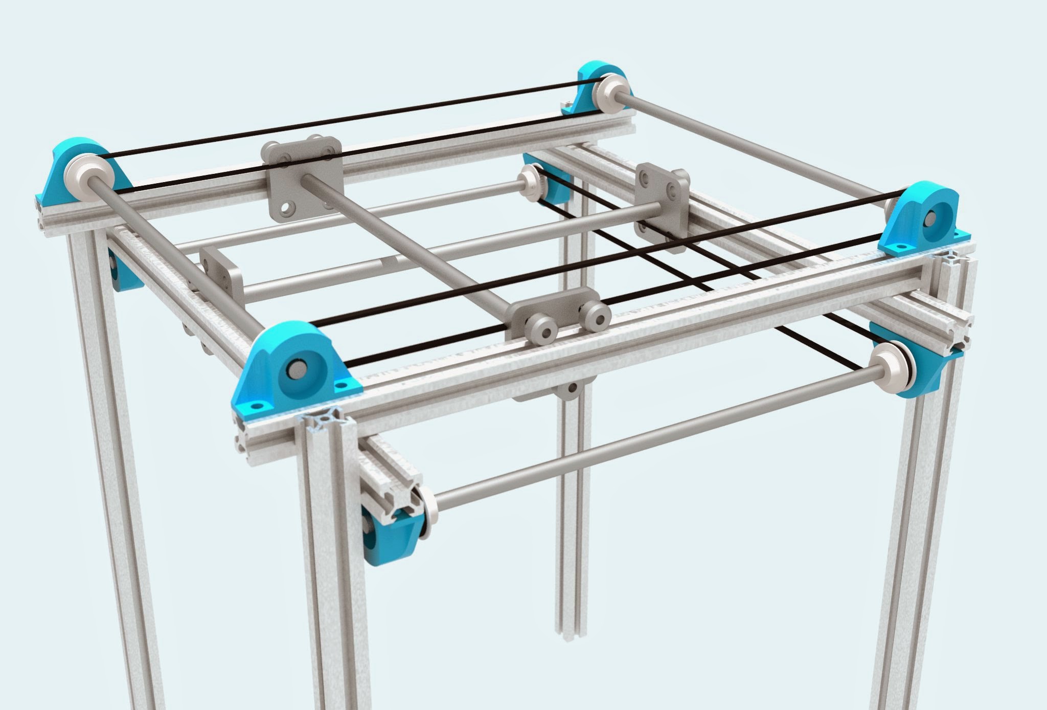

I was wondering how to scale the Ingentis form factor as straight outer shafts become almost exponentially more expensive the longer they get. This is one of a number of ideas I have to get around it. The horizontal extrusion is vslot. Thought @Shauki might like it particularly. KISS Kim!
I was looking at doing something very similar to that with makerslide. Now that there is a supplier of makerslide in Australia I might just do it instead of ingentis/eustathios.
@Shauki what was your motivation for going dual stepper?
That looks like my zillion-bearing version, turned inside out and using makerslide.
How about removing smooth rods completely and moving a v-slot x gantry? I was hoping to test another idea, but maybe someone can before I me. If you put v-slot as all four vertical supports, and put two bearings on all four corners of the z platform, it may add a lot of stability to it. I would also like to find an alternative to v-slot because at 3 dollars a wheel it’ll get expensive.
@Nazar_Cem I’ve got a Z axis design using belts that uses 4 corner supports as you describe.
Oh Snap. I just realised the vslot and carriages in this design could be replaced by 12mm linear shafts with one lm12luu for each x/y end. Not perfect for a very large bot but 600mm should be easy. Total cost for 12mm rails and bearings would be about 50 including shipping from China, vslot and carriages more like 120 with open builds vslot. . You’d need 8mm hollow aluminium shafts that drive the GT2 Belt and, 608zz bearings and probably 10mm aluminium shaft for the cross beams to keep weight low. Possibly igus Iglide even. Hmm hmm. Could work out pretty cheap for a 550 square build volume.
I now await @Shauki to turn up and tell me why I should use box section and mason cord :p.
@Shauki AH, I get the twin drive thing without shafts (hadn’t understood previously). The problem with your suggestion is that you would have built 3 bots before I had finished one - there is no spare time with a full time job and high energy Toddler!
@Shauki Okay, now this is pretty interesting, You’re moving away from the Quad/Rap/Strap gantry in favor of something similar to the Ingentis (printhead floating on round rod)…I’m at the point where I’m either buying a TON of bearings, building cheap but non-precision substandard bearings…ooor I could just use all of the Ingentis parts that have already been printed for me. I spent last weekend working on structural aspects of the printer and I’m at a fork where I continue with a Quadrap design, or go Ingentis.
I liked the simplicity of the bushing/shaft structure on the Ingentis, and the difference in price is probably less than $100 (he says with a wink)…I’m going to have to re-evaluate.
That’s the thing, though, the ingentis uses the 8mm and 10mm shafts to keep everything in alignment…There’s not a lot of twist to a solid steel rod across the length of the printer.

So in this design, could you use Drill rod for your drive shafts, and only splurge for nice stuff on your cross rails? That said Ive had great luck running drill rod as my bearing rods using the cheapo igus sleeve bearings. Opinion?
Ive never tried alumium with sleeve bearings other then the igus iglide stuff thats ridiculously expensive (38. I can get 12mm drill rod for 5$ for a meter. Aluminum is about the same but not as stiff. What bearings are you using for your aluminum @Shauki?
well then lol
ok so is there a benefit to tube over rod stock? Other then the weight drop? Because rod is a 1/3 of the price from where I get it.
