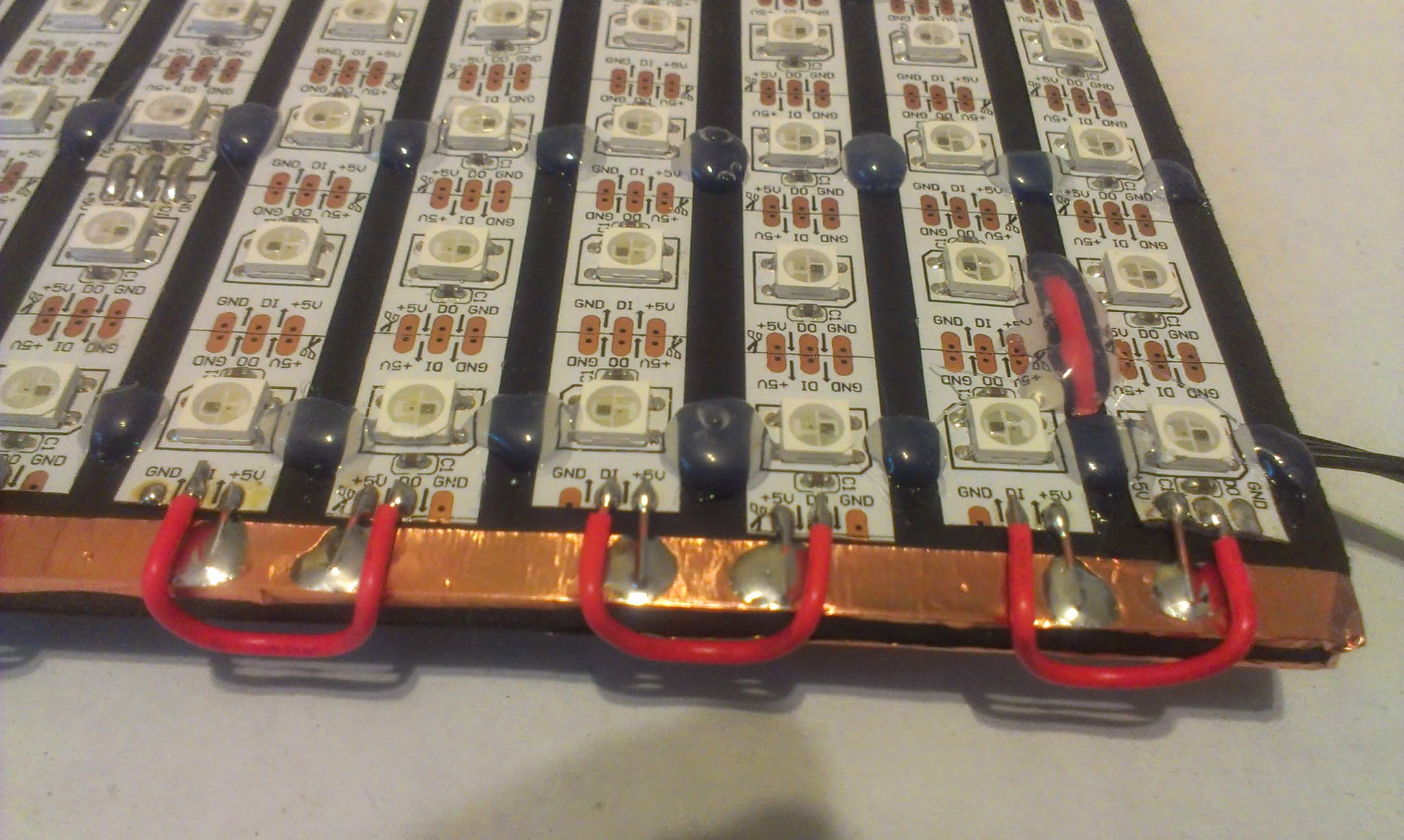

I wired up a Neopixel 16 x 16 matrix (FINALLY!!) and decided to do
I wired up a Neopixel 16 x 16 matrix (FINALLY!!) and decided to do some things different and experiment with a new product for me. The copper tape (https://www.adafruit.com/product/1128) from Adafruit, serves as the bus. I soldered solid core wire for the jumpers to the strips. I am only experiencing a .04 voltage drop at the end of the bus, with a brightness at a conservative 32. More testing results to follow…

Pardon my ignorance but how are you grounding the strips?
@Ryan_Clough Shoot, I managed to upload the same side on the photos. Basically, the other end of the board has a strip, just the same as the positive rail, running down the other side. It looks exactly the same as the positive rail.
Last night I’m getting the same voltage drop, ~.05 volts, at moderate brightness of 128. I’m surprised how the strip is performing, as they say it cannot handle substantial amperage. What is substantial? I’m pulling over 2 amps right now, and I think that is substantial…am I wrong? Either way, I know I can pull more from the copper strip if I tin the whole thing.
My matrix with power injection just at the beginning and the end takes 15A at full white/full brightness. For short moments that seems to be ok, at least I see no signs of heatdamage on the thin plastic carrier which appears similar to the material strips are made of. So I think the question is, how long you have high currents running through. 2A I would call moderate.
