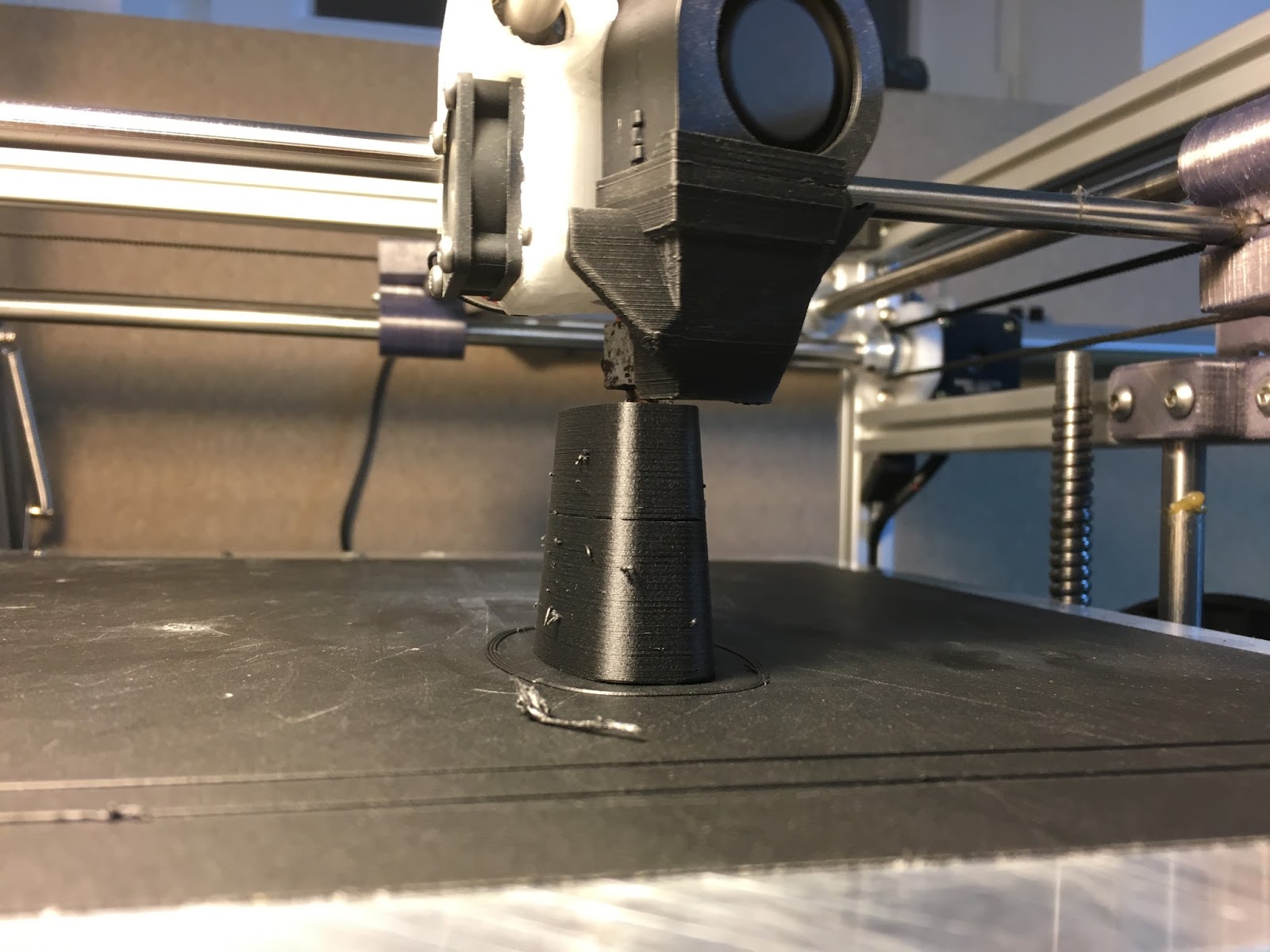

I’m printing it on an E3D V6 (bowden).on my Eusthatios Spider V2.The biggest concerns that i have is that i get broken lines on the infill. That doesn’t sound really bad and actually it’s not a problem itself. The problem is that those loose ends stand up and get picked up by the nozzle where it collects and drops from time to time. This dropping then leads to problems. From small ones which means extrusion problems until this piece falls of and down on the plate. The result is probably a missing piece of perimeter which can ruin a perfect surface. The by far worse thing that happens quite frequently is that it drops that ball of filament somewhere where it sticks and dries which makes it a nearly inviolable hurdle for the nozzle/hotend and often leads to missed steps and a corrupt print.

Attached find a photo of a just finished print from today. 0.15mm layer height and basically good quality apart from the wear you see all over, the missing perimeter in about mid height and as an example one of the “collected” piece in front of the print on the plate.
