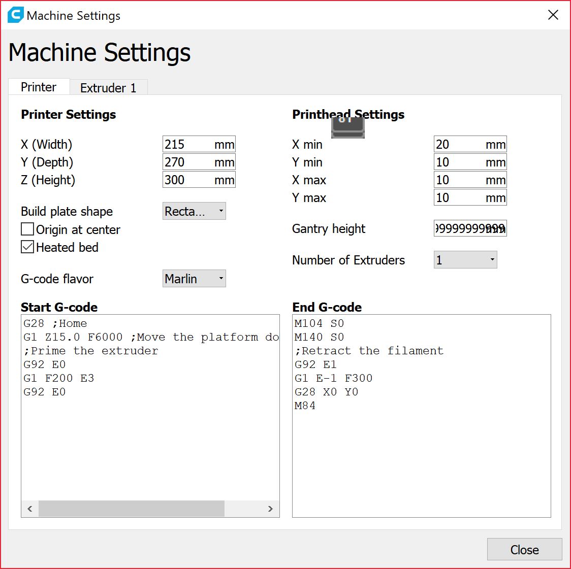

I would like my printer to prime a little more before it starts printing.
I would like my printer to prime a little more before it starts printing. Anyone know which setting does this? Basically the head is homed, it moves up slightly, primes and then moves to it’s starting point for printing. I would just like it to prime slightly more. Also, if you know of any other cool code to add to the start or end I would appreciate that as well. My printer is an Anet E10 if that really matters. Only a couple of minor mods but nothing that should affect any of the settings below. Also, the below settings are the stock ones from Cura.
In the start Gcode line G1 F200 E3 change E3 to a bigger number.
G1 F200 E3, E3 means extrude 3mm before printing, increase it as you need.
If you retract more at the end (you probably need 10-20mm, depending on your hot end), you’ll be able to swap filament between prints without heating up the hot end to release it. Of course, if you do that, you have to account for it in your priming at the beginning.
@Sonex128 That’s kinda what I thought it was but I wasn’t sure if the 200 maybe meant nano meters because not much comes out. The printer I use at work extrudes a lot more and it allows the plastic to be dragged along just before it starts printing. This basically moves the primed filament out of the way so they don’t get tangled up or stuck to the hot end. I’ll give it a shot and see what happens. Thanks for the info.

F200 is the feed rate. E3 is the extruder distance in mm. It may not extrude all of it due to ooze. My a8 oozes terribly.
I set mine to 15 so it makes a little pile in the corner and doesn’t drag it over into the print. G1 F200 E15
