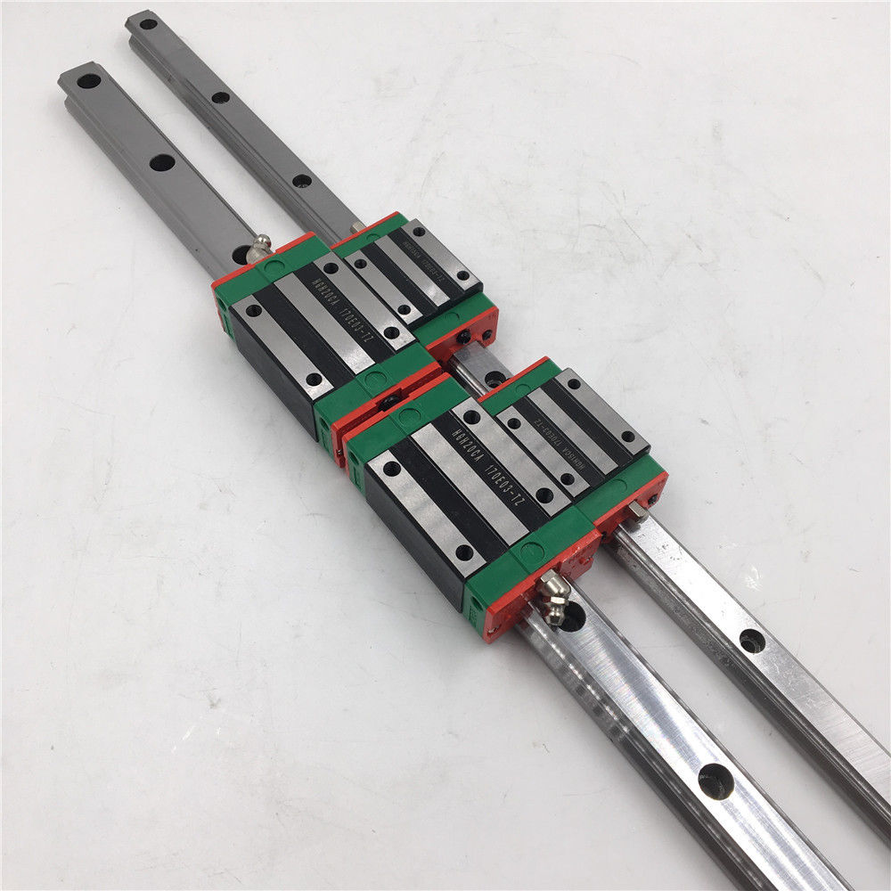

I have bought from this seller before for quality used rails: http://stores.ebay.com/industrialpartsshop/
@Kyle1 LOL I just bought a pair from them. I was a bit nervous about it since they are used. But it sounds like you have had good experience. So that makes me feel better. :slight_smile: Thanks.
