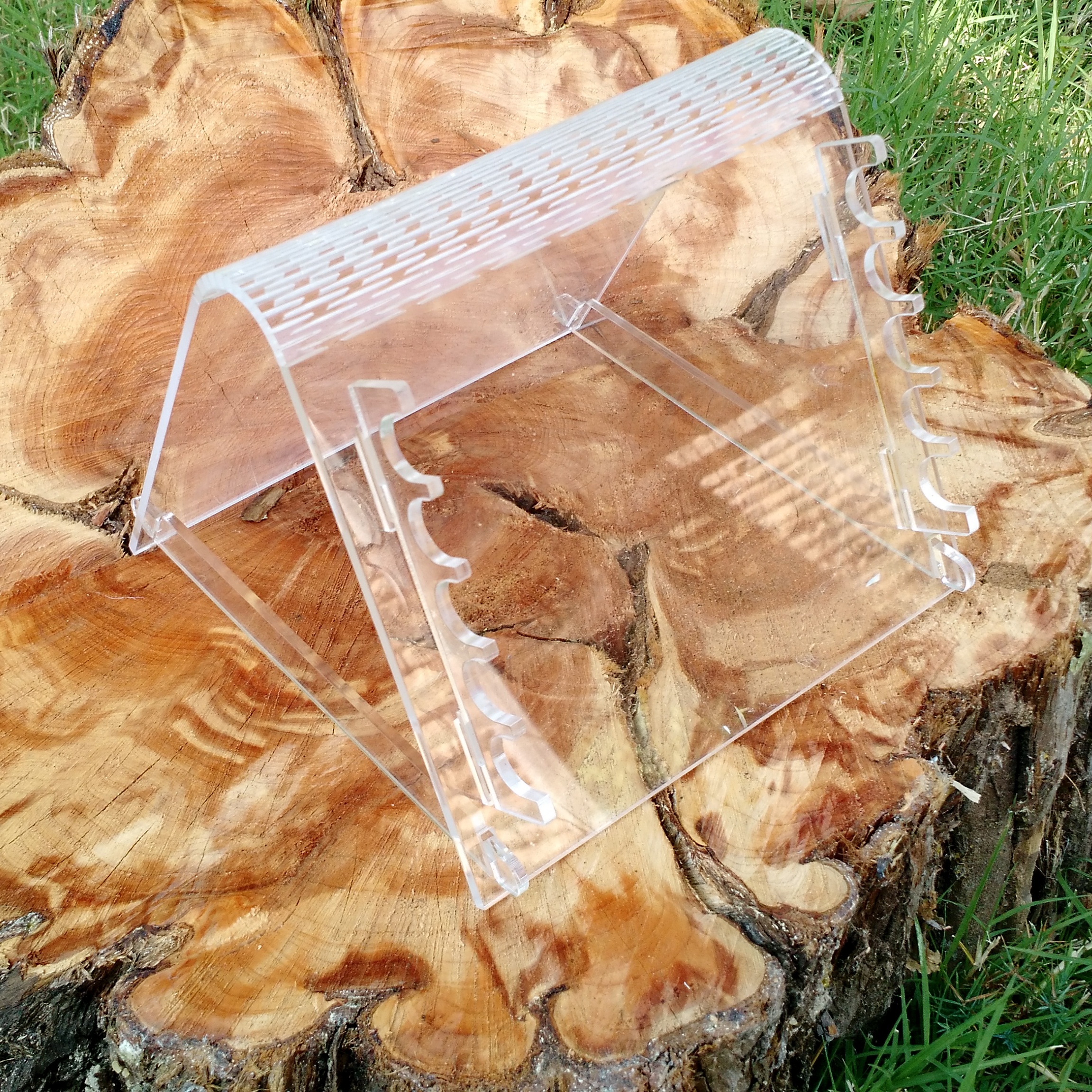

I would like to thank everyone that helped me with my living hinge questions… Here is the finished results. I will be making up a couple more of these to send off to a benefit auction whose poceeds will go directly to a wood worker who has suffered the loss of his workshop due to Hurricane Harvey. This auction is being held by a pen turning group and my contribution are these pen display racks for craft conventions

Excellent design and finish. Will you share the design?
I assume it comes apart and lays flat?

I would anneal the acrylic. Living hinges in acrylic tend to crack easily and break otherwise - because it doesn’t have the alternating plies for strength you get from plywood. You can anneal it by putting it in the oven at 170F for an hour per mm of thickness and then turning the oven off but leaving the piece in until it’s cooled down.
Annealing relieves the inner stresses in the acrylic caused by cutting that lead to cracking and crazing.
Pretty cool. I’m surprised living hinges work in acrylic. I’d have expected it to just snap.
@Jim_Hatch ​ should I remove the protective paper before or after annealing?
imma guess before?
