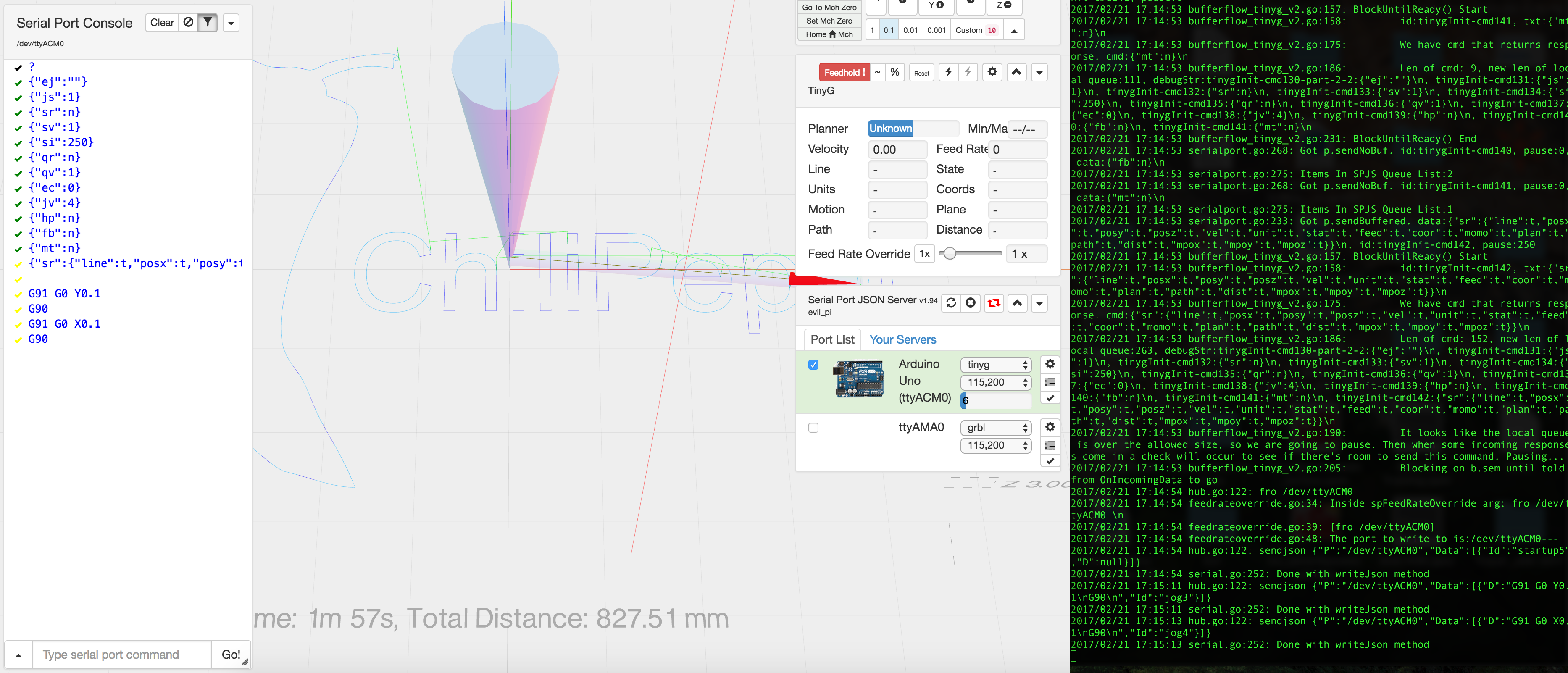

I would love some help. I got a Shapeoko 2 with Grbl (Arduino Uno + Gshield). serial-port-json-server is working and I can connect to it however, when I connect, the only option that seems to accept commands is TinyG but right after it sends the last initialization command everything else goes to the buffer and is not process. Here a picture of it with the logs. HELP!

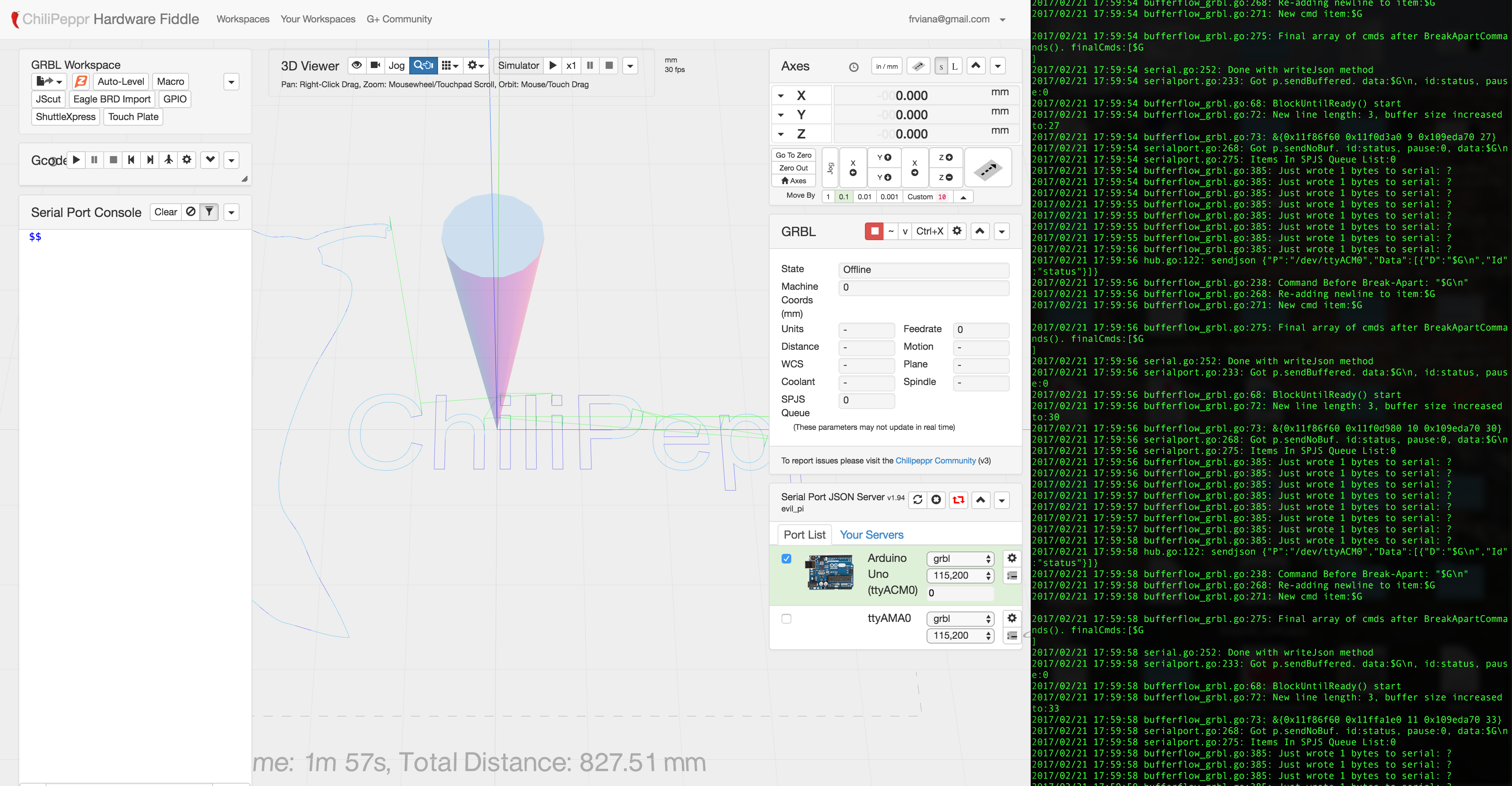

The Grbl workspace is on the homepage and the direct url is http://chilipeppr.com/grbl
Found the solution. I have an old firmware on my Uno and it only supports connecting with 9600. It doesnt support 115,200. I was able to get it to work with 9600. I will update the Uno and report back.
