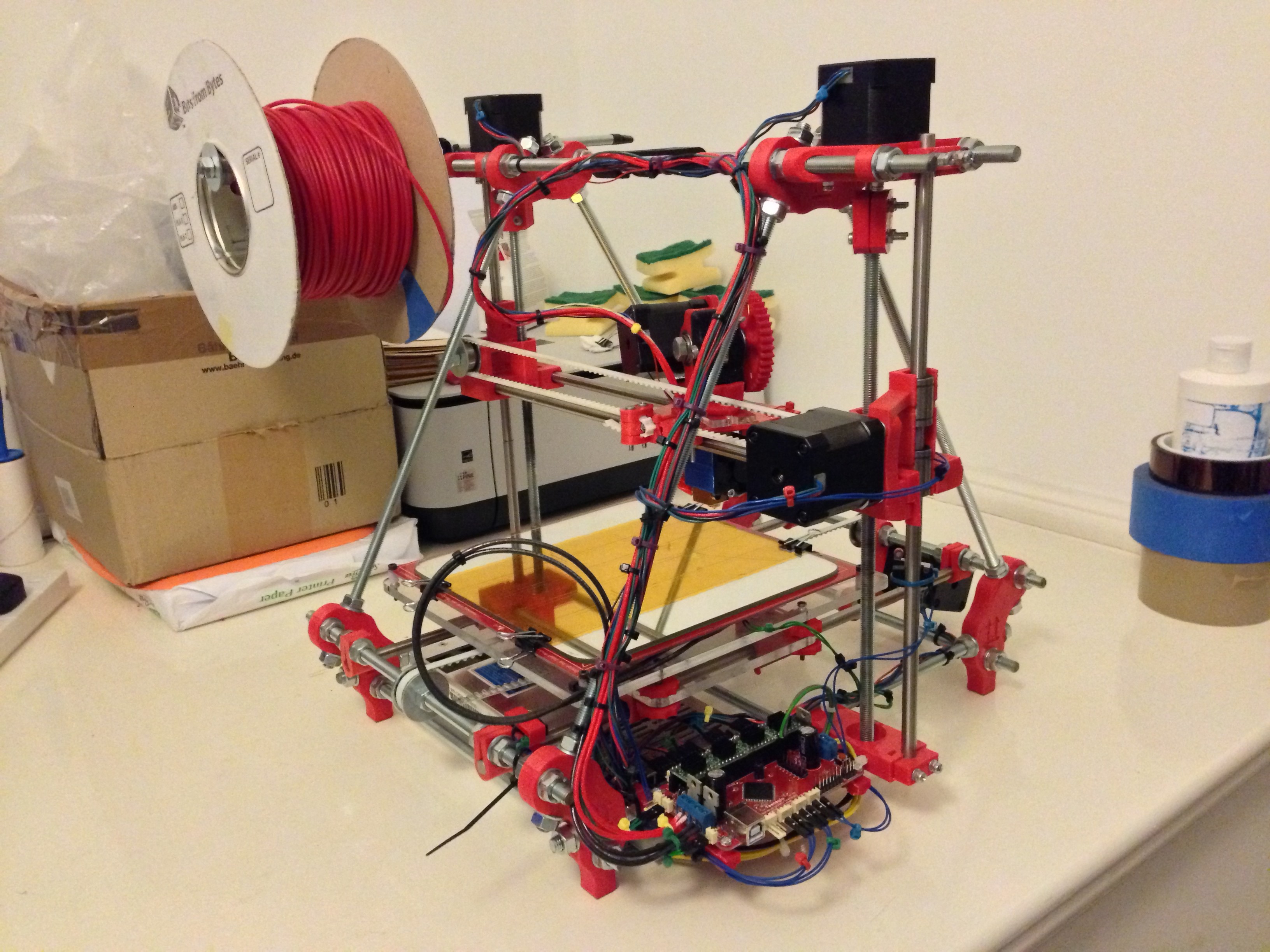

i2 is all back together again,
i2 is all back together again, only took me 2 years to get round to sorting the wiring out. I do need to print a few bits to finish the job though, the E3D is rather a large extruder, but this is roughly the look that will stay now.
Looks good, my I2 is looking a little wore out as well I need to rewire and re arrange a few things and make an extension kit for the z axis.
