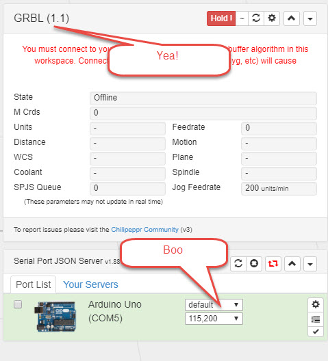

So I realized if I leave the firmware set to “default” (aka let it detect??) then it does say GRBL (1.1f) in the status widget after I check-mark the box, but I can’t unlock the alarm state no matter what I try. GRBL (1.1f) is correct for me.

It works if I open the drop-down and click grbl every time. Can this step be saved as a setting? A simple cookie in the browser that says, hey, we know the answer to this from last time he was here, let’s highlight that for him to save few clicks.

Here’s what I am seeing right now… I can close the browser and open it back up and it fully reconnects using GRBL and the console comes to life. However, if I close SPJS too, it forgets again. I assume it could be SPJS’s fault in this scenario though.

/jpadie has always identified an Arduino Uno on COM5, without fail. It just fails to select GRBL from the dropdown. Even while saying GRBL 1.1 on the status widget.
