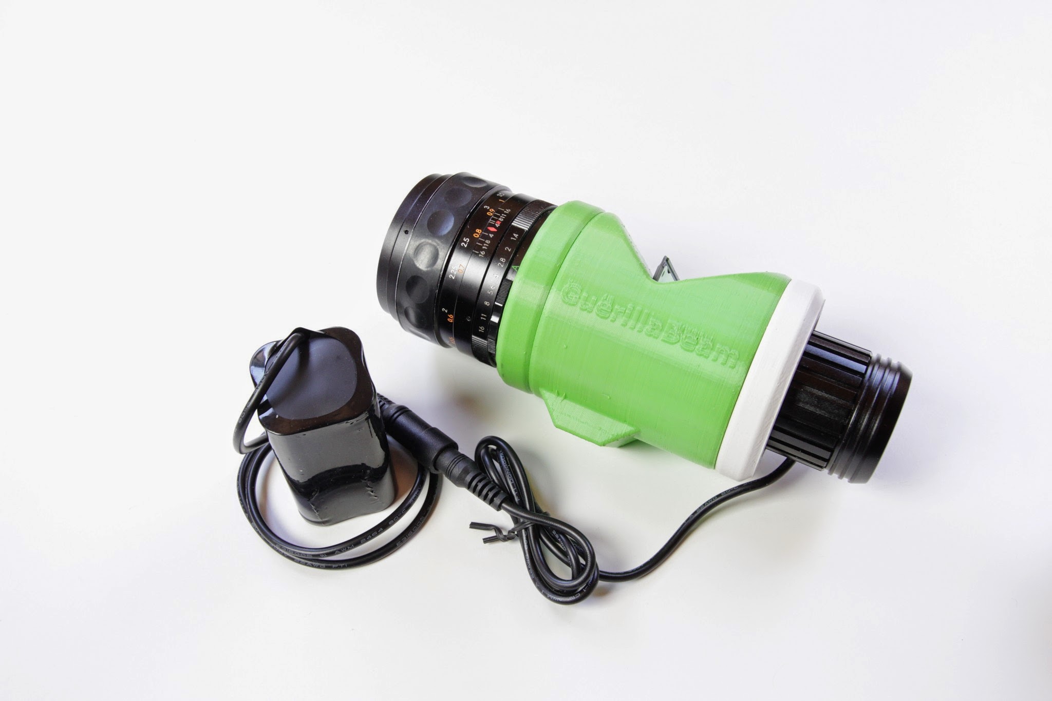

Id' like to show you my personal 3D printing project called GuerillaBeam .
Id’ like to show you my personal 3D printing project called @GuerillaBeam .
It’s a 3D printable projector, that can use arbitrary camera manual focus lenses and LED lights. It’s solid state and portable and yet superior to classic slide- and gobo projectors.
It includes more than 700 hours of work (not counting the printing), much love to detail, and has a whole system of many adapters and tripod + accessory mounts for attaching anything you’d like (cameras for instance).
I plan on manufacturing them, and also to make them available for downloading for a small fee (CC licensed). Please let me know if you are interested or have any ideas and questions about it! Thanks :slight_smile:

Great Project! What kind of lens mount do you use?

What’s the nearest working distance? Thanks

@Robert_Reinhardt I use all kinds of lens mounts, like M42, Canon EF, Pentax… It’s quite easy to make adapters for all but breech-lock mounts. :slight_smile:

@kus11 Minimum working distance is basically the same as one of the lens used. However you can switch lens and light on the GuerillaBeam. This puts the lens 12mm more away from the slide, giving you macro extension and siginficantly lower mimimum projecting distance (like 0.3m instead of 1m). In addition you could insert additional extension rings for as little minimum distance you want.
@Ethan_Hall Suitable flashlights cost from 40$. A really good old SLR lens would cost about the same, but you can get nice 50mm lenses for $10 or less.
