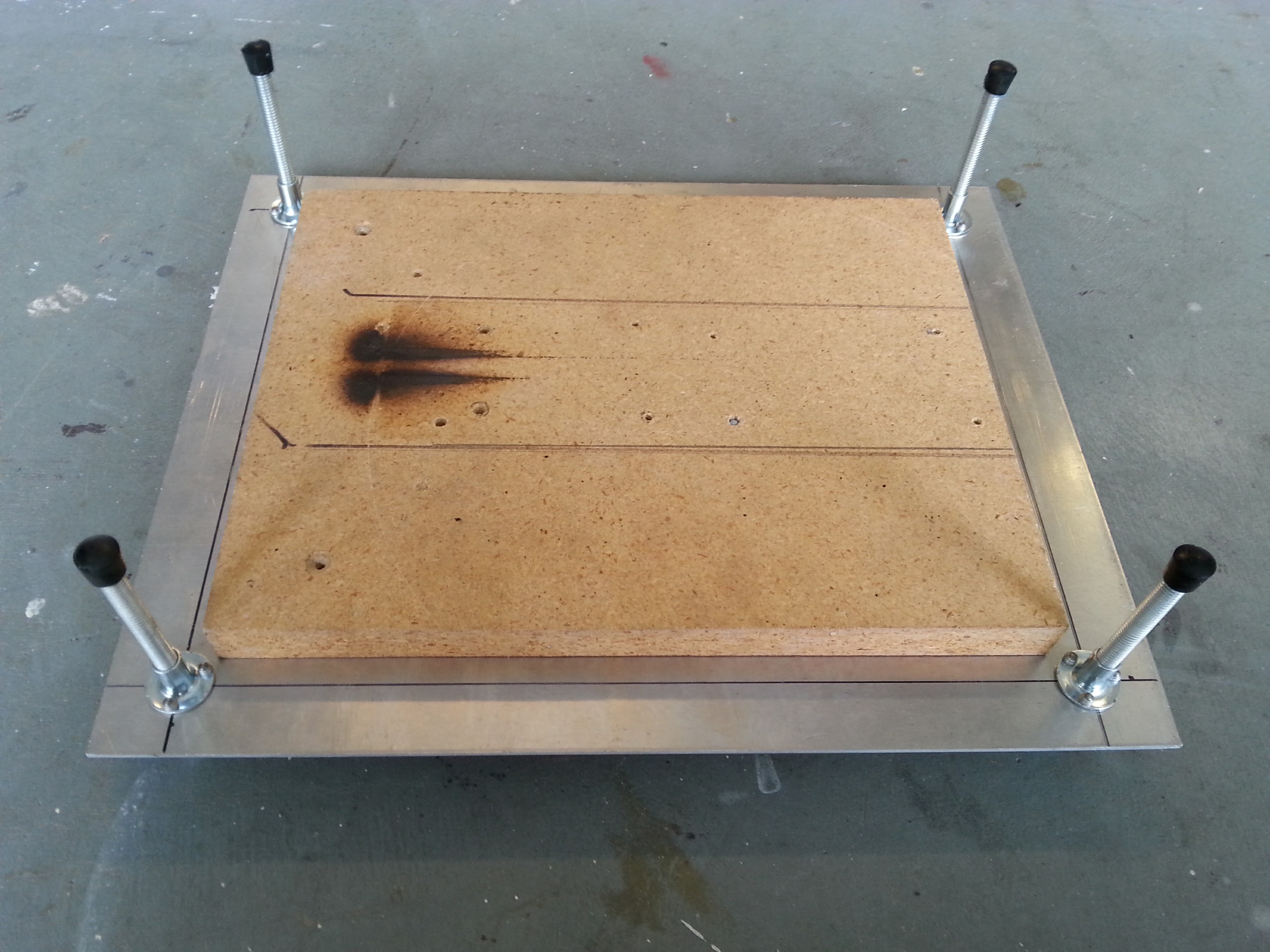

This is my solution; simple, cheap, user friendly.
Very simple but I like it too. My only question is what are the 5 screws that form the X pattern for?
Also, you’ve made one of the few beds I’ve seen that is solid with no mesh. Do you find that you get a lot of burnout on the bottom during cuts? What advantages are there to the solid bed?
He’s most likely using a solid bed for rigidity. I imagine he’s got a farme underneath. As is it’s fine for engraving but not so much for cutting. To cut with a solid bed base I would put a piece of Aluminum honeycomb on top. It would provide space for the laser to defocus and any bounce back would be diffuse, especially if you sand the bed plate a bit first.
If the bed plate is ferromagnetic (Steel) then you can use magnets to hold pieces in place for engraving.
I used a chunk of 3/4" particle board to keep the table square and flat…I cut a piece of bbq grill and use that for the cutting surface. It works just fine.

You have to fiddle with it a bit; I have a bullet level I center on the table after I adjust the cutting height. The cutting height is determined by a rudimentary 50.8 mm gauge the I lased.
