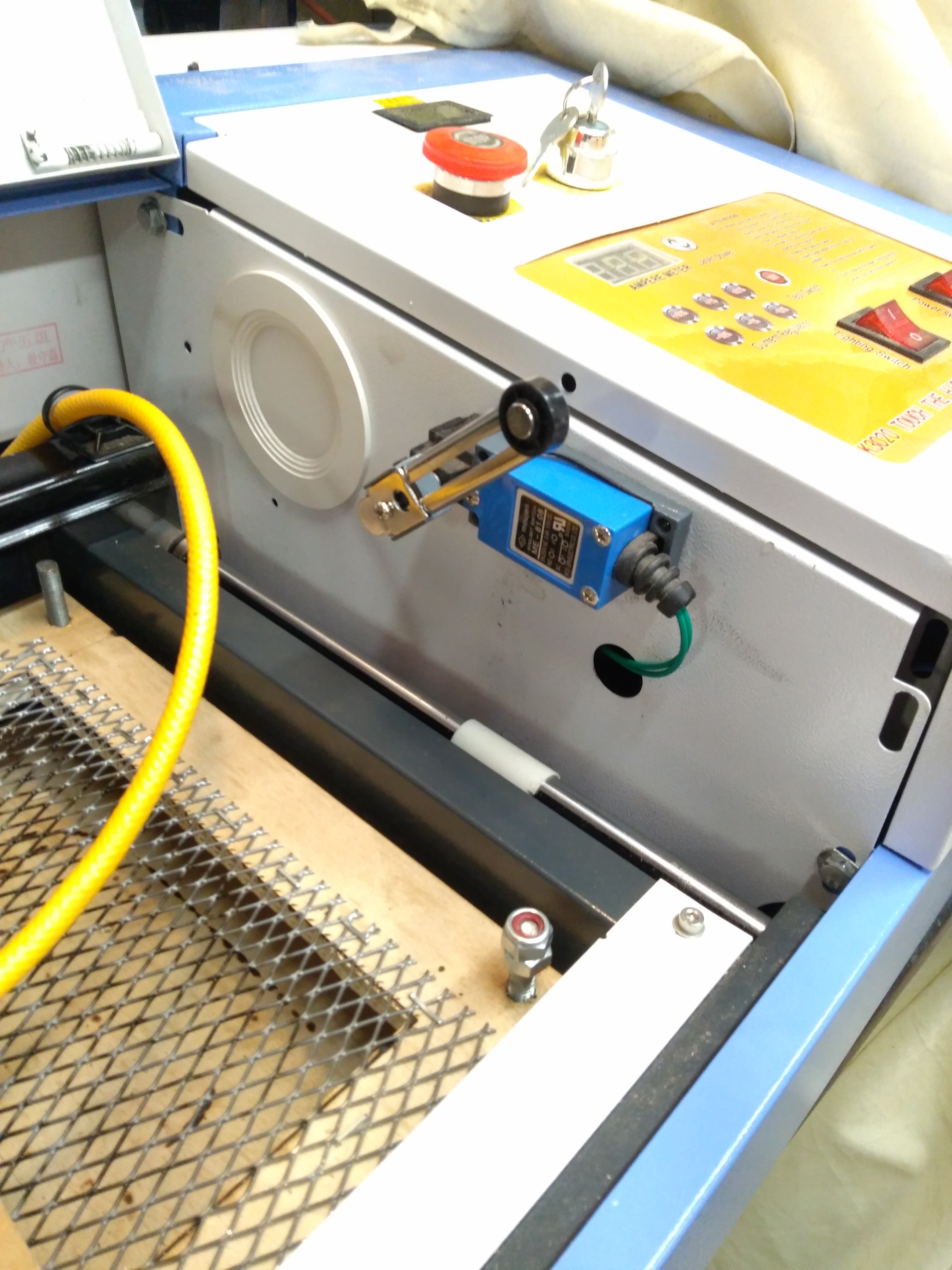

No Don you did not miss it I did.:frowning: So now I have done it and thanks to you I now have my interlock.
A bit ott but it was left over from my CNC build 6 years ago.
Thank you so much Don your a star. I have got myself an ammeter now so going to add that with a multi turn pot. Still waiting for the pot to arrive.
just did a live test everything kept running only the laser stopped firing when i lifted the cover. Once again thanks don. Exactly what i wanted
