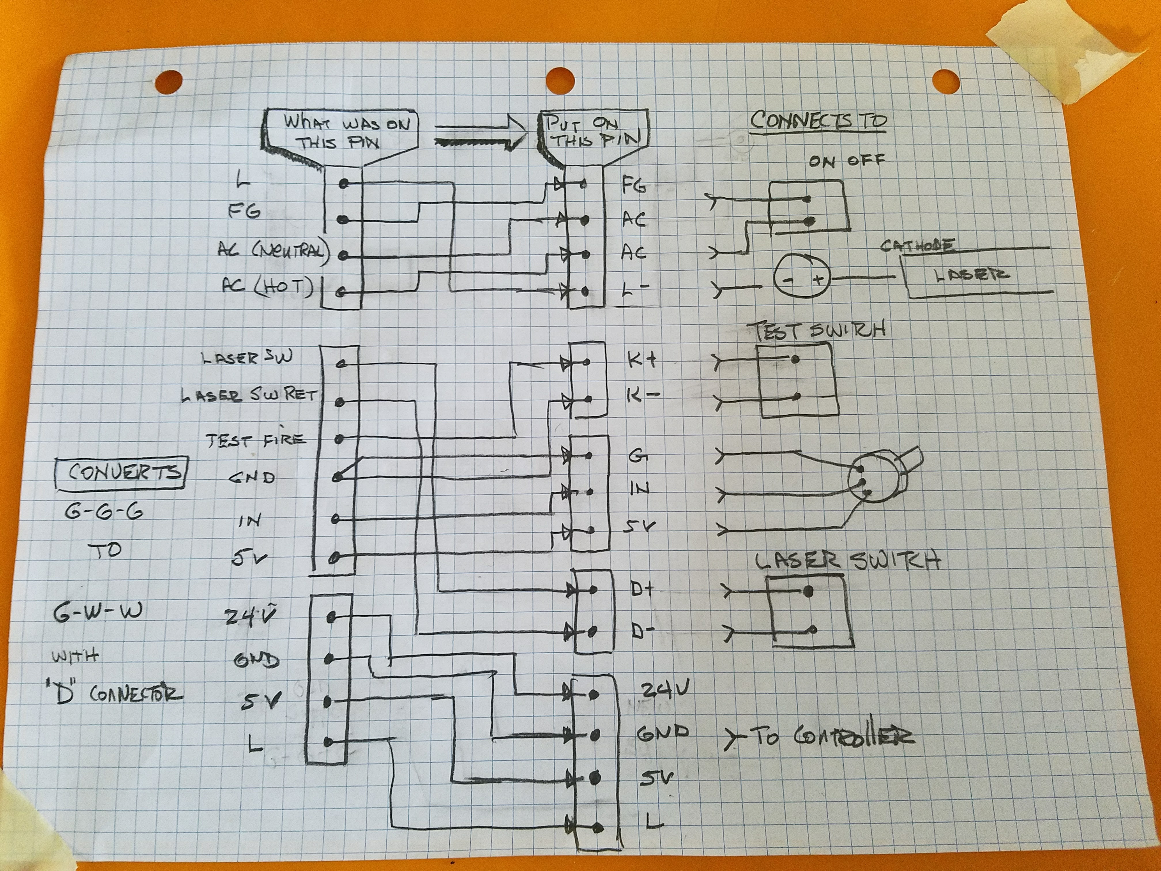

This drawing is for converting supplies but the right hand of the drawing shows how the D pins are connected. Put interlock switched in series with the D and Laser Switch circuit
For reference, this drawing shows a standard configuration with P connectors rather than D
The following post explains the operation of the digital panel. There is one exception to note. The panel I have uses the P+ to test-fire the laser, in your configuration that would have been D+. Since there is no P and the D has no connection I must assume [read: guessing] they fire the laser by putting the “Test Switch” in series with the “Laser Switch” and that provides the “IN” signal. i.e. its all done at the panel.

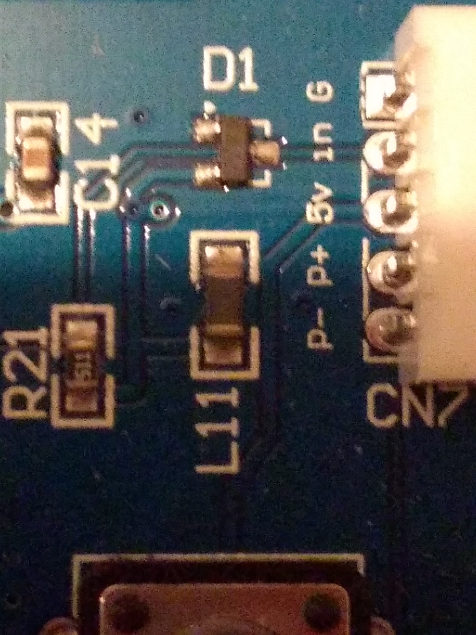

Don as you can see there are no connections to P+ so I cannot see how connecting it to anything will deactivate the laser.:thinking:
Thats viewing from the top but i would hazard a guess that the circuit board is multiple layers, either a 2 or 4 layer. the traces for +p and -p may be on the bottom, or sandwiched in between.
Silly me. Nothing on the under side, did not think of multi layer. I will look again tomorrow.:roll_eyes:
The connector labeled CN7 to the right has the pins/connectors that the silk screen is referencing.

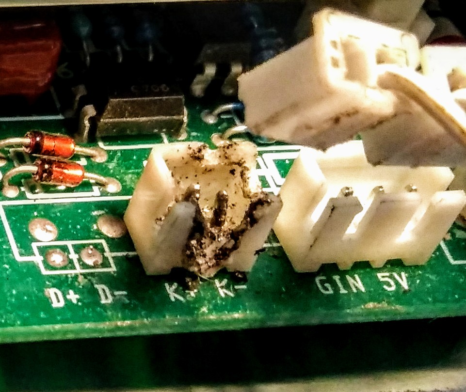

Hi Don. The first picture was the PSU and yes this is the power led. The d pins and the p pins on the led are shorted.
That’s the d pins on the psu
Just checked and p+/- connect to k- on the psu.

Looking at the control and panel, power supply and pins, here is what I see;
Normally D+/D- is the laser enable and K+/K- is laser test. 4 wires are leaving the control panel. 3 end up on the laser power control pins G, IN, 5V and one to the K- side. Also the K connector has damage.
The manufacture is using the laser test input to fire the laser which means K+ would have to ground to fire the laser. As you can see with Don’s illustrations, not all K connectors are equal. Looks like the polarity is switched. So if the K connector is wired incorrectly, it could cause the damage we see. What I do not see or know is how the power supply enable is accomplished with D connector missing.
