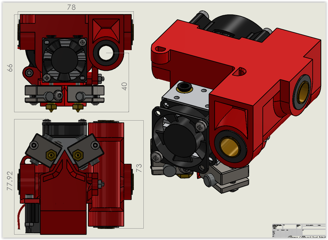

If anybody wants to play around with a Chimera version of the carriage here is where I left off. It is not my best work, and the part cooling duct looks like a bird beak… but it should work just fine. With some TLC it could be a pretty compact dual extrusion carriage for either HercuLien or Eustathios. It could work for Cylops too… but it would need removal of the beak on the part cooling duct.
@Walter_Hsiao could make something much prettier and less utilitarian than mine… I am sure of it. Every modification he has made so far to Eustathios is brilliant. So that’s why I am throwing it out there, hoping someone better than me can get inspired and do something cool.
Anyway, I have STL, Solidworks, Step, and X_T here: https://drive.google.com/folderview?id=0B1rU7sHY9d8qTjZHcjUwaVhDd1E&usp=sharing
Have Fun :slight_smile:
Thanks Eric! You did all the hard work already, I’ve just been tweaking around the edges. And doing so is so much easier with all the designs and files you’ve provided.
I probably won’t do anything with a Chimera for a while since I don’t have one and haven’t really found dual extrusion to be something I want to do. There’s a lot of things I like about the Chimera though so I may play with one at some point.

@Daniel_Salinas should help gain a little more usable space on the HercuLien.
@Gus_Montoya It would, but the part cooling duct would need some modifications.
