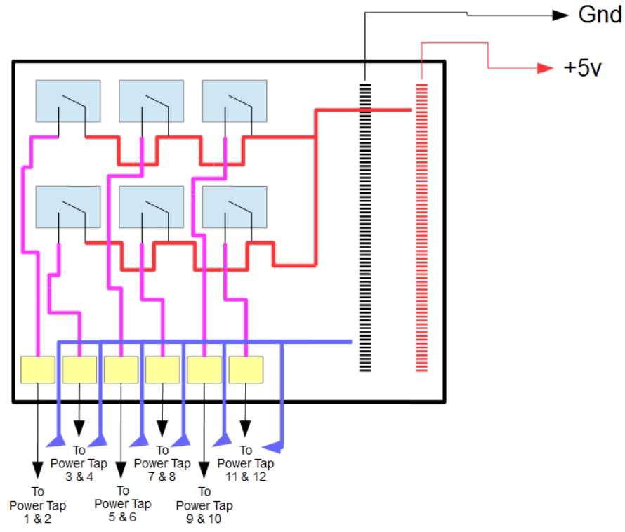

If anyone is interested, I hacked this together last night. Its a small box with a bunch of hardware switches that sequntialy distribute power to a huge array of 2300 APA102 LEDs. Each switch allows the +5V line to activate for 2 power taps. Each tap powers about 200-300 LEDs. This solved the problem of random pixel light up that I posted about a few days ago. My power supply would cut out because a huge amount of random pixels would go white and drain to much power. This no longer occurs :)There are also Caps everywhere but this was the main problem solver. I never run the LEDs to their full power as I’m using a bunch of portable power packs. Here it is in action https://www.instagram.com/p/-_T2viRDdD/

I’m glad you solved your problem, but I’m a bit confused by this. Is it that you were seeing too much voltage drop in a more serial power distribution, and this is more parallel?
