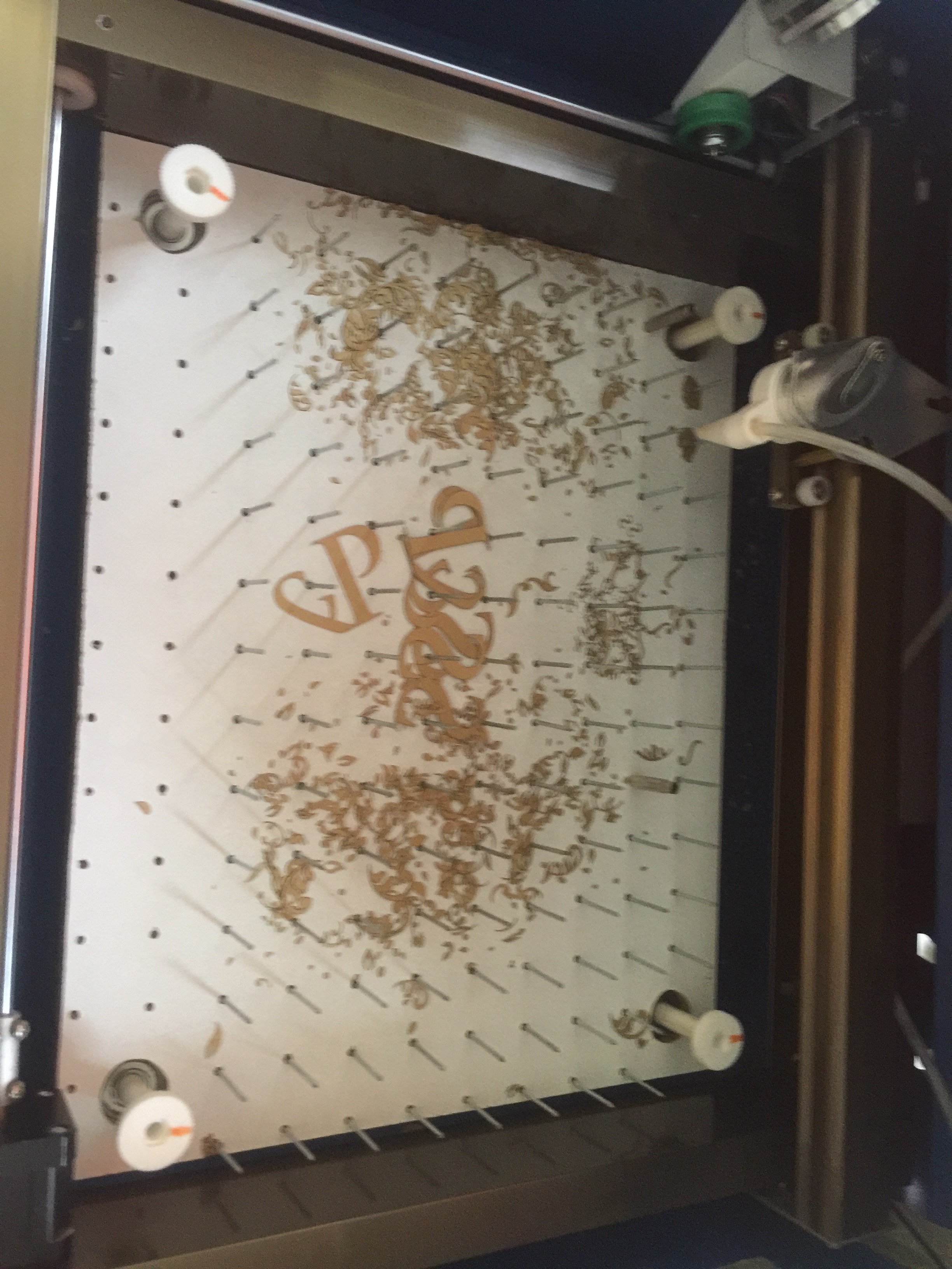

If anyone looking for inspiration - here’s how I solved my adjustable bed. Haven’t seen it anywhere else.
Height is adjusted by 4 screws fixed/secured to the bottom of the frame. Nuts, are embedded into 3D printed part which protrude thru a flanged bearing so I can adjust the nut which is on the bottom, thru the top :slight_smile: then the bed is a simple piece of MDF with nails.

I see, a bit different, but similar approach :slight_smile: all others I have seen have rotated the screw to raise the nut… in your/mine design we are rotating the nut and screw is fixed.

@Peter_Alfoldi it’s hard to tell from the picture—how did you attach the nails to the MDF? Also, is that pegboard?
@SirGeekALot I don’t know what is pegboard :slight_smile: it is a 1cm thick and strong laminated scrap wood board similar to MDF but not with such fine grit. I have pre-drilled small holes into the board and then hammered in the nails
