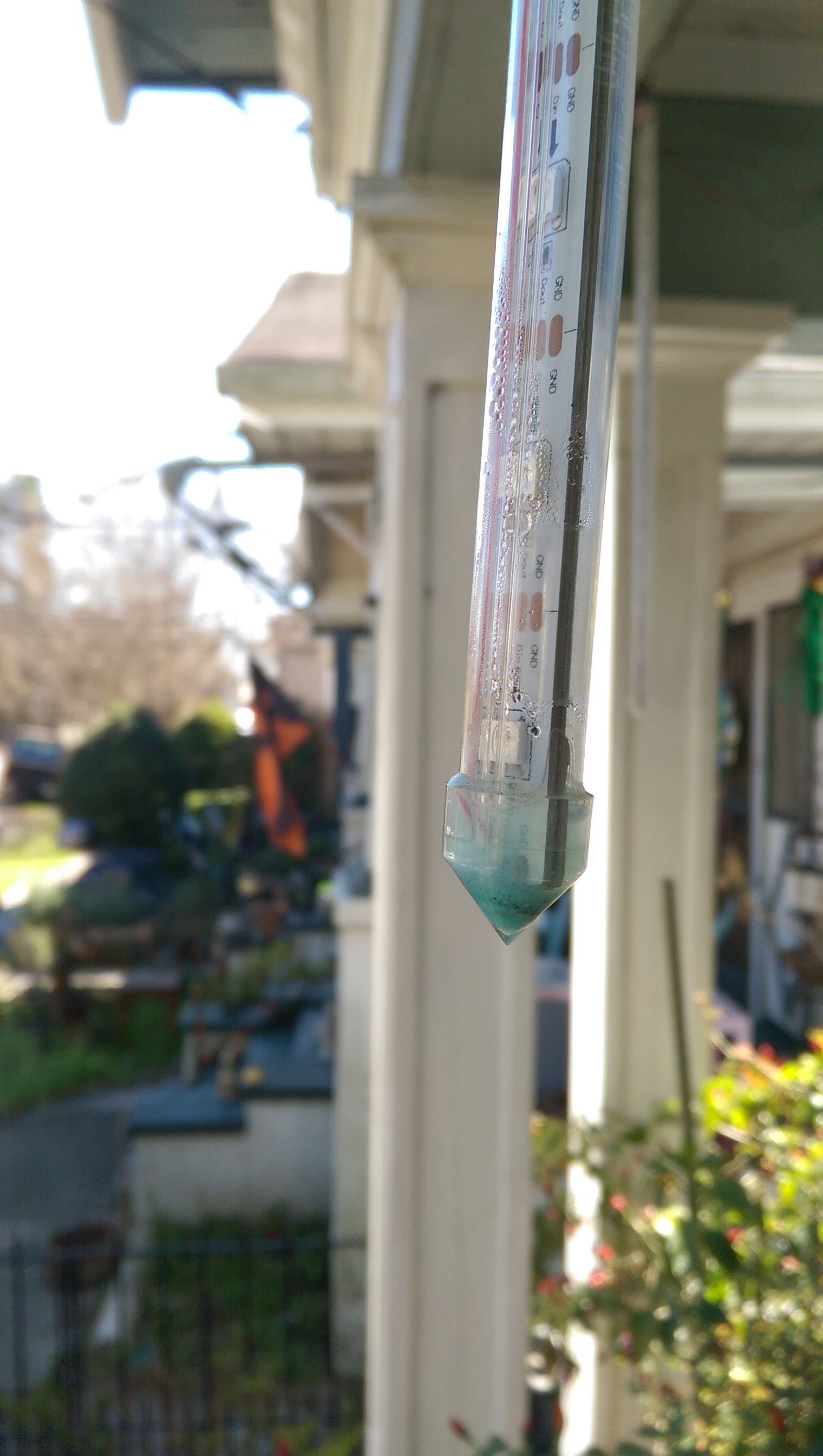

Could it be that changing temperatures condensed moisture already inside the tubing?

I’ve had limited success using a clear epoxy for permanent waterproofing. The stuff is a pain to work with and if you try to fill a tube too fast it will hold bubbles inside the clear surface. . The nice thing about using epoxy is that everything inside is well protected but the stuff outside the epoxy can still break (be gentle with wires).
@allanGEE There wasn’t that much moisture inside the tube before, there have been colder days here and there wasn’t any buildup at that point. This has dripped inside.
The smarter thing to do here would be to seal them with silicone on the top (which it looked like they were, but not completely). If pressure buildup is a problem, adding some dessicant to the tube and piercing a small hole with no gravity-fed access to the inside.
A small hole is a safe way to collect moisture from the air. I would assemble it on a very sunny, dry and hot day and seal it as perfect as possible. Silicone doesn´t last long, especially not in the sun. Epoxy / Polyester or cast resin is a better solution. By adjusting the ratio of the 2 components you can mix a pretty chewy consistence. That substance can be filled into a syringe in order to handle it similar to silicon without a big mess. As long as you don´t cook your installation I see no problem with the pressure buildup.
