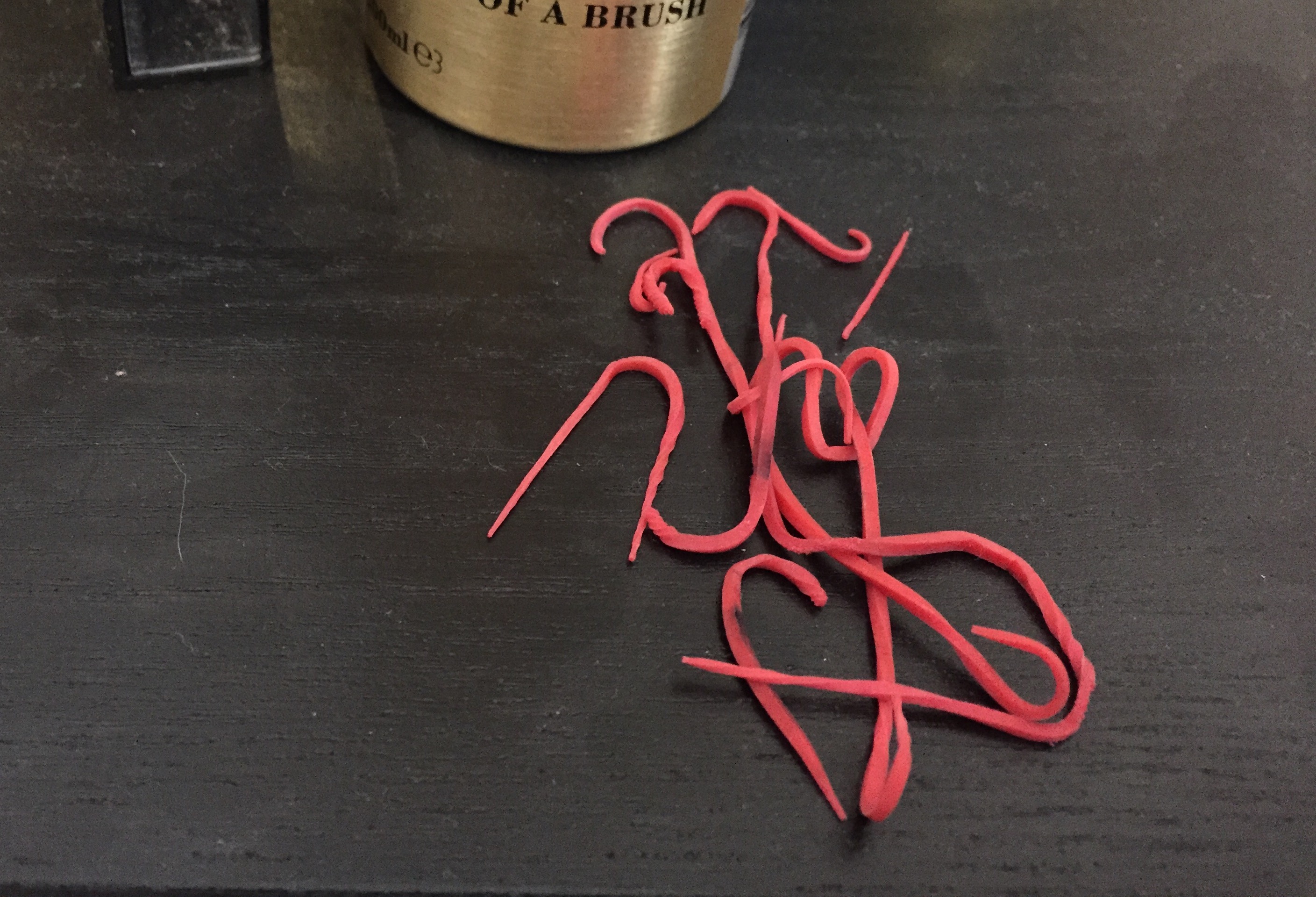

If you have a Kossel and use rubber bands between the carbon fibre rods
If you have a Kossel and use rubber bands between the carbon fibre rods to reduce noise give them a check once in a while. My wife complained that mine was rather noisy, the blasted things had perished, lost all tension.

Between each parallel pair of rods, so three in all. I’ll post a photo in a bit, I’m currently building the @Printrbot Play.
oh, so on the ‘arms’ that go from the ‘skate’ to the extruder platform
