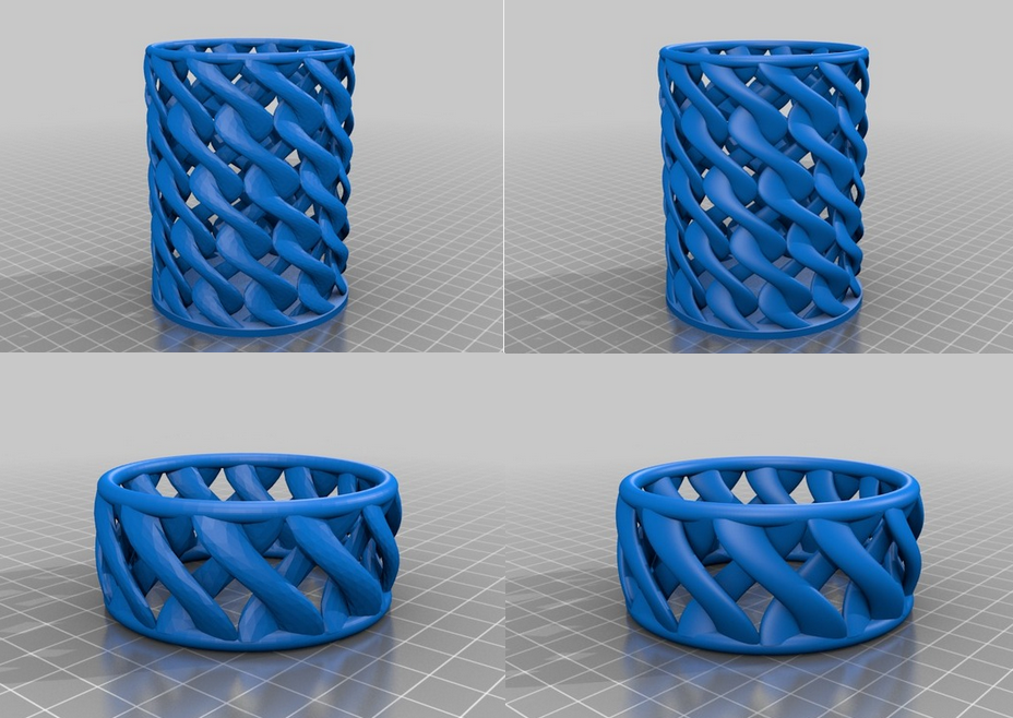

If you haven’t downloaded the latest version of OpenSCAD and you use Windows, I highly recommend it.
It is far more stable than the previous versions and is able to manage much more complex models in a shorter time. I tried updating some of my designs to see the improvements (shown below) and it has made a big difference to the quality of the finished models.
