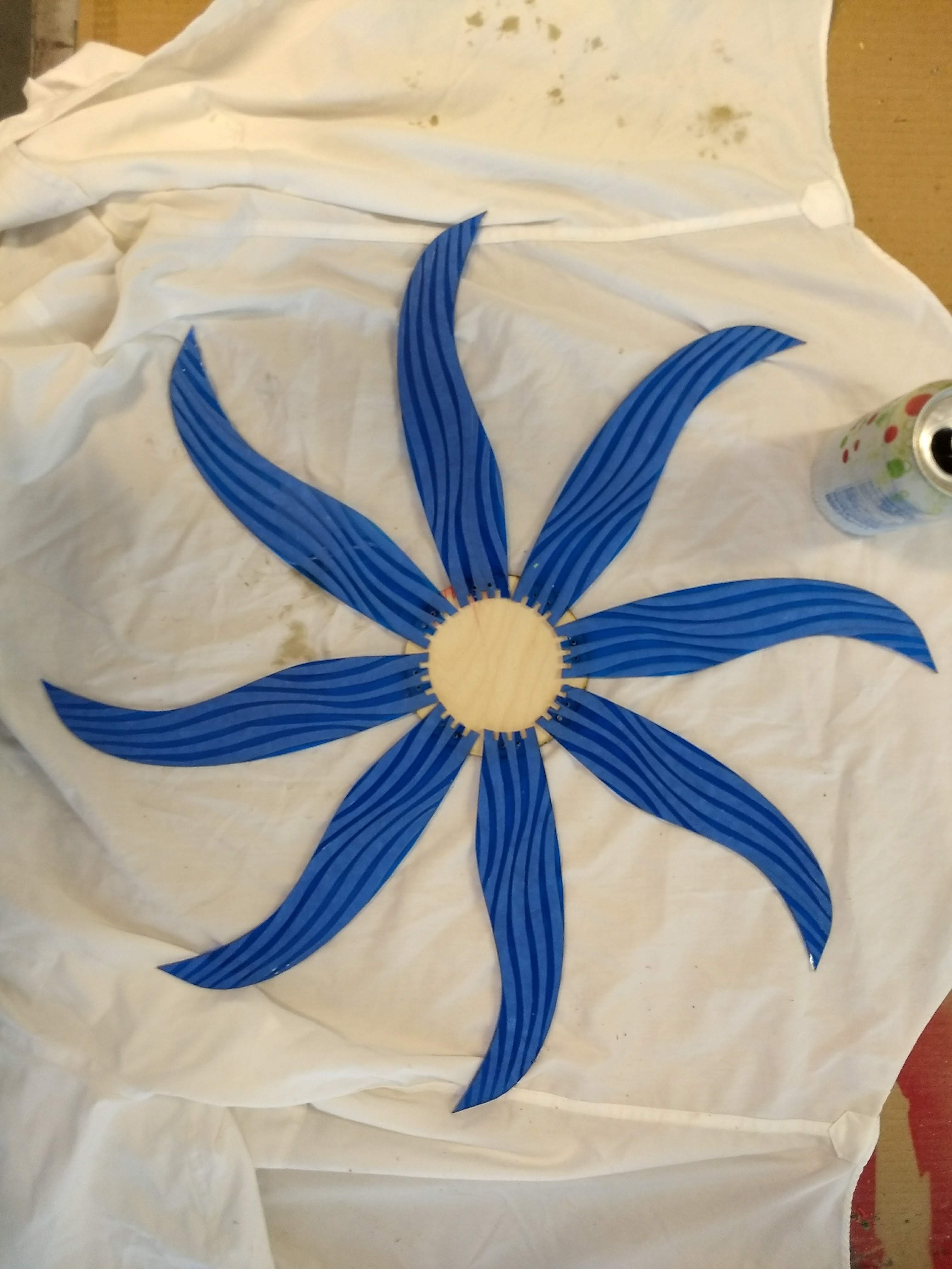

Regarding the plexi, I initially painted the surface of the workpiece with 2 coats of paint. Next, I masked off the entire surface with blue painters tape and gently lazed the design into the blades using about 3ma of power. It was just enough to cut the tape without scoring the plexi. When complete, I pulled tape in the design that I wanted. The remaining paint was removed by lightly sandblast the blades with double ought sand. BTW, as you can see, the sandblasting leaves the plexi translucent (which I wanted).
Here’s a picture of the blades prior to sandblasting…
Hope this helps.
