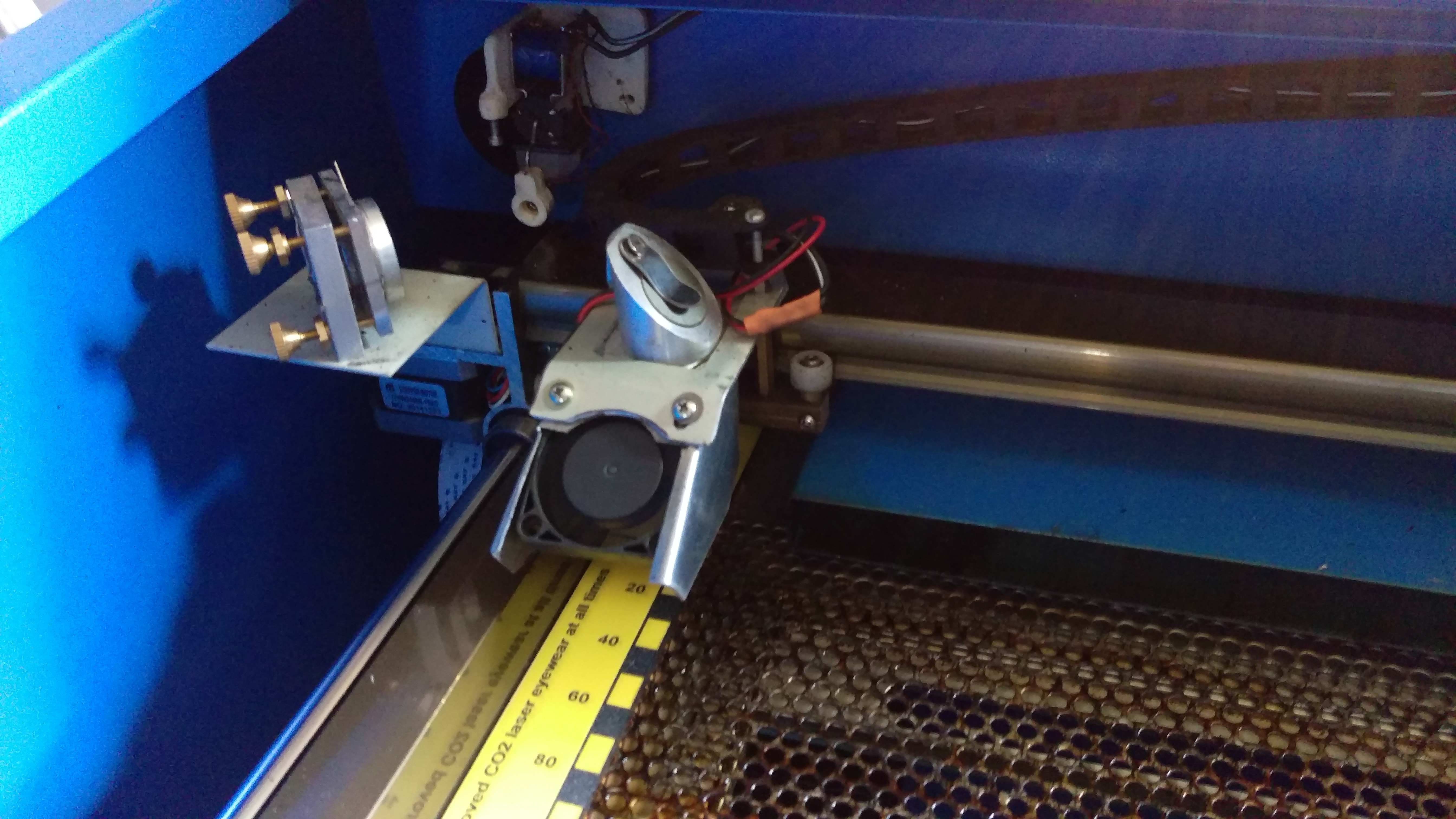

I do use a little pc fan and it does work really well. 3d printed a drag chain for the power wires to make it safe and prevents entanglement of the carriage.
I use a small fan too and it works perfectly. I was concerned about having yet another loud piece of separate machinery to run, maintain, and keep free of moisture, and thought I’d give a fan a try. I went through a couple of iterations, and ended up using a small 24V 2-inch fan, having tried two models before finding one that blew really strongly and smoothly. It is mounted to the head and connected with cable chain (very similar to Paul’s above) and has some aluminum fins mounted on either side of the fan to help direct the flow. It seems to work really well both keeping the lens clean and blow out the flames that used to sometime appear while cutting wood before.
