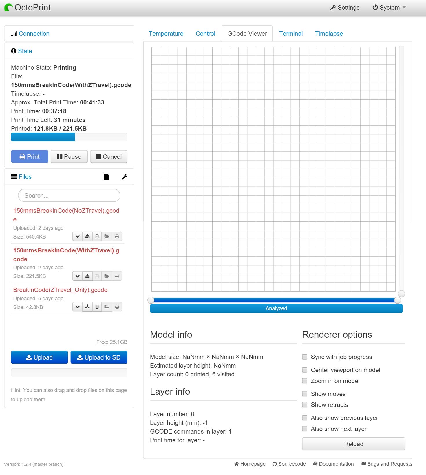

I’m a newbie running OctoPrint. Shouldn’t there be something under the gcode viewer tab?
tick: sync… + Center… + zoom… + show movies + show retract
Move left slider up to show different print layer.
by default ticked Sync… and show moves with retract
Still nothing. I had some of that stuff checked before I took this screenshot.

Nothing extruded (see layers printed vs visited), nothing to visualize.
Yup you are viewing a break-in gcode. It is moves only. No extrudes to visualize
So you don’t see where the extruder travels here?
Maybe click show moves?
Just the blank screen still.
Might be that it does ignore files that only contain moves but no extrusion at all currently. Edge case.
