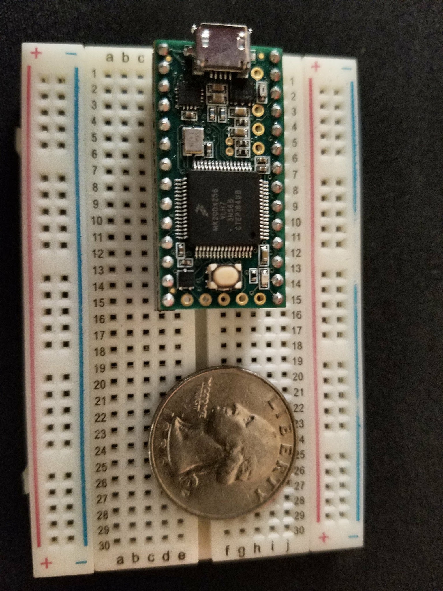

Thanks for the heads up Kris, For now the 3.2, Octo, and RJ45 breakout board are more than enough to get me started. I put myself on hold as I ordered a soldering station. My old soldering iron is a bit hot for some of this delicate work. I should have it all soldered an wired next week sometime.
