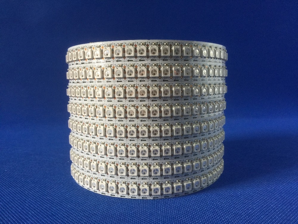

im about to get this 144 set i think ill get 5 meters to
im about to get this 144 set i think ill get 5 meters to start with i have a big project coming any suggestions?

Whoever you get it from, make sure you have enough Amps to run the thing. 144 RGB pixels at 60mA per, that’s 8.64Amps for just one meter (at 100% duty cycle, full white.)
Yeah I know that’s something that’s worrying me a little
If you shop around Aliexpress.com you can find WS2812b 144 LEDs/meter for about $30-35 including ePacket shipping. ePacket is similar to US Priority Mail (it takes about 10 days for delivery vs 30+)and that might be a lower cost - but you have to look at the total cost and always review the sellers feedback.

I just bought five meters of 144 for $26 a meter. It only took about three weeks from ordering to delivery.

http://www.aliexpress.com/store/product/5-X-1m-WS2812B-Chip-White-PCB-144-Pixels-M-WS2811-IC-Digital-RGB-DC5V-LED/1052405_1535615515.html
I was surprised that that come as 5 individual strips. I guess they don’t sell lengths longer than one meter.
