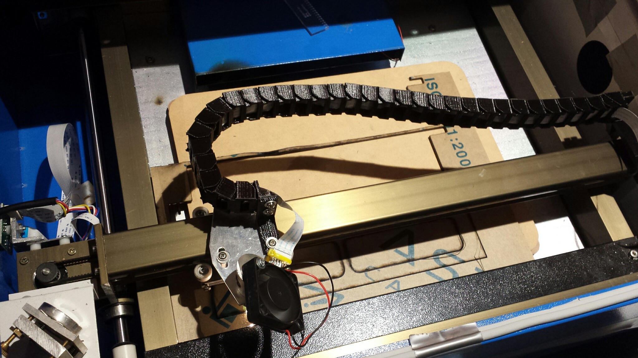

Indeed just 3d printed a drag chain for my mini fan which is my version of air assist :grin:

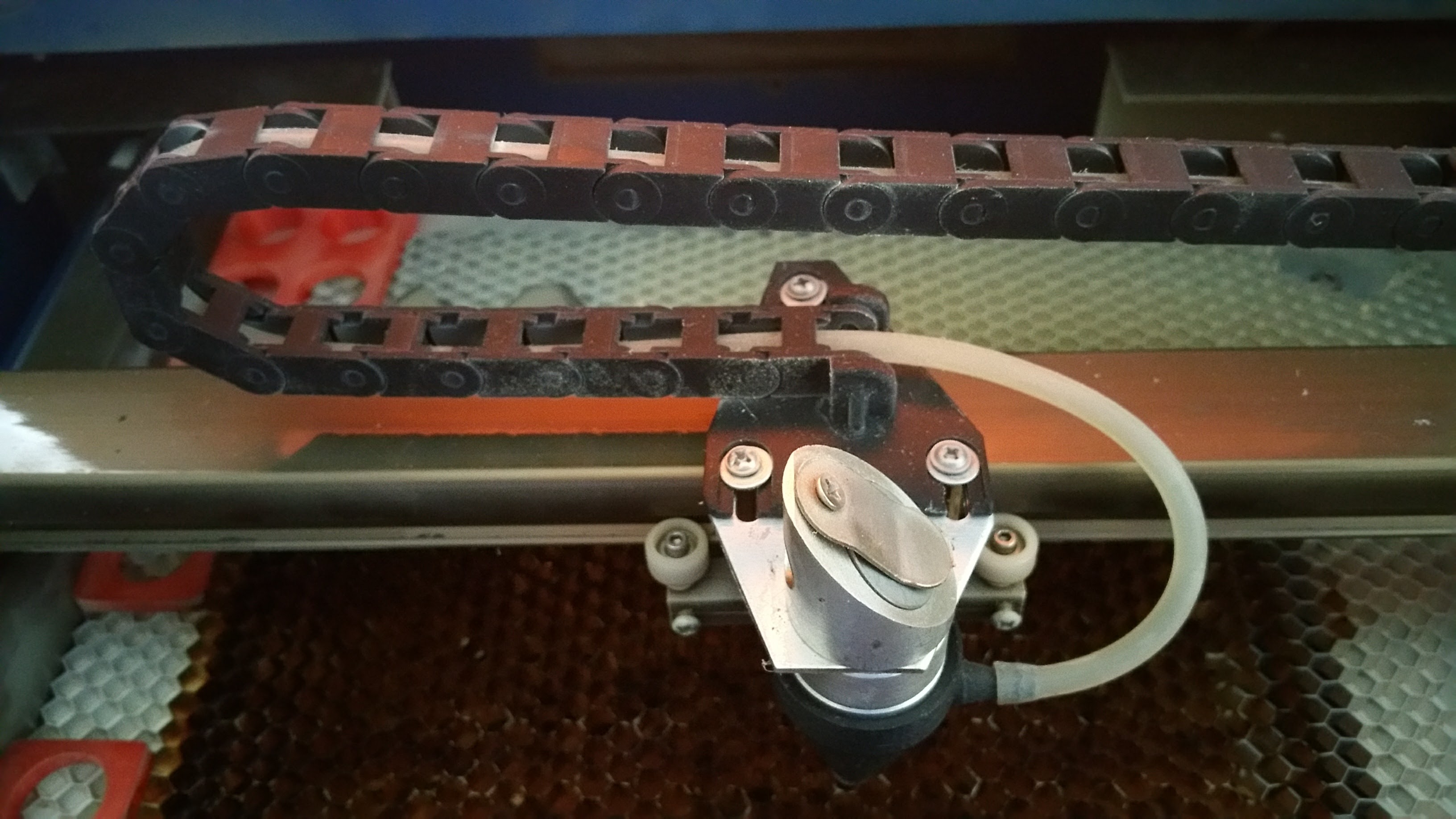

I also use a cable chain that runs my air line and power for my red dots. Works really well.

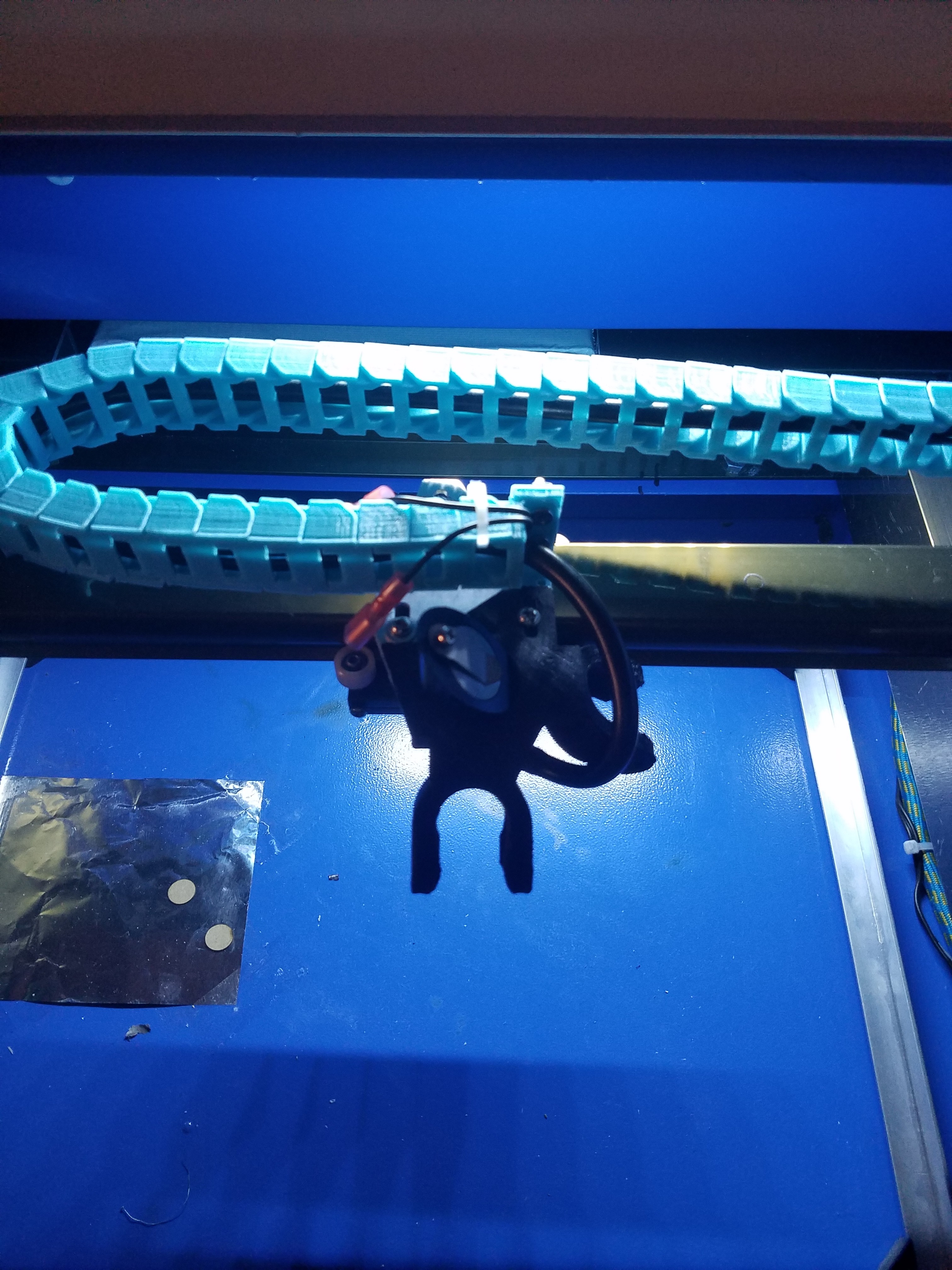

With the pointers installed.
Thanks Kelly. Thats just what Im looking for. I ordered a drag chain from fleabay, so when that comes in Ill give an update.
