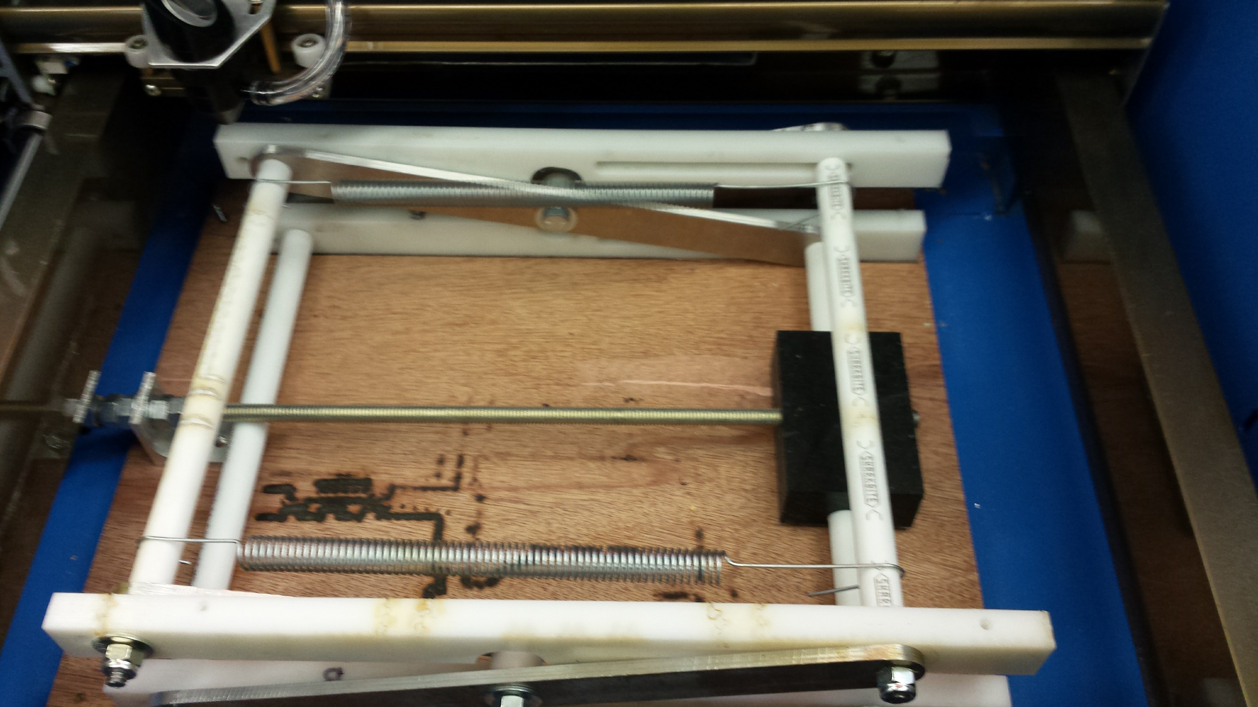

The taps were stripped out. Bad bearings, very cheap. Turns very hard and now I know why it needs so much power. Im actually designing a scissor lift table for my k40
I made my own scissor type lift and I adjust it with a knob. I should have made a double scissor like the one above. I would say mine is accurate to 1/16 inch but the lower it goes the more squishy it gets
That one is pretty nice, but not the z table puctured above…you got pics on yours ?
Yes that one is nice. I made mine because it was the simplest way I could think to make one with the stuff I had. I will try and post a picture.

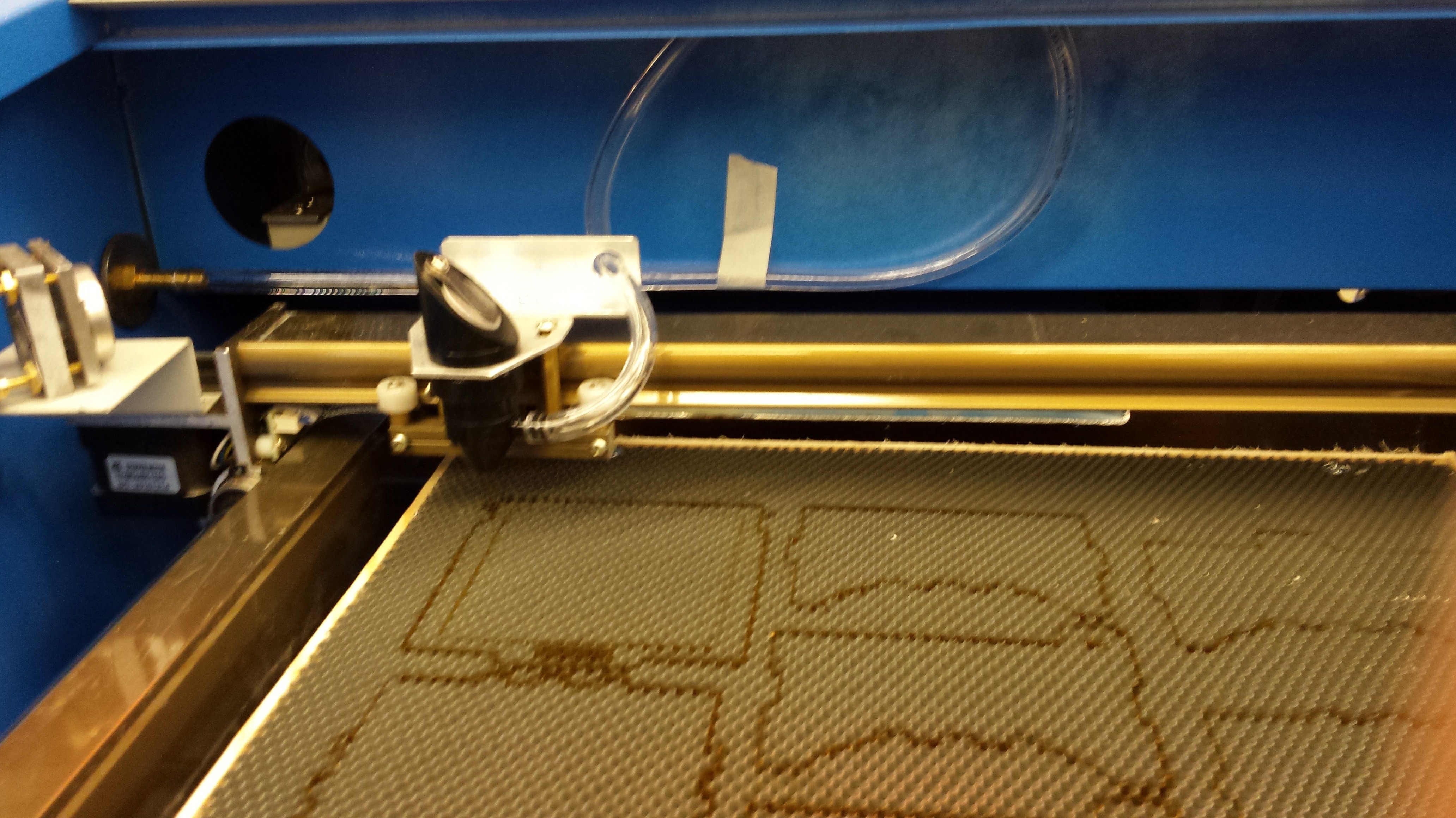

here is a picture of my adjustable table. It is 2.5 inches thick at its lowest setting and gives me 1.5 inches of adjustment. That includes the honeycomb top.
Well done !! Did you add stepper too control height adjust ?
no. there is just a knob connected to the threaded rod on the left side. I thought about having it go through the side of the enclosure but there is plenty of room to adjust it inside the case.
