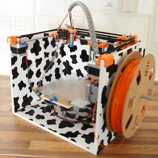

I'm assembling the production Smartrapcores .
I’m assembling the production Smartrapcores . As I need to recognize them easily, I’m playing with deco on the box.
I think this one will be the most easy to name ?
Is it just using the orange spool or are there more on the other sides? Sorry if that’s a stupid question, my knowledge of 3d printers is limited.
actually , only the orange spool. Soon more i hope ? we are working on 2 heads update now we have enough space for that .

How does the enduction z-probe work if you don’t have metal bed ?
@Shachar_Weis I plan on putting metal tape - I have some copper or use duck work’s tape, under the glass - just like the smartcore in picture does
?I use aluminium foil. I’ve found some aluminium tape at the hardware store…under the glass
FWIW, I have this same sensor, aluminum foil works great, it also picks up a heated bed PCB, but it can be tricky, i have once corner that triggers 1mm lower then the rest so I use the foil for uniformity.

haha. Well, this proto was far more class than this one , to be honest :slight_smile: we try to do a full range of quality from this very same model. From very basic and cheap wood model to custom made deco + pi + ldc + wifi + double head , etc. It was the goal from the start.
BTW, Induction sensor with glass and aluminum foil - doesn’t work.
Beg to differ that not all sensors created equal
