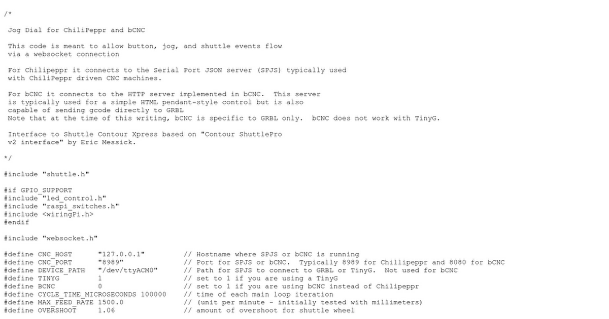

Here is a sample screenshot of what I’m seeing in the terminal when running ./shuttle and turning the dials:
