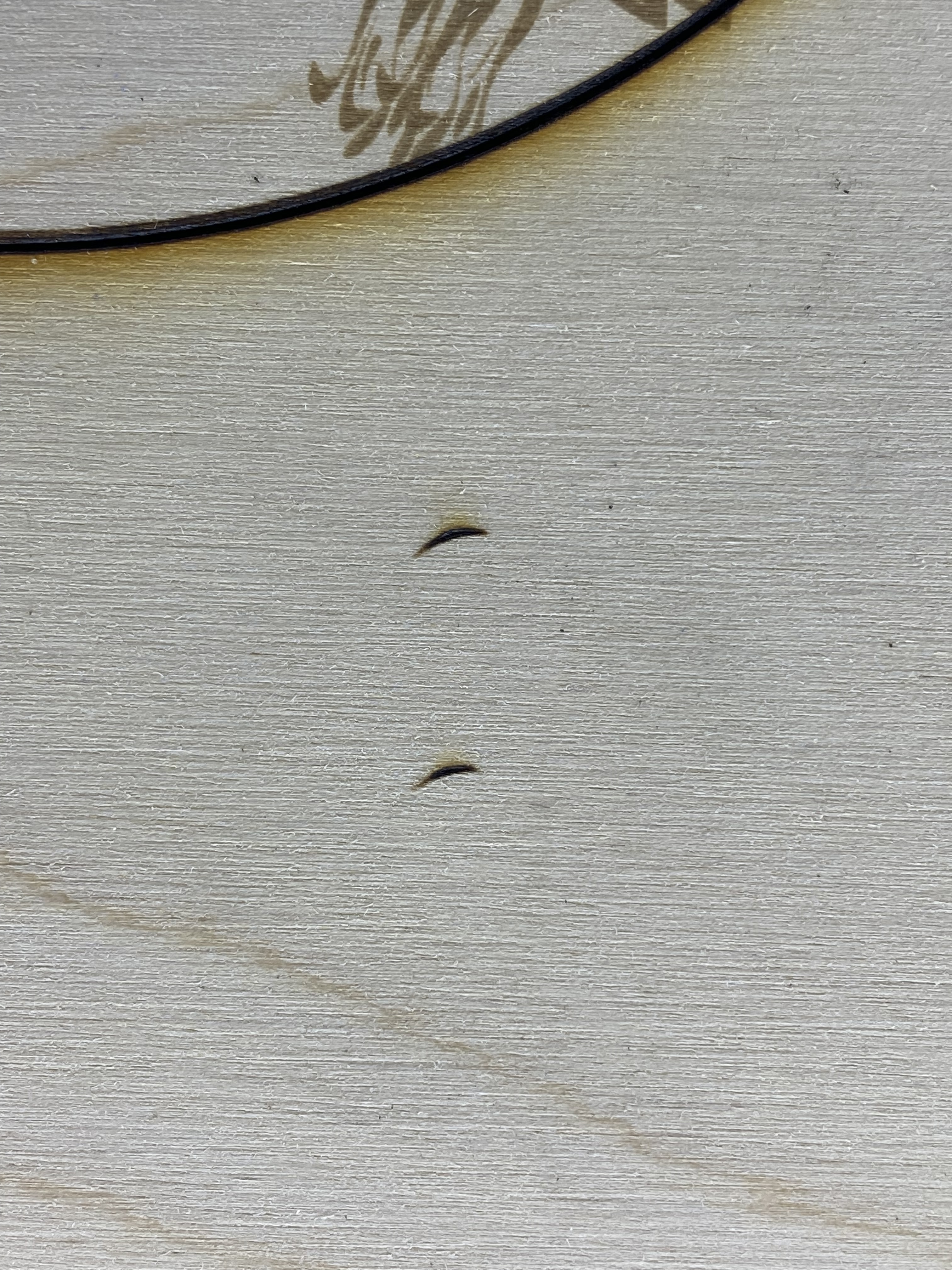

  • Under very high power the laser marks an arc at the table.

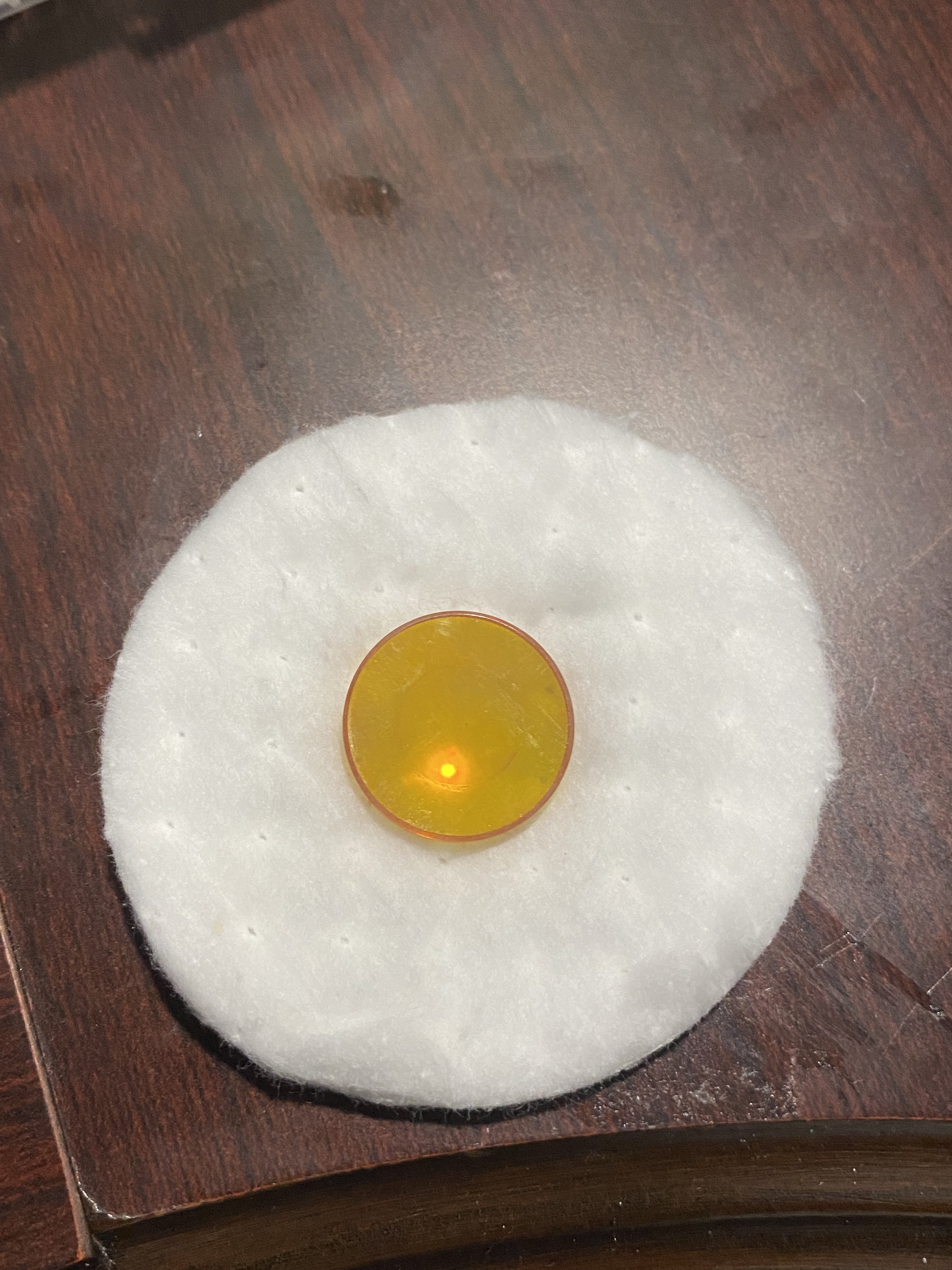

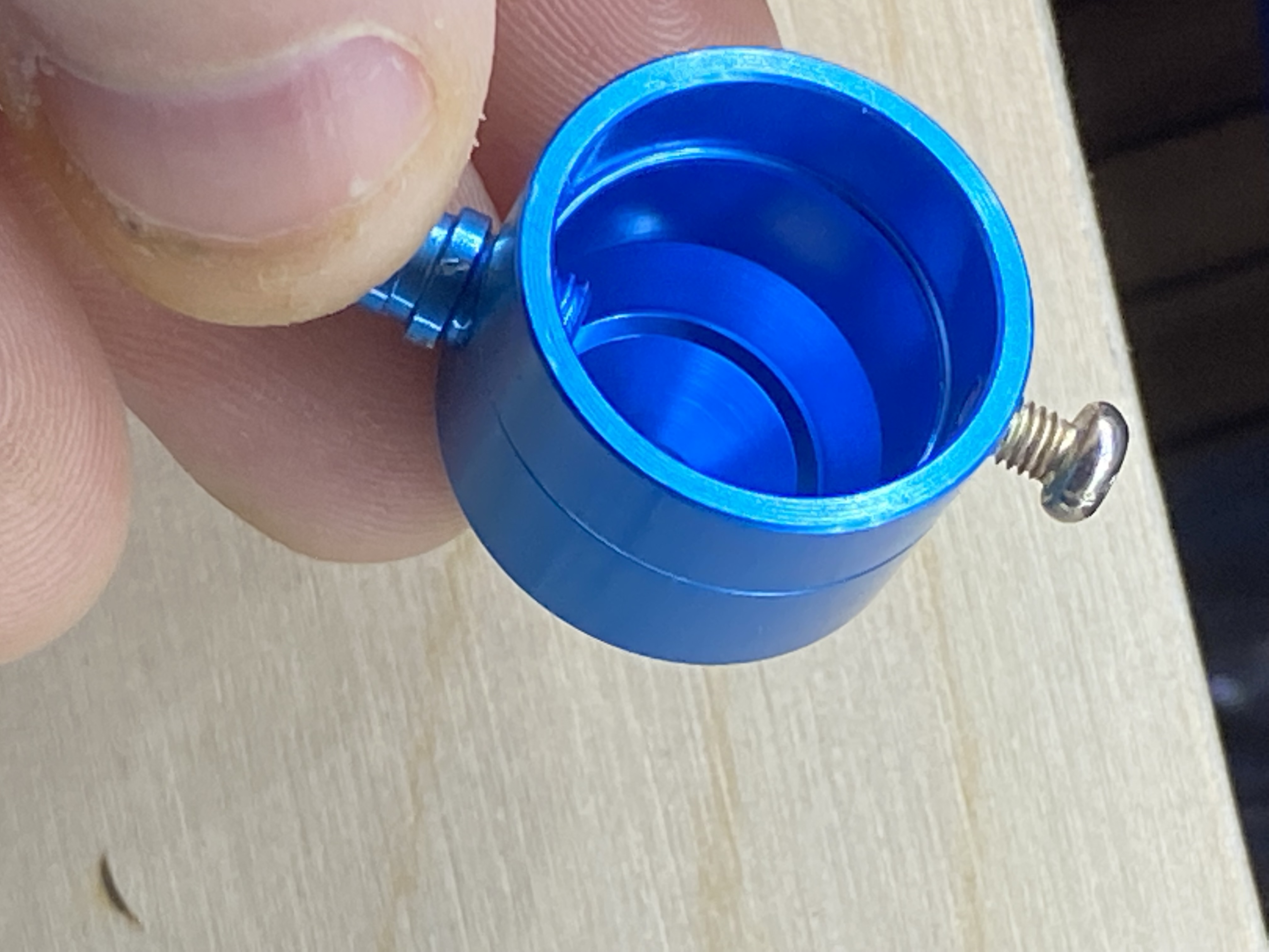

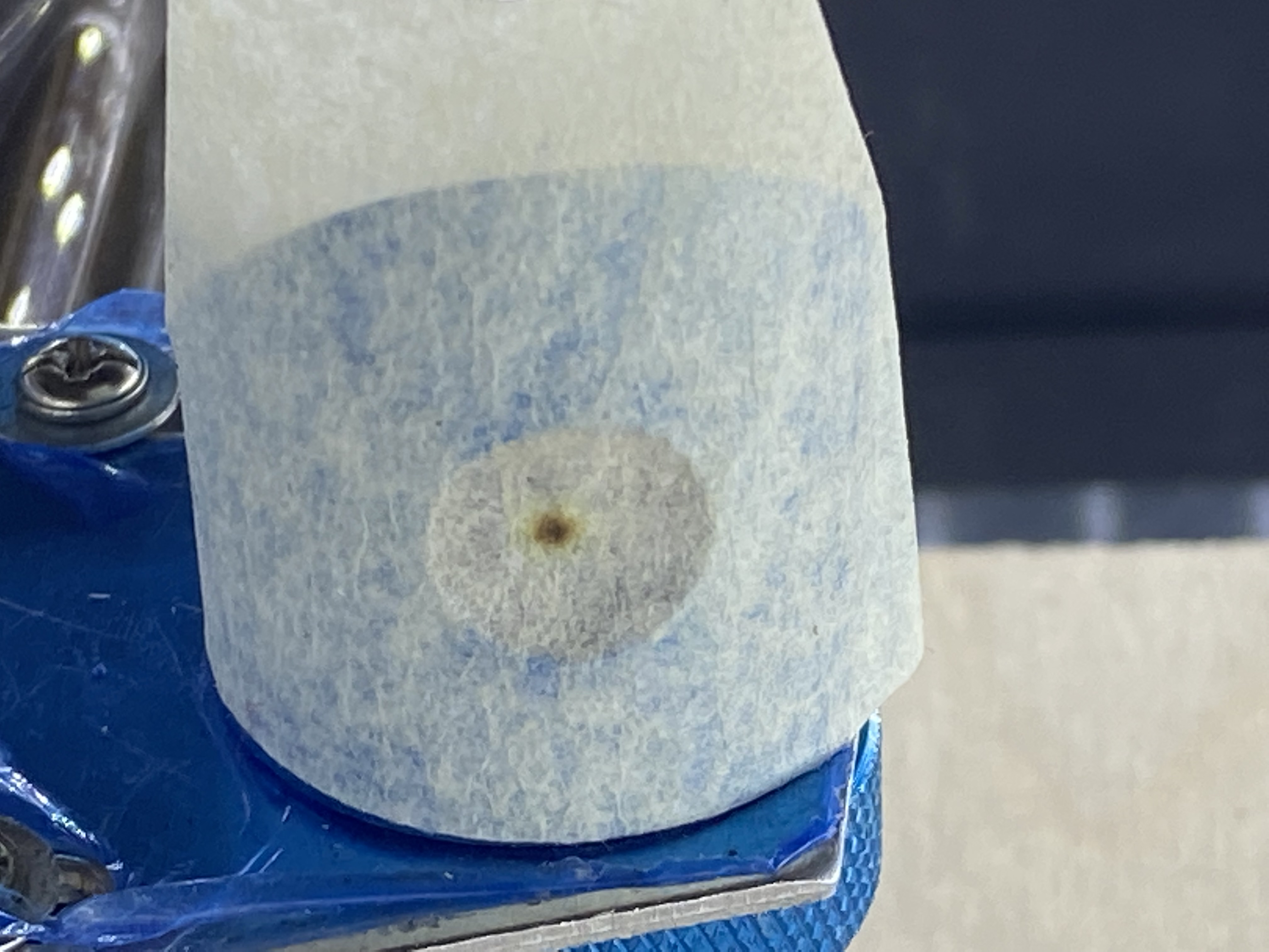

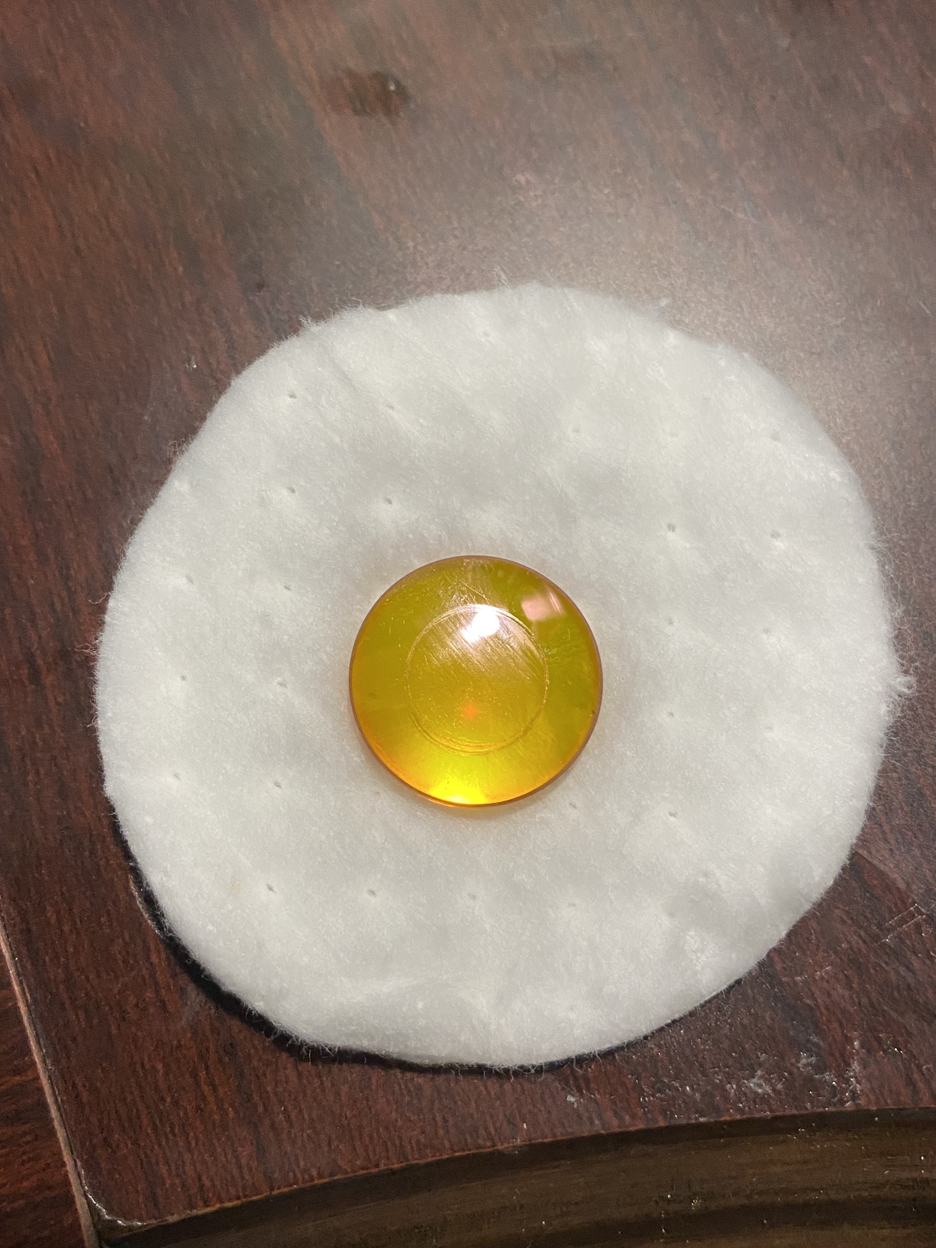

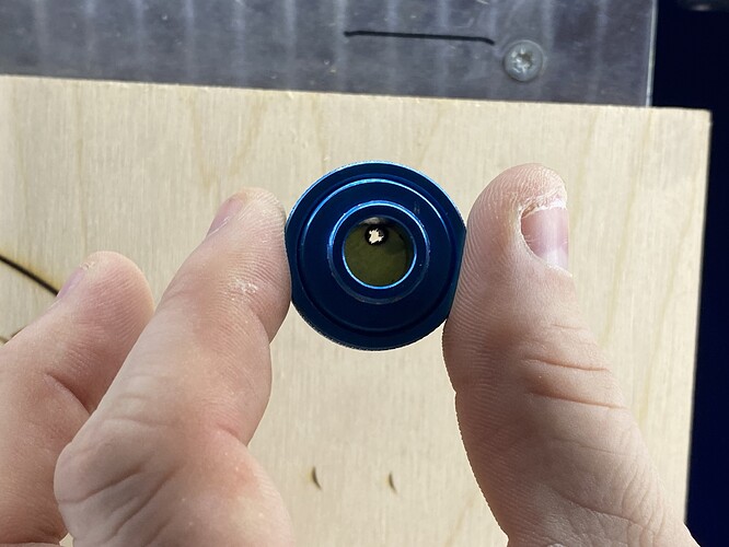

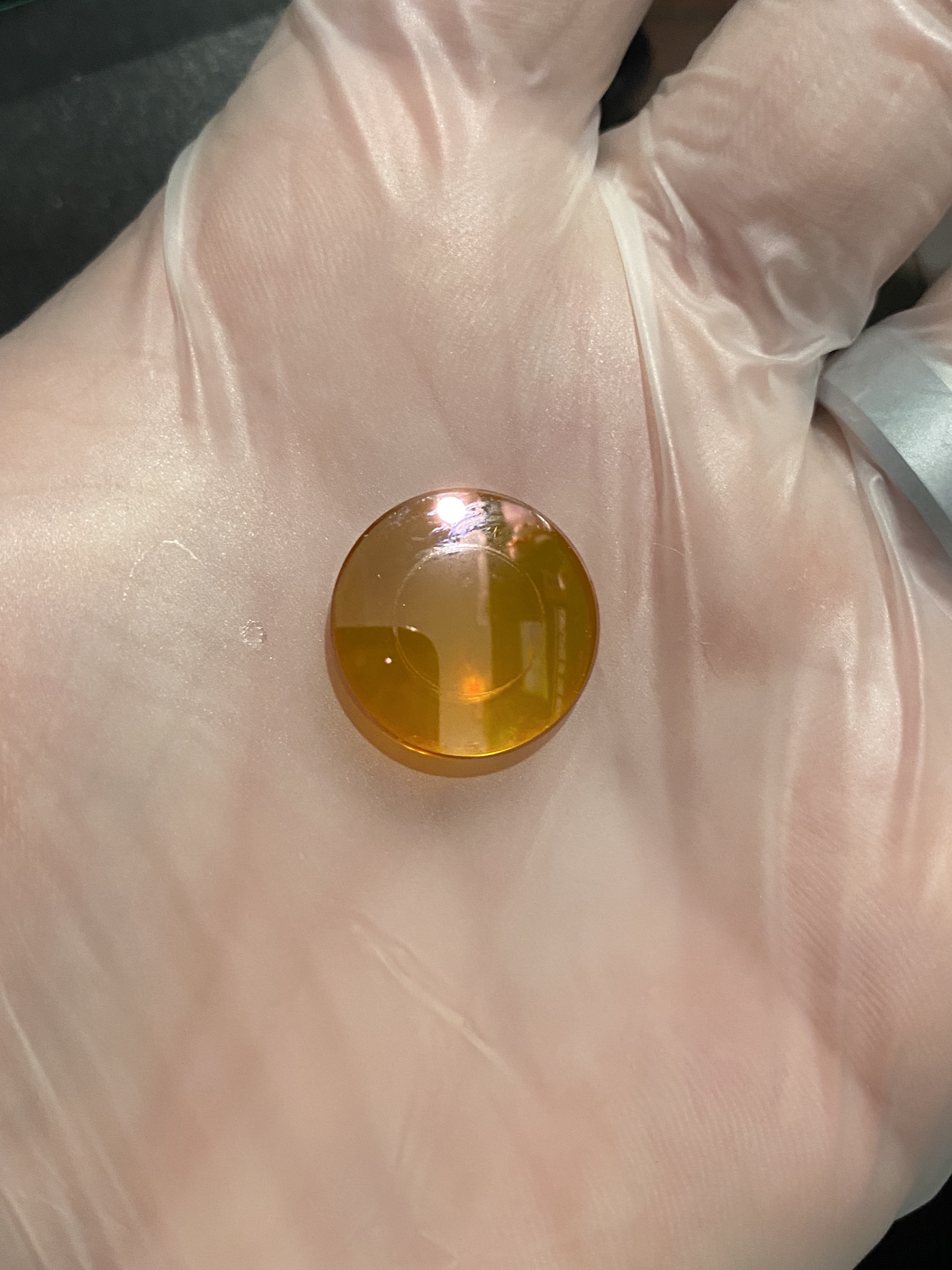

Thanks @donkjr, I just hate that so far my only contribution has been to ask for help :rofl:. I think I have all the pictures you have asked for.
Each of these arcs where from different test fires.
Uploading: IMG_0244.jpg…

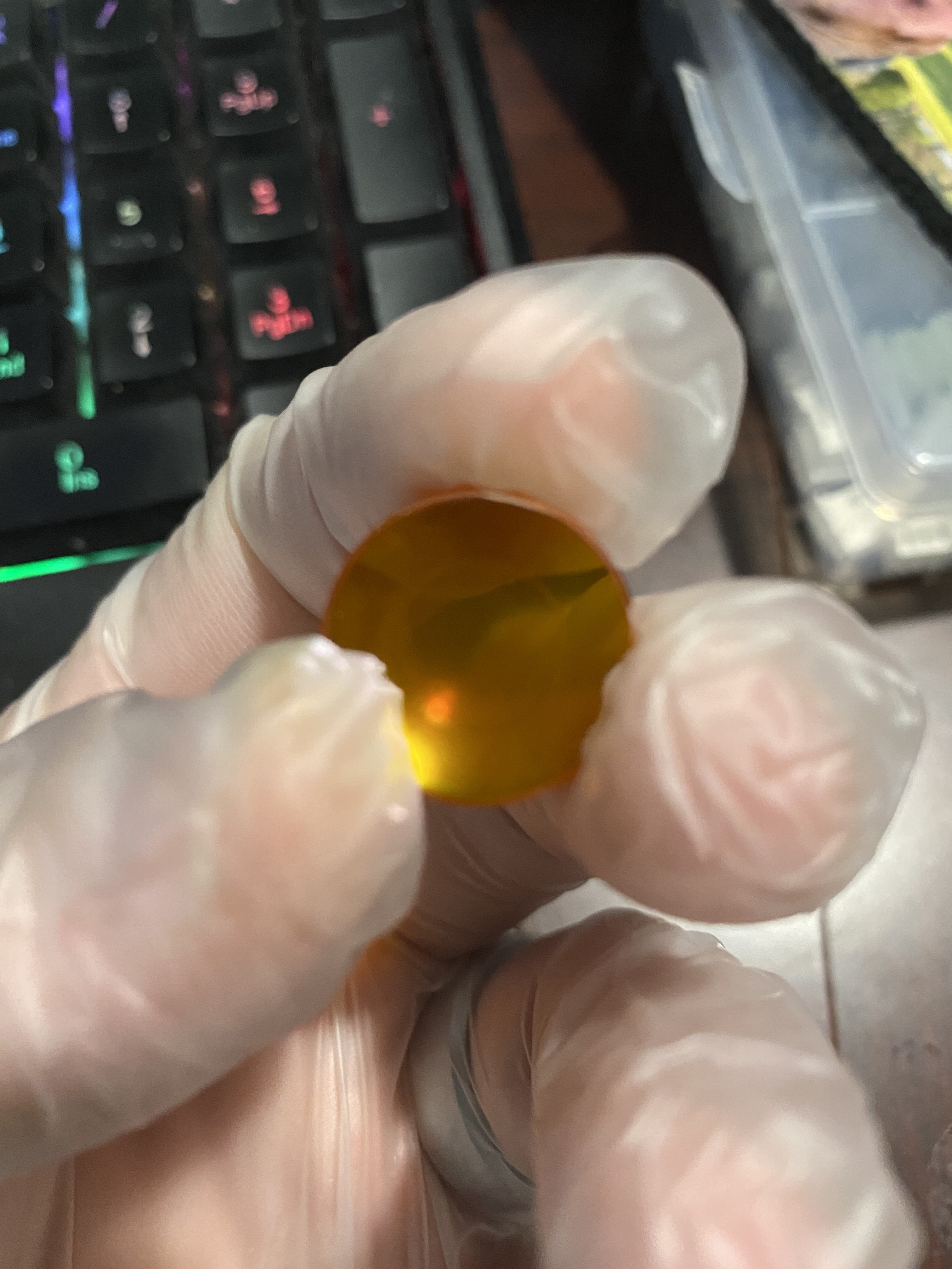

The two pictures with the lens being held in the gloved hand was after a cleaning (anytime I take the lens out I wipe it off) with 91% Iso Alcohol.
Thanks again for your help, let me know if I missed anything you asked for and let me know if you need anything else.

Photo #3: the beam does not look like it is the center of the aperture. Notice that there is a fully formed spot and more power at that point than there is at the surface with the lens installed. This suggests to me the lens is causing a problem.
Photo # 7: I have never seen a meniscus (raised-looking area in the center of the lens) like that on a lens. Is this a stock lens? Is that a mark from the lens mounting? That said it may not be a problem if the beam is exactly in the center. However, if the beam is hitting the edge of that meniscus or mark it would be a problem. The half-moon could be the part of the beam that is clear of that perturbation and get through the aperture.
If I interpreted Photo #3 correctly and since you can’t adjust mirror #3’s angle (part of why I dislike that head) adjust mirror two’s angle to see if you can move the beam into the direct center of the aperture. To see what you are doing you may be able to press the target up against the open aperture to mark (dent) it so that you can see where the beam is hitting relative to the aperture when you remove it.
You may also find something that fits over the objective cylinder as I did with a pill bottle. Tape a target to it slide it on, burn the dot and then remove it to see where it lands.
You also can try rotating mirror #3’s mount to center the beam in the aperature.

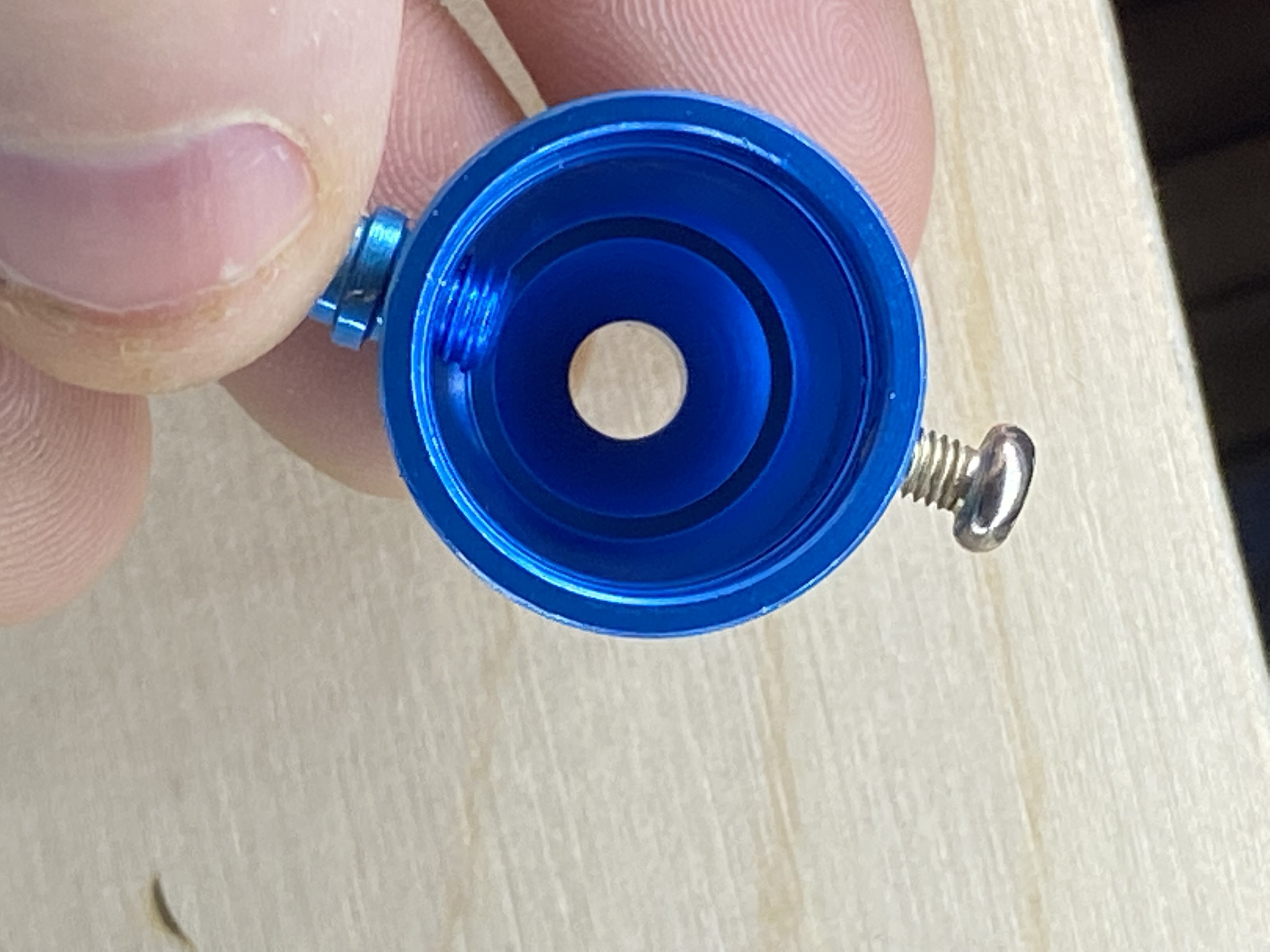

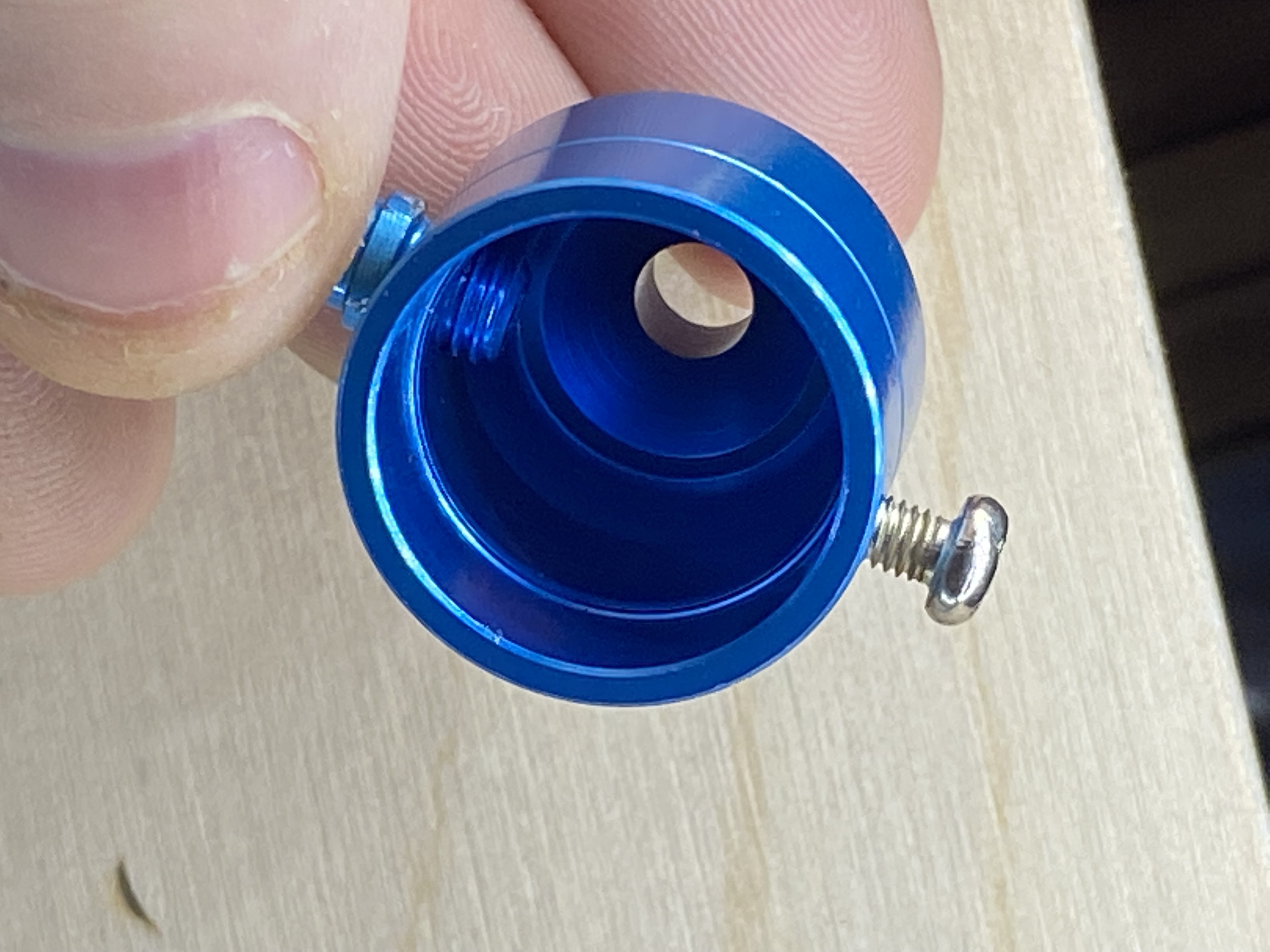

Sorry for the delay. Went back and again reset all mirrors and tried to align them again. Got all the way back to the laser head. Same end result, moved the laser head into the beams path (instead of attempting to bring the beam to the laser head) and it still would not hit the work table. I ended up having to take a drill to the bottom of the laser head (part where the air assist attaches) and drill out the hole. This has seems to have fixed the issue. Not sure why all of a sudden the laser head nozzle got out of alignment. New problem is half way through a project I get the error message in Lightburn that it has lost contact with the control board… Lightburn’s help page says that it could be the USB cable, which I do not use the one it came with, I have a Amazon brand cable. Another issue it stated it could be is a power fluctuation due to a compressor turning on dining the power to the control board. I don’t think it is this as I have upgraded to a cohesion control board and it has its own power supply separate to the power from the machine. Anyways thanks for the help again guys!
Make sure the laser head is square with the work area. It sounds like the beam is entering the head and exiting at an angle.
What @HalfNormal said. It still seems that your beam is going through the head at an angle vs perpendicular to the work surface. But I am glad you have it working. It not uncommon to knock mirrors out of adjustment. My guess is you beam entering the head is ramping upward/downward causing the beam to traverse the head at an angle after it is folded.
