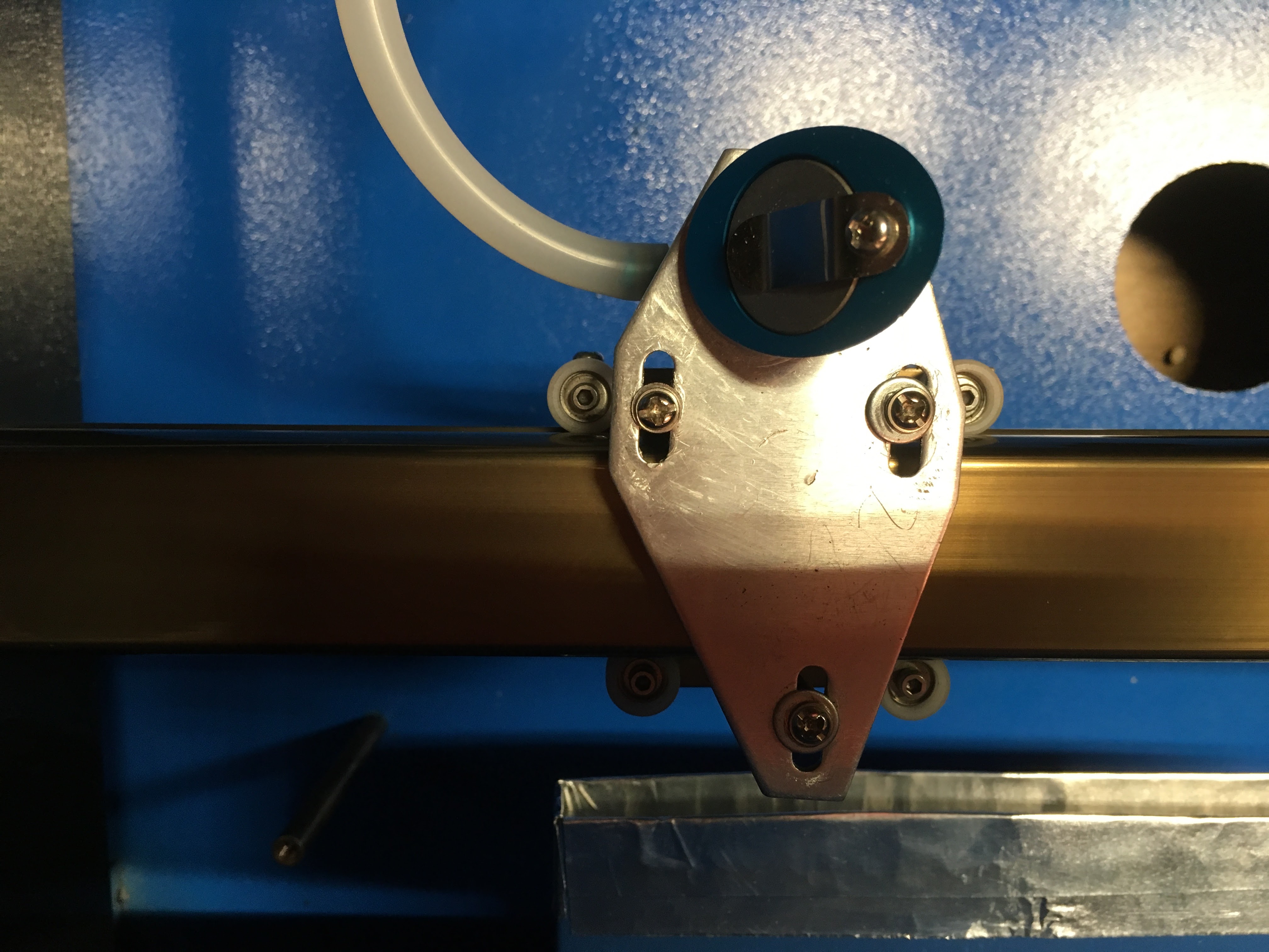

Two things, the LO head sets the lense at a different height so your focal point (higher) may be different than with the stock head.
The other thing and this had me pulling my hair out…
The LO head has a smaller diameter shaft than the hole in the mounting plate. I loosened the head mounting nut, moved the head around in different positions and tested the laser (making sure the hole is parallel and facing the second mirror) until I got a consistent burn, then tightened the head up.
On my setup there were huge differences in beam intensity, based on where the LO head was positioned in the mount.
If you look in the picture I was able to move it around a few mm in each direction, I think a bit to the right and back was the sweet spot for me.
