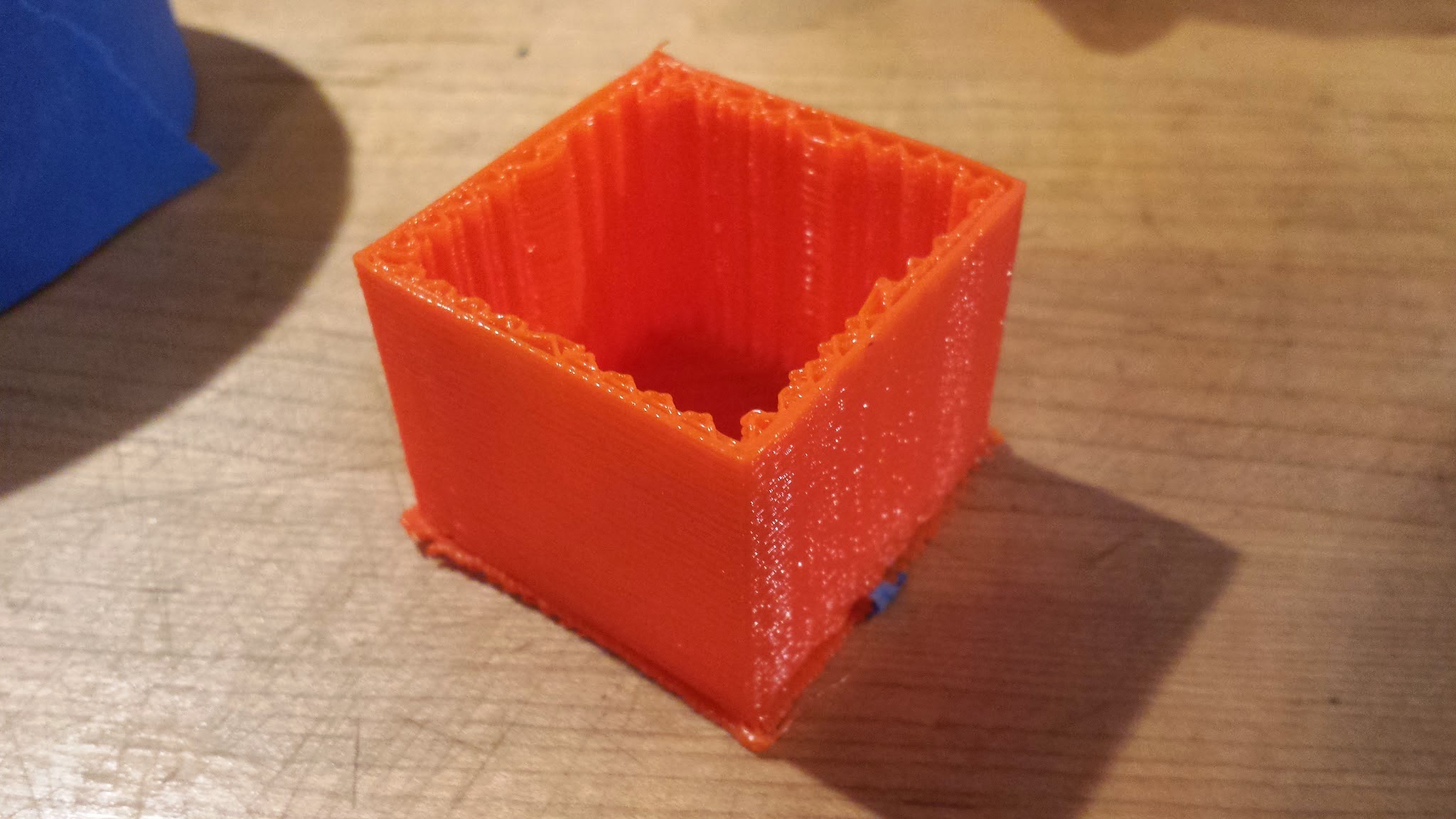

I’m back to making plastic (calibrations are sticking), and plan on repurposing the printer parts for an ingentis build…but before I do that, I’ve got to get it dialed in enough to print the parts!
So my 40mm test cube is actually pretty close-ish, the average is about 40.75 in one direction and 39.7 in the other…its a little Wavy, and the Z-height is waaay off - 32.56 INCLUDING the raft.
Do I just scale Z in the slicer?

@Mike_Miller Move your Z 40mm (all three carriages move as one), then measure on the pillar how much did the carriage actually move. It should be exactly 40mm as well. Then change the DEFAULT_STEPS_PER_UNIT until you get that 40mm. Then your X/Y scale will probably be way off, to fix that you’ll have to change DELTA_DIAGONAL_ROD. (look here - http://minow.blogspot.ca/)
thaaat makes sense. And pisses me off a little. :slight_smile: The phrase ‘then go back and recalibrate everything else’ sure does seem to occur a lot.
Recalibrate is 3D printing’s middle name.
@Shachar_Weis thanks for the clue, printer is very close to dialed in after your advice.
