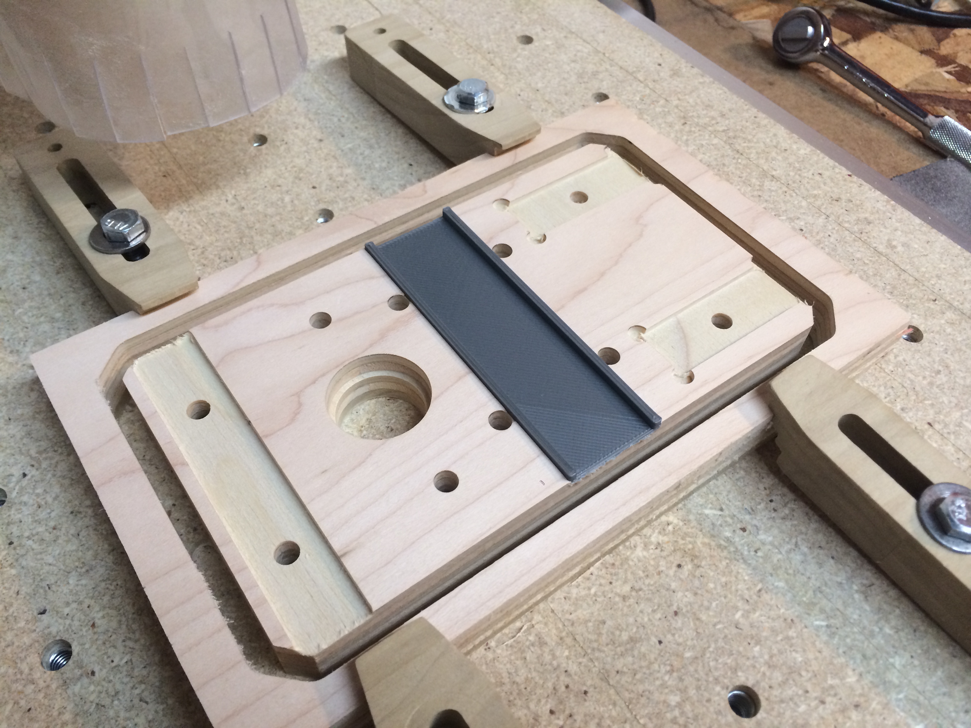

I'm back with some more progress on this CNC machine,
I’m back with some more progress on this CNC machine, theres more photos on my page if you want to check them out. The project is going way to smoothly, which worries me. ha ha
Wow! Those are awesome hold downs!! Did u buy em or made em??
Thank you! I promised someone I’d put the design files up online. I’ll let ya know when they’re up. I made a tray/holder for them too. You can check my “Make” photo album
@Tyler_Harney I know! I sow them before! Undo great work man :wink: can’t wait to see the old CNC come back to life… The files would be great! Thanks again Tyler!
those are some large dogbones! You sure you put the radius and not the diameter in there?
Lol @MoserLabs it took me a few to figure out what you were saying.
I was cutting with a 1/4" endmill so I just put in a drill sequence for the corners. Didn’t want to take the time out to switch to an 1/8" endmill.
What software ya use to design and cut?
I use either Illustrator or Solidworks. Then use CamBam as my Cam program.
Ahhh. I use Vectric Aspire so it’s easier. You could use the same tool, just put the drill half the distance in.
