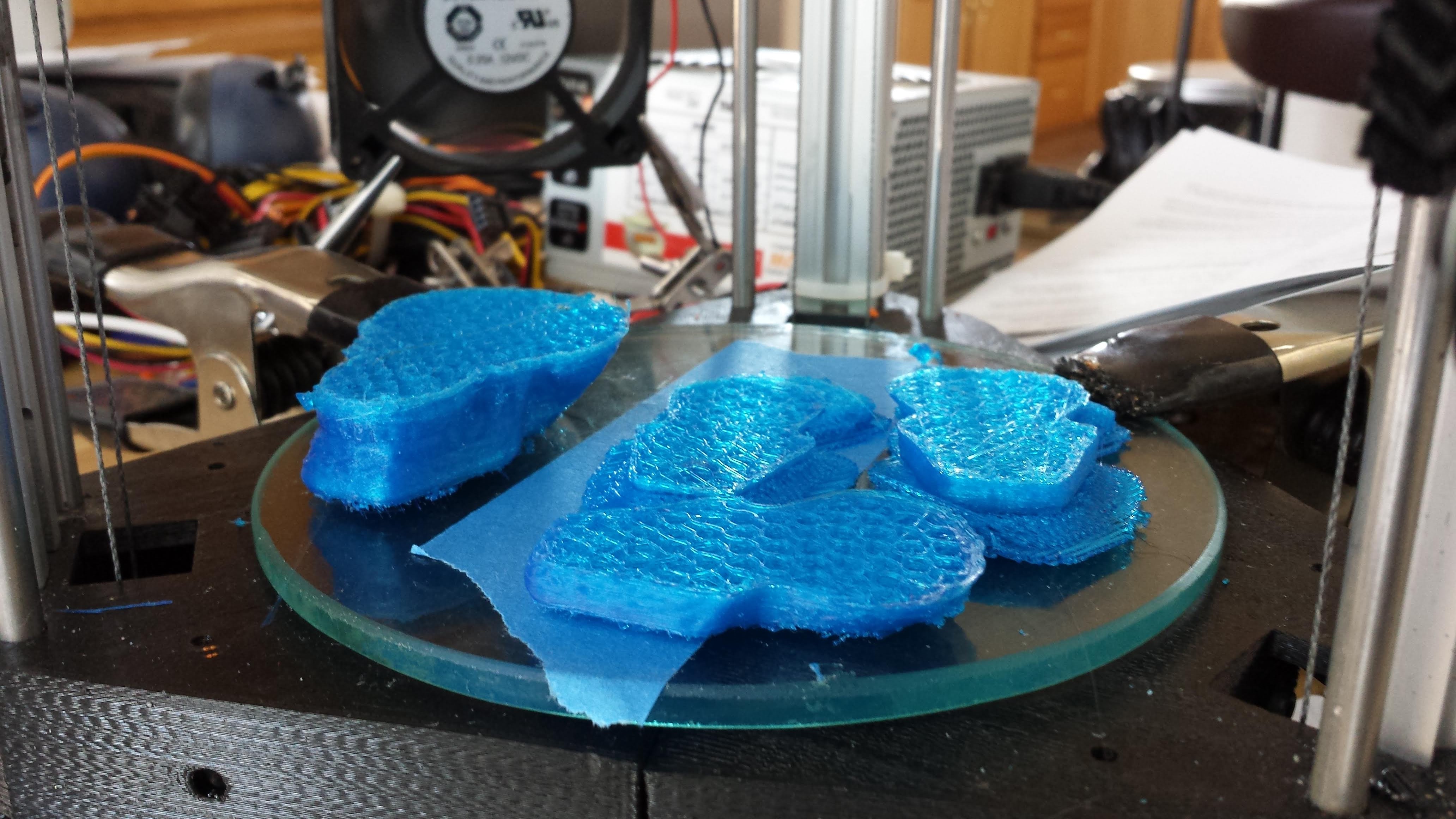

I’m certain someone else has solved this. Notice a pattern or trend in my prints?
PLA, 190, 200, and 205 degrees, varying brands of PLA, Varying speeds and feeds. I’m thinking it’s something to do with either the tension on the hobbed bolt, or a restriction that’s causing the filament to strip on the hobbed bolt, causing it to grind a notch.

@Mike_Miller , two things cause this issue with PLA prints that fail repeatedly after a set time. The first is your hotend barrel not getting enough active cooling, like a 40mm fan blowing across the peek section. This is the dreaded PLA plug! Cooling fan on the barrel is a must for most if not every hotend. The 2nd issue that can cause this fail pattern is, if your extruder motor gets hot enough and transfers the heat to the Hobbes drive roller, it can soften the PLA and cause it to strip out easier, leading to loss of extrusion. I bet one of those two fixes you up real good :slight_smile:

Im beginning to think under extrusion is causing the PLA to heat up and clog as a couple of the failures have the bowden mooshing the filament up just after the pinch wheel.
It’s an e3d head, the fan is on, the temps are about 205, the extruder motor is actively cooled, and just before it fails, you can see the extrusion rate fall off.
That’s total sign of the Pla plug in the hotend. Is the fan on the barrel on full blast, and as low as possible on the fins?
Pretty sure, but I’ll look closer (and, sigh, wire it to constant on.
