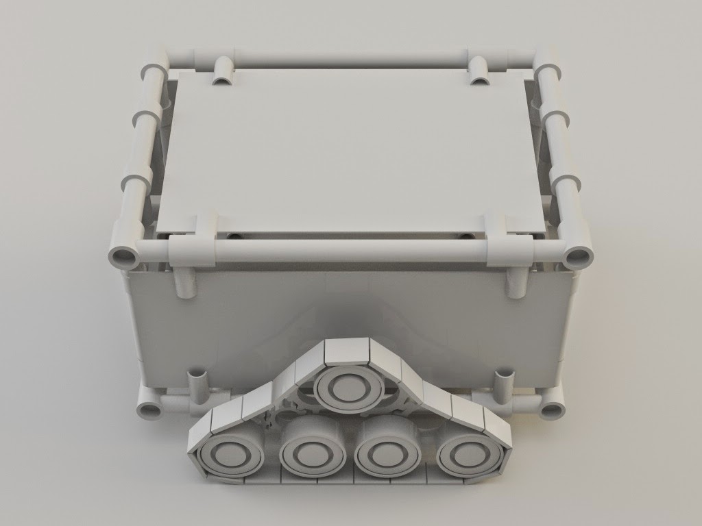

I'm developing a space exploration vehicle called "Evo Explorer" as part of my DsgnStorm
I’m developing a space exploration vehicle called “Evo Explorer” as part of my DsgnStorm technology series (Project Links attached). This series focuses on open hardware projects that can be freely modified and developed further by interested enthusiasts.
Anyway I would like to get some feedback on what type of 3D printer and materials you would recommend with a budget of up to $10k?
(Hoping to raise the funds via Kickstarter)
Also note that the design is relatively simple in construction, essentially most of the build is comprised on panels, basic fixtures and rods.
More about the project: http://dsgnstorm.com/project/evo-explorer/
Does it have enough ground clearance and approach/departure angles to conquer rough terrain? It looks like it’d get stuck against a small rock from either side.
@Ryan_Gerrish This render is an older design as the wheel system has since been redesigned. I do agree though.
One of the primary reasons for creating these prototypes is so that anyone can create and test a Rover at home. These user experiments can then feed into revisions and so on.
I should also add that the Rover attaches multiple cargo vessels behind it (similar to a train) so it’s not just the 1 set of wheels on the ground. The render is just a cargo vessel that would store some equipment.
Nice design. I always wonder about tracked vehicles in Lunar or Martian environment because of the very abrasive qualities of the regolith. I am not sure it is possible to buiild a tracked vehicle that will be able to stand that sort of grinding. Do you have any tricks built into this device to deal with that?
