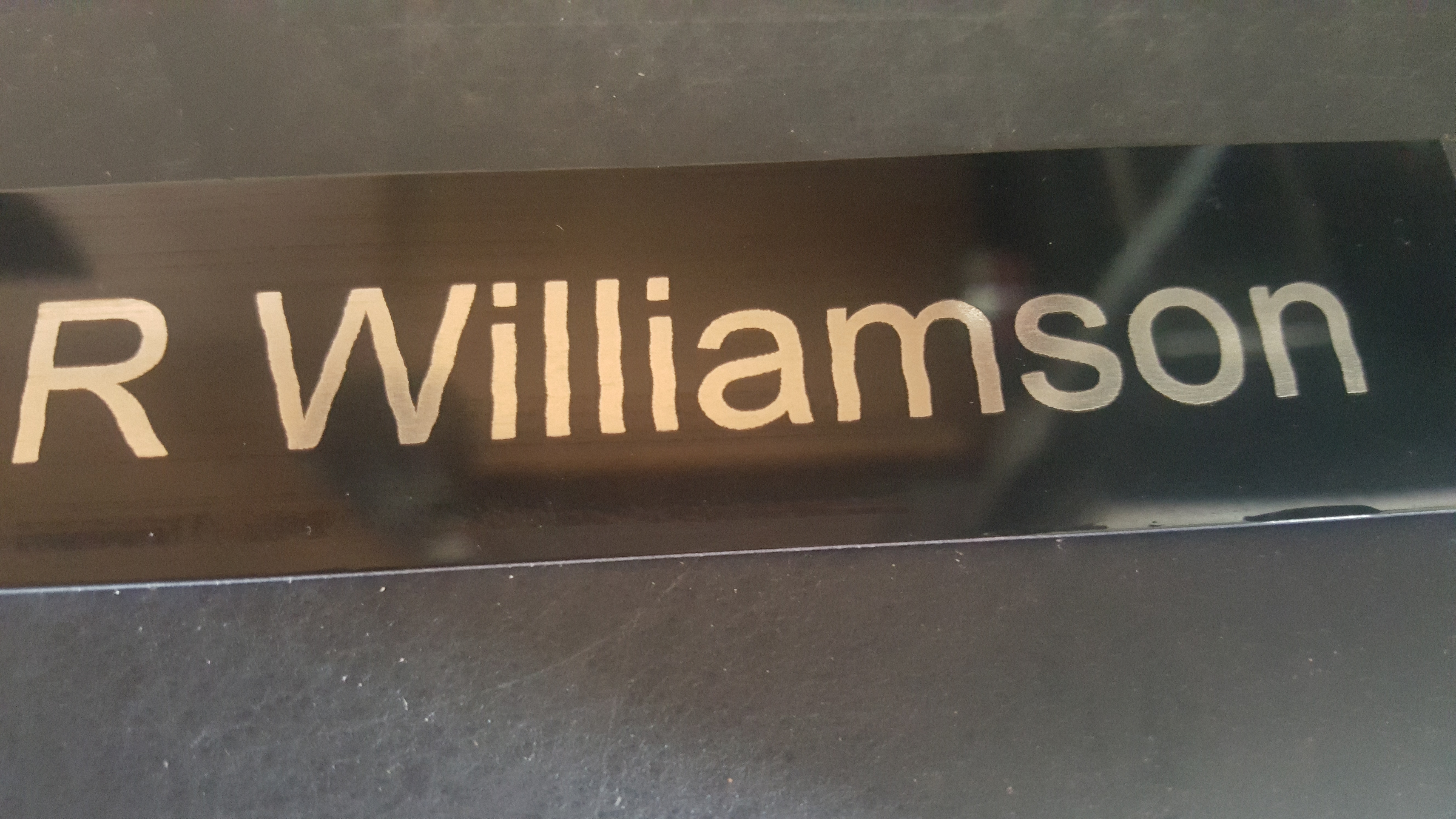

I’m doing a few test runs on this new K40 i got, but my text is engraving wavy…see pic.
Anyone have any ideas why this could be happening?
Tried a different font and it is better except the L’s??? Same size plate, same position on the table

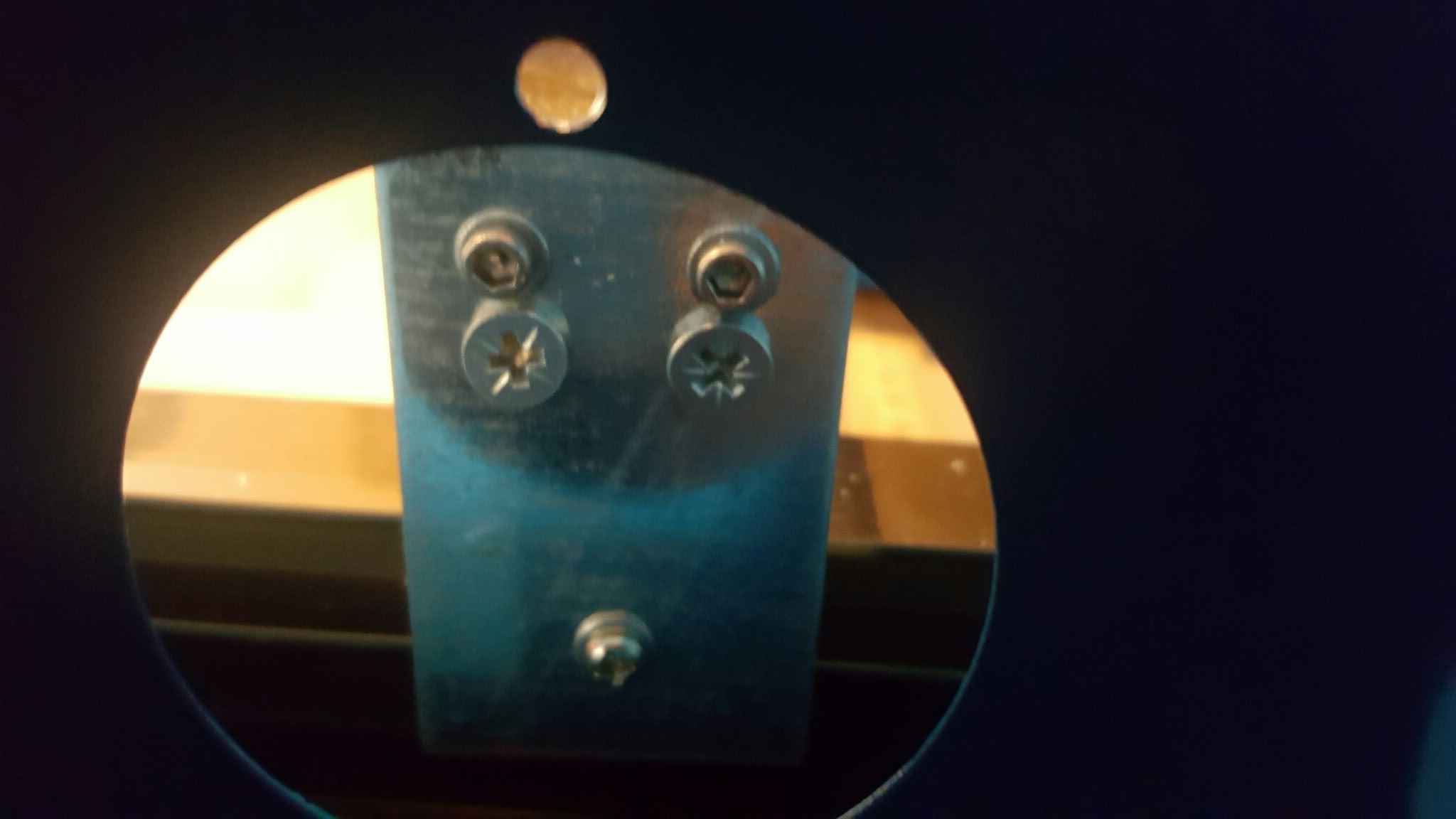

not that I know of, I just followed the x belt and you can see where the idler is attached by screws which pull the idler in when you tighten the screws
@Wolfmanjm would it happen to be any of these? On the right side from inside the large hole
I think it was one or two of those
@Wolfmanjm thank you sir, I appreciate your guidance.
For the record it was the 2 phillips head screws on my machine…in case some has the same question down the line

if it isn’t loose belts, then another one came to mind… I know that if the axis are not 100% perpendicular to the incoming laser path, then as the axis move the beam does change its position. I think Don has mentioned this. so maybe the wobble is due to the beam moving slightly as it exits the final mirror?

@Abe_Fouhy yes, tightening the 2 phillips head screws seemed to resolve the problem
