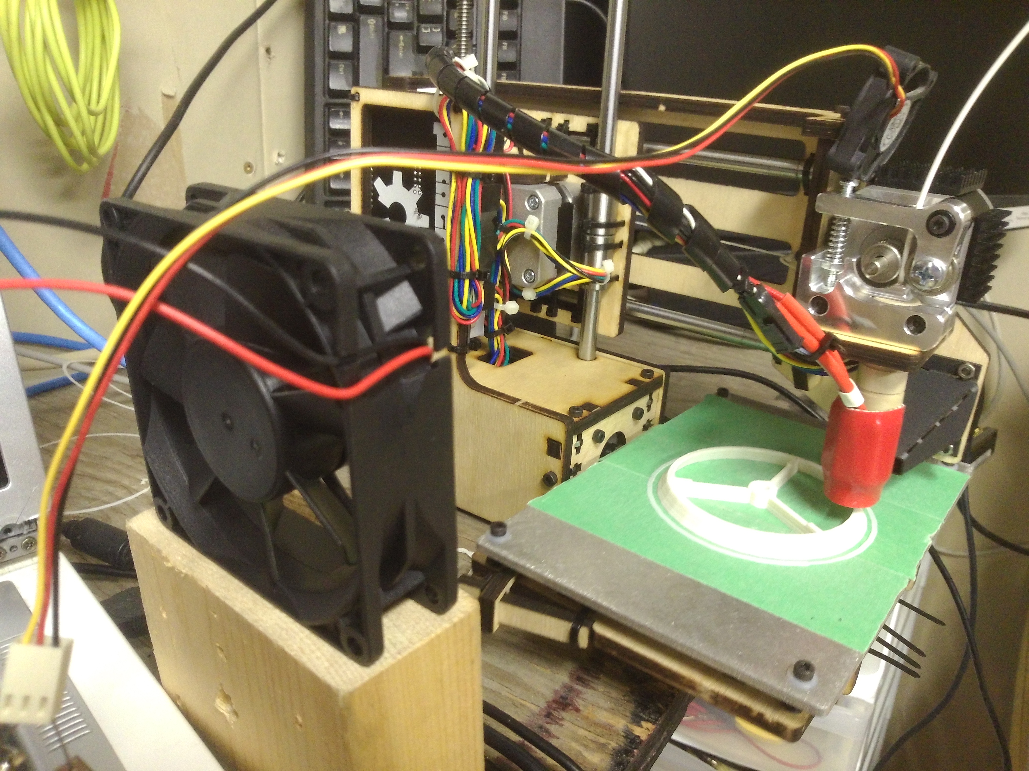

I'm doing some 1 hour prints and to prevent the extruder from stalling/skipping I
I’m doing some 1 hour prints and to prevent the extruder from stalling/skipping I added the big fan to blow at the aluminum. 1/2 way into the 3rd print it jams up! I cannot for love or money pull the filament back out.
Cranked the head temp up 10 degrees, turned off the fans and after a few minutes I was able to feed filament again.
The big fan has been retired. I’m trying the little fan - precariously propped between the top heatsink and the wood frame…
Once I’m done making these Stevenson screen rings (I’m almost out of white filament), I’m going to print a proper fan holder.
Well scratch that - it just jammed again… Heating to 210 (normally at 200) and waiting for it all to melt and start flowing again.
What is the likelihood that I need to run the heater hotter? My problem seems to be the hot end gets plugged up and near the top it cools off and jams.
