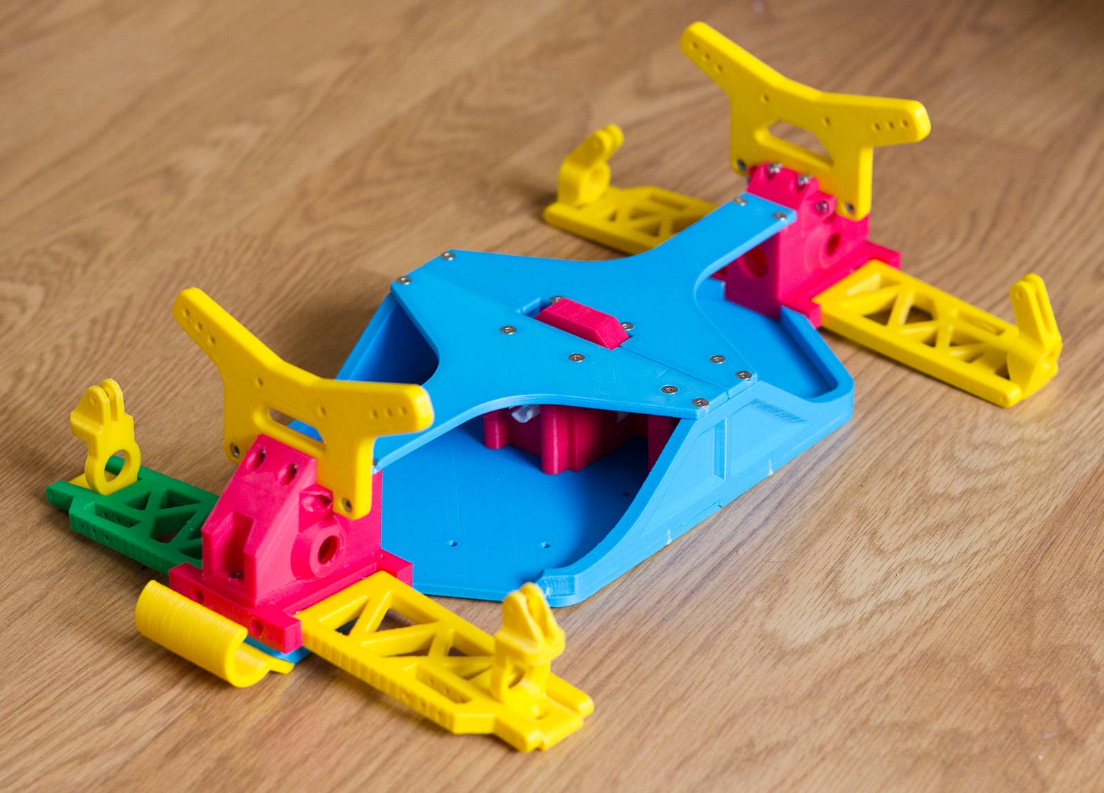

I’m done printing the large parts. Looking good so far
No more yellow left for te last wishbone?
Very nice work
Wow, that’s looking awesome.
