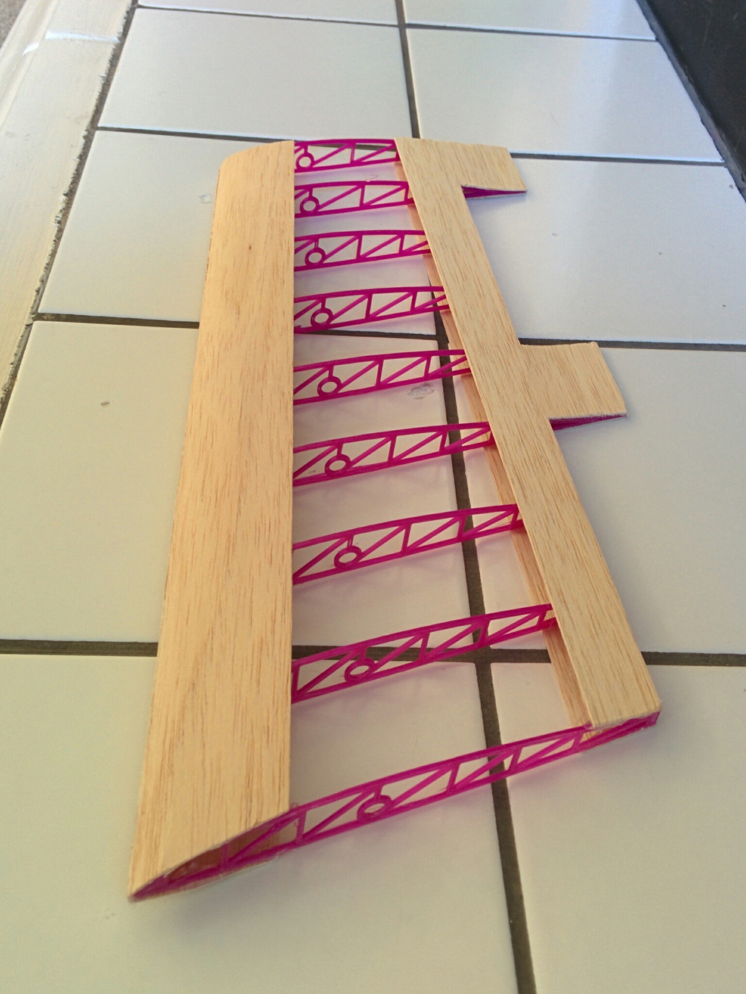

I'm experimenting with using my 3d printer to build a mostly 3d printed airframe.
I’m experimenting with using my 3d printer to build a mostly 3d printed airframe. This is a test for a wing. Figured some here would like this.

This is very intersting what glue are you using?
What are the little feet in the second picture for?
The feet ensure each of the wing’s ribs are at the correct angle with the horizontal plane (floor). It just makes sure everything is lined up right before I glue them to the spar. I clip off the feet with small clippers.
Thick Zap-a-Gap for the plastic. The balsa was glued with hot glue just cause I wanted to produce a quick mock-up. What a mess, I’m going to keep using Zap-A-Gap until I find a better alternative. I’m used to using epoxy for wood planes, but it doesn’t adhere well to PLA.
