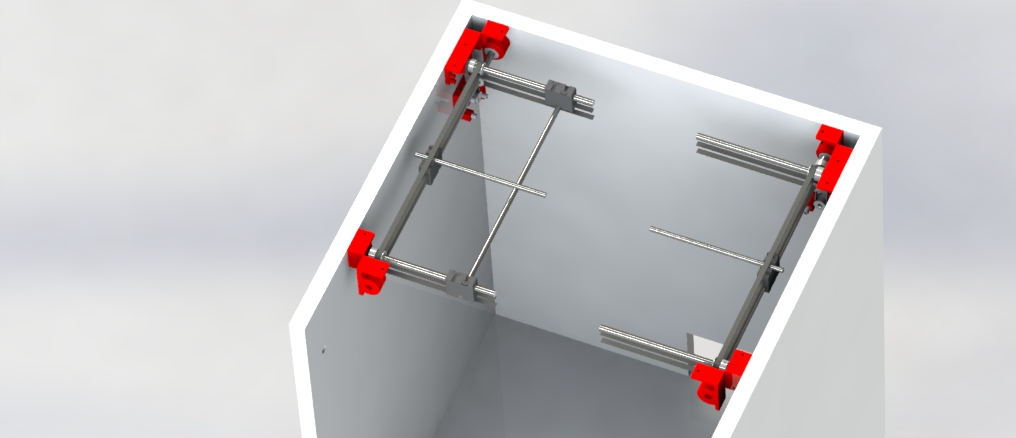

Thanks for all the input! The Eustathios looks really good! And it fits my core xy frame perfectly!! Sure i will need to make som adjustments to adapt it fore a “box” frame but that shouldn’t be much problem…
This is the fram that im re-using. will keep the z axis to.
Thanks for the Eustathios tip. This design looks really easy to adapt.
Planning on combining the two corner mounts and make them line upp to the top edge of the box to make it easy to square up.
Box version will be done soon!

I m very interested by a Box frame version :slight_smile:

Oliver i will upload it to the community upgrades when im done.
